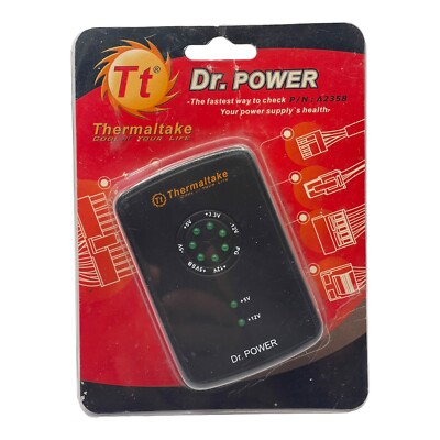

Do you have a Thermaltake Dr. Power tester?
I found that these PS fail under load after they heat up.

I don't have one of those. I was thinking the same thing. And that maybe since it's so old even if it just has a hiccup that would cause the issue. Is this something I should Google and look into purchasing or would there be a better route to go?
If you own the game or games with these power supplies, it's a tool you need. I have one from working on Big Buck Hunter and Rockin Bowl-o-Rama (aka - The Money Pit). I use it for working on older PCs as well when I have a need to do that.

Oh man I had a rockin bowl o rama and never had a single problem with it, ha ha i heard people always talking about it having issues though. what a cool looking game that thing was. Anywho ok I think Ill pick one up then, because I mess with a lot of the games you are talking about for sure. Can I just pick up one of these guys:
or
amazon one seems a bit nicer, but I know sometimes old and simple are the better way to go?

Get the Amazon one. The cheaper one just shows you if they are in range, the Amazon one shows you where you are at.
