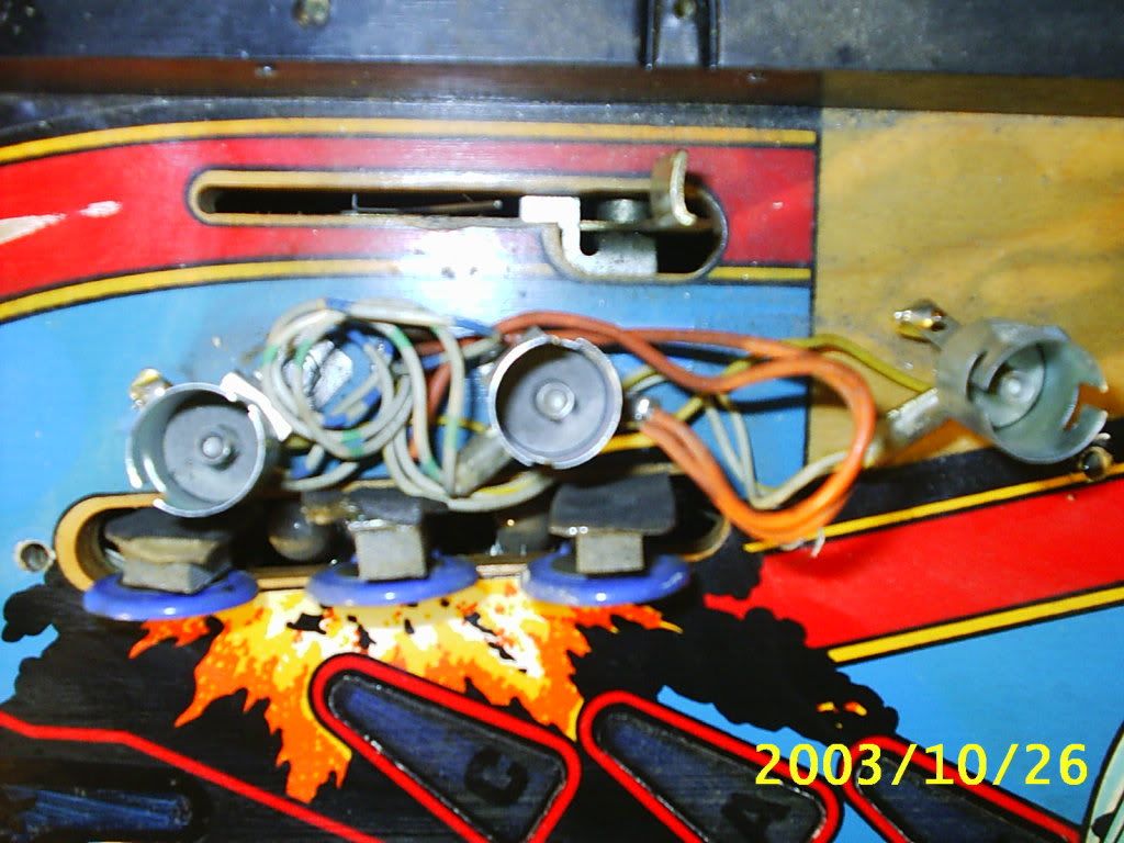

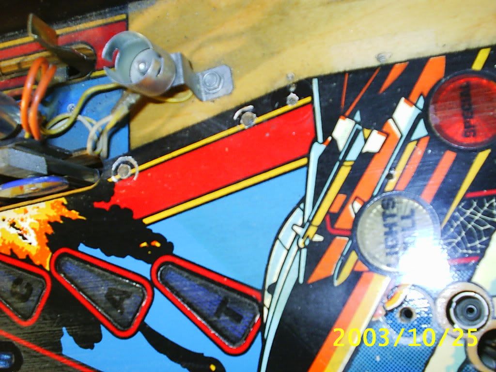

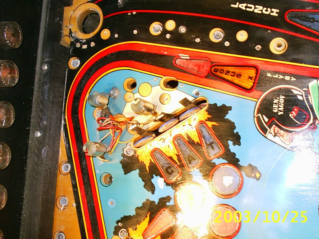

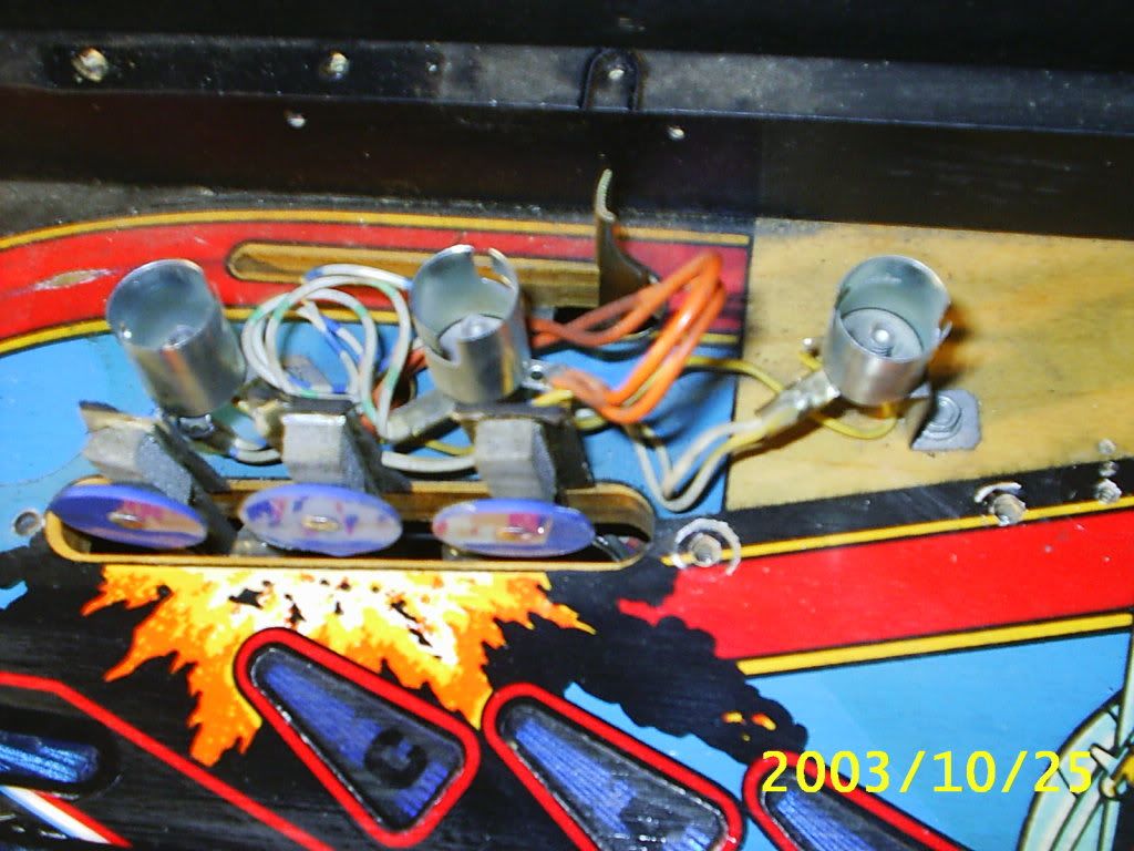

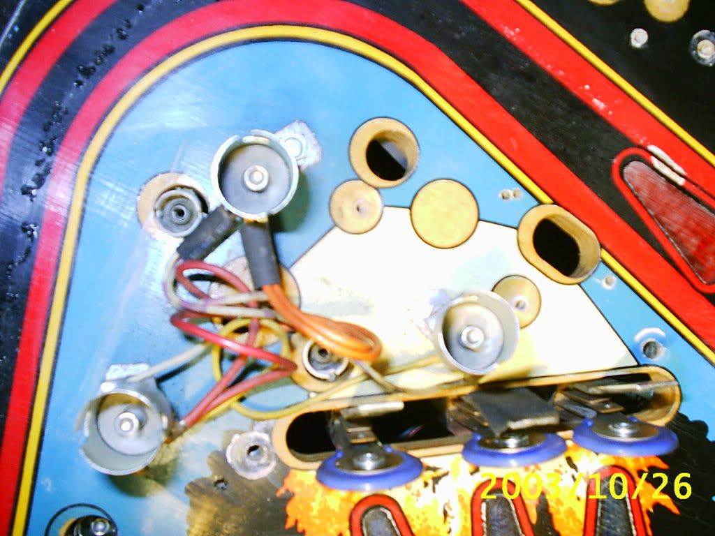

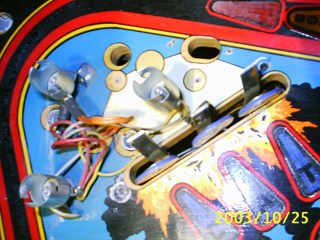

I need a BIG favor. I bought a F14 that was dissassbled. I'm putting it back together and I need some pictures of the upper playfield with the plastics and wire ramps removed. The previous owner desoldered everything from the top and removed it. Things like light sockets are really difficult to figure out the wiring on. If you've shopped one and have pics of this stuff, I could really use them. I can give you FTP access to upload them or we can work something else out. PM me with details.

Ditto - have a ton of pic's from when I shopped mine out - including lamps removed from the upper playfield for clearcoating. Mine's an early production version, so has all the flashlamps up top that were removed in later revisions.
PM or post here if you need more than what joeycuda has, and I can upload them or share them.
This is where I could use some help right now. Thanks Everyone.

Hope this helps:
Thanks So much!!! That helps a lot. Some of the flashers were actually removed on some games and that's what I have. I've heard you can add them back in though so this will probably help if I want to try it. Thanks Again!
