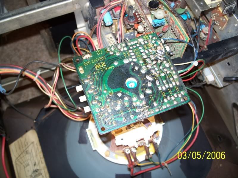

I desolder both points of the gap I want to span. Get a resistor or capacitor lead (or insulated solid core wire for large spans) make small loops on the ends and solder it on. For small gaps on neckboards just scrape off the green stuff and solder the resistor lead to the trace on both sides.

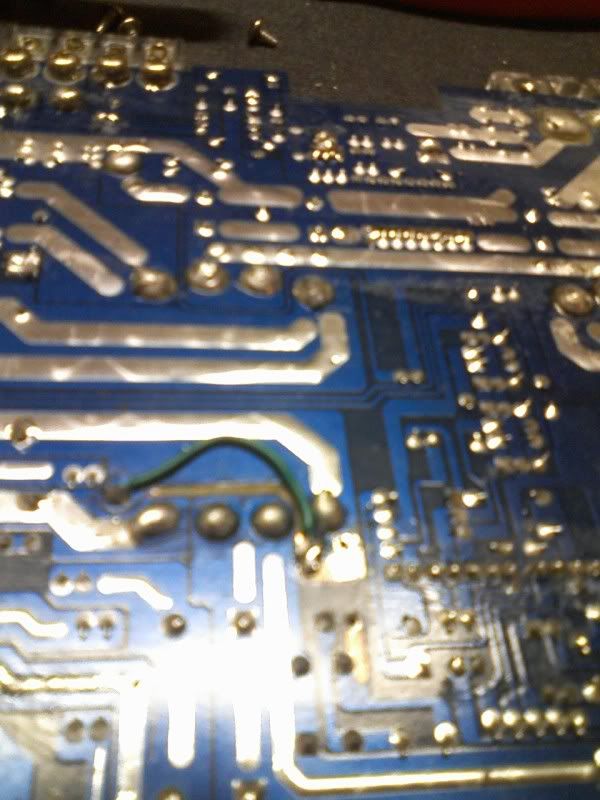

Here are a couple I have done recently.
Sorry for the crappy phone pic
This trace on the Amplifone HV board was pretty well cooked... I used solid bus wire and flowed it together with solder to create a new connection that is capable of carrying the current.

If you replace a lifted trace, how do you determine what size wire to use?
Jeff
I always use solid wire and go by the width of the trace as a rule of thumb... For really really wide traces I will use more than one piece and solder them together (as shown in the pic). 18 guage is probably the largest you will ever need (for high current traces) and 22-24 gauge is fine for most everything else.
