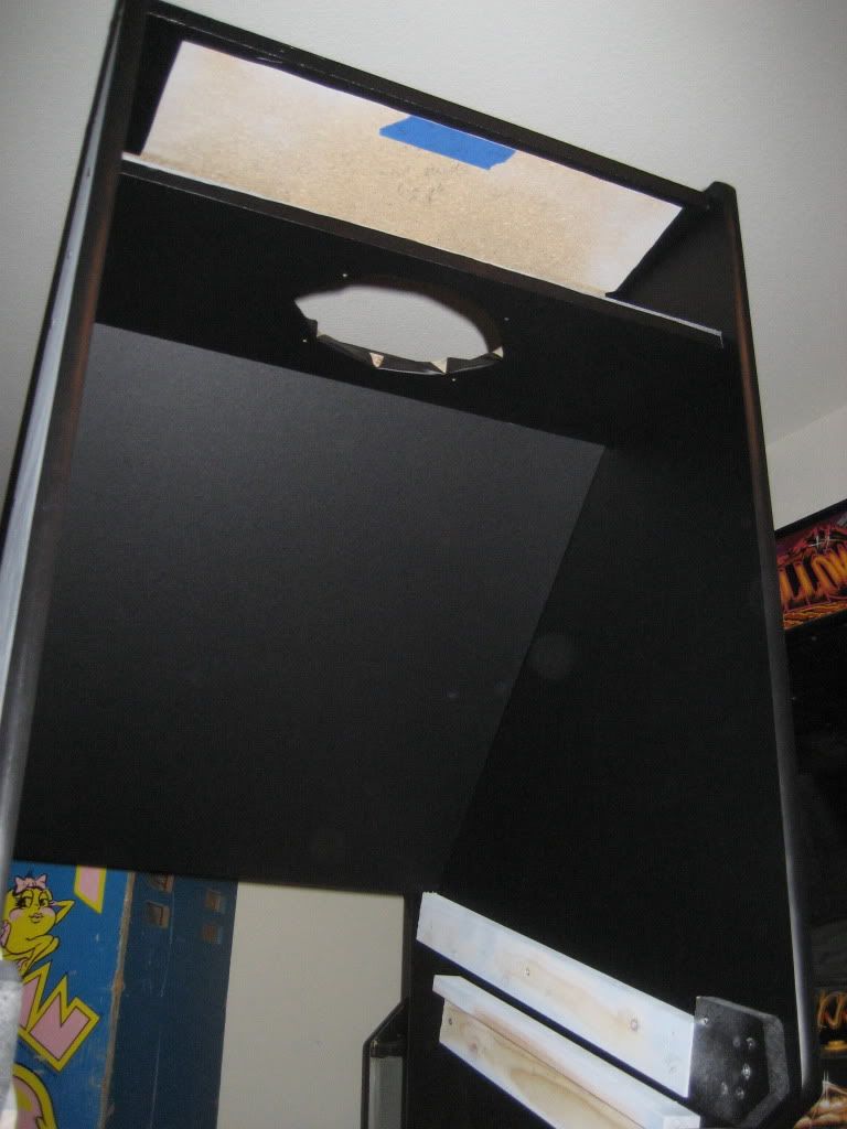

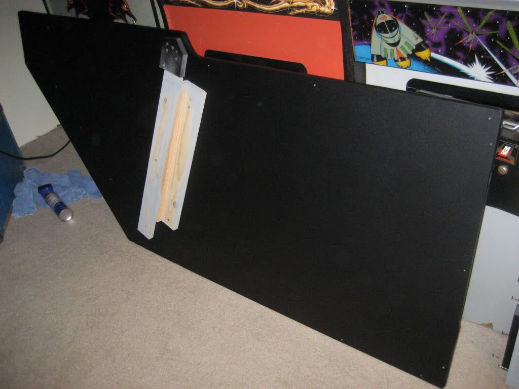

the white vinyl on the outer sides of the cab is smooth. The coin door kick panel area is also smooth and black in color. I don't actually think this is vinyl. I believe it's laminate. The inner side area of the cab meaning the black vinyl visible in the monitor area on the left and right as well as the speaker area and the angled panel behind the speaker area that meets the bezel is all covered in black pica vinyl just like happ sells.
the areas shown in these pics get the black pica vinyl
