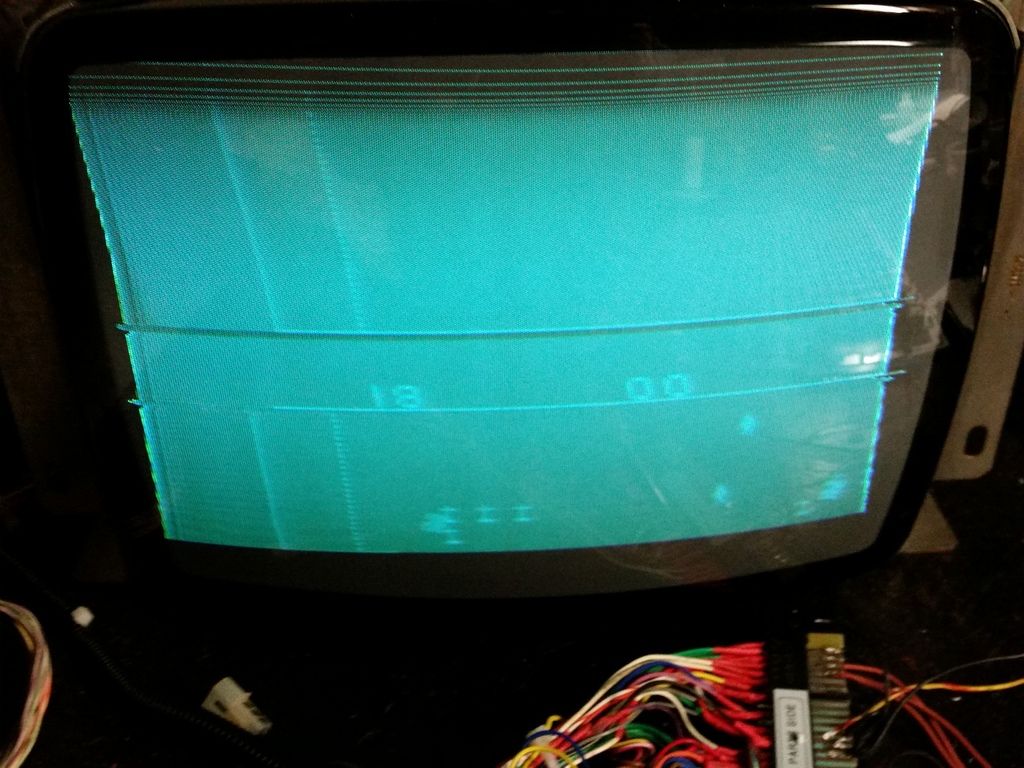

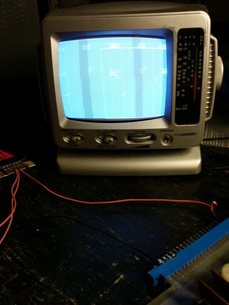

I just get an Exidy Death Race PCB and I'm having trouble getting the picture to SYNC right. I can sometimes get a stable picture but there is always something wrong with it. I have tried using composite video to a TV and I have tried going through my monitor on my test bench.
Composite video on a small black and white TV I get this
On my test bench I get this

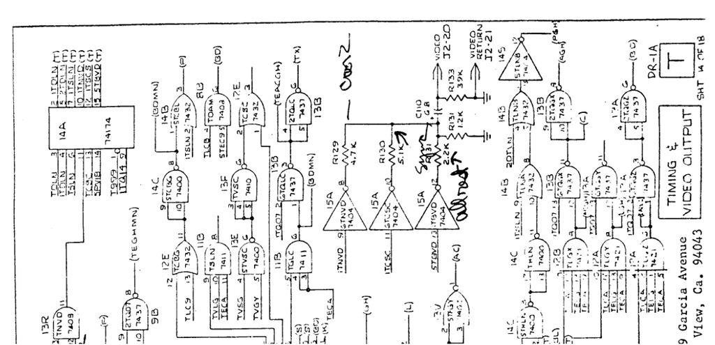

Now I read that trying to isolate the SYNC out of the video circuit can help and I found this in the original schematics. Problem is that the place where the SYNC is labeled in the schematics says it comes out of pin 10 of chip 15 A and that leg goes to a resistor R130 when I checked that pin just goes to nothing and none of the resistors or other parts on the PCB are silk screened with numbers. Only the primary chip locations seem to have any number and lettering system.
Schematic

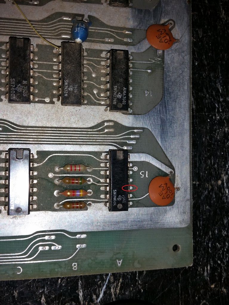

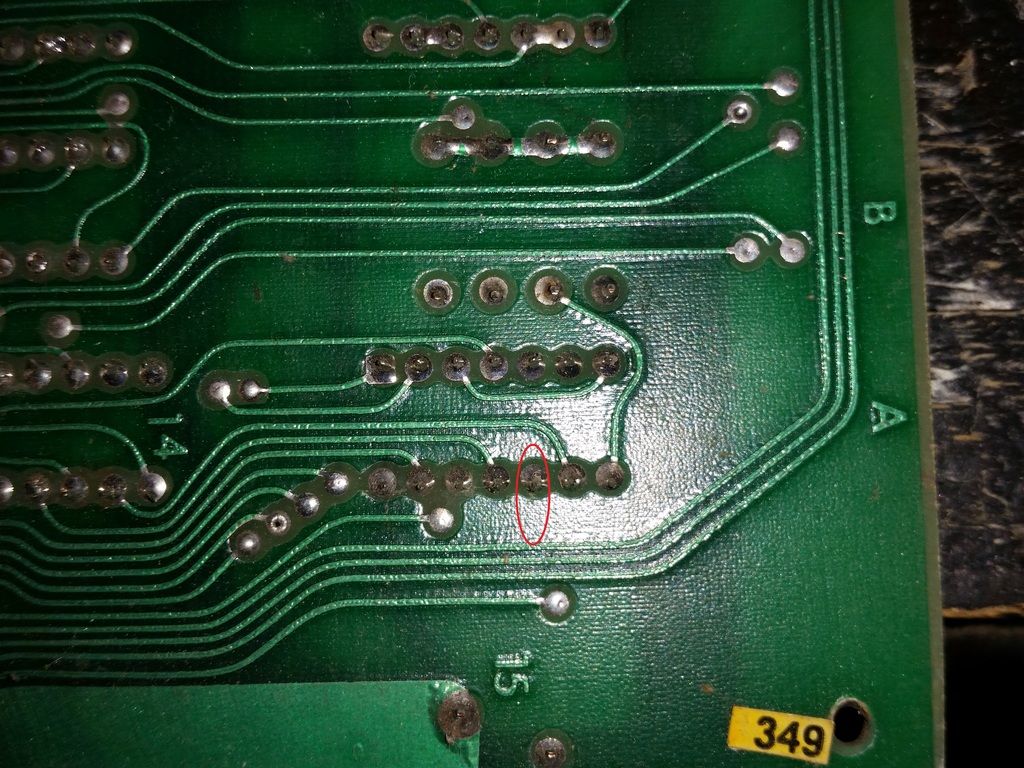

Here is a picture of pin 10 chip 15A top and bottom nothing just a floating leg.

I just figured it out, apparently the schematics above are correct. But the trace runs under the chip to the resistor as soon as I multimetered it I confirmed it. So I jumped the SYNC off the chip side of the resistor and the video stabilized like a rock. Problem now is that the car sprite is still not SYNCing and when the Gremlins walk into the same plane as the car they to go out of SYNC. As soon as the gremlins walk out of the cars plane they go back to normal.
So jump the wire off of the IC side of the 5.1k resistor which is R130. Or just jump it right off pin 10 of IC A15 which will work the same.

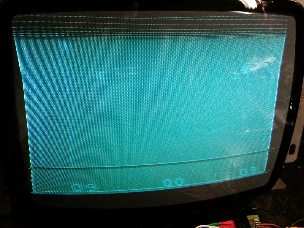

Here is the picture now with the out of SYNC car. Could I be missing some sort of SYNC signal for the car?....
Ok so I just went back to take a look again and this happened
As the gremlins walked around they would go in and out of SYNC randomly. After a few more times turning it off and on different sprites would randomly go in and out of SYNC. So it looks like its some sort of TTL problem that controls all of the sprites.
