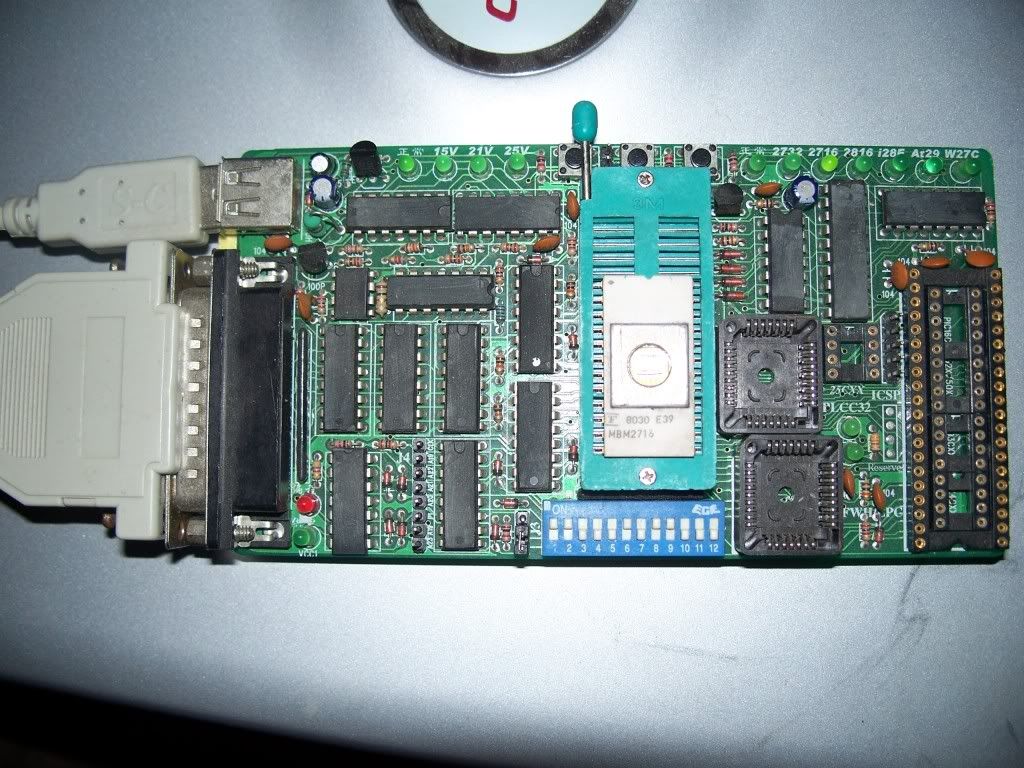

I am trying to burn some eproms but the burner keeps saying there not empty, at first I was not cleaning the window spotless, Now i am and they still say not empty, can you cook them leaving them in the uv to long? I used the burner before with no problem

Ok it says Error at 0x000001 Chip = 0x01 buffer = 0x00
Size & check sum 0x7ff 0x0000
I have no idea what the hell any of that means
What operation were you trying to perform when you got the error? I take it you were trying to write 00's over the chip?
Basically what this means is that it hit an error at the very first cell of the EPROM, it's comparing the data on the chip to the data in the buffer, and the first byte came back as 0x01, but it's supposed to be 0x00, since that's what you're trying to write to the chip. Size came back as 0x7ff, (2 kilobytes), which is the size of the EPROM, and the checksum of the buffer would be 0x0000, since the checksum on all zeroes should be zero.

Not to rain on your parade, but you have that chip plugged in wrong. Pin 1 should be at the top left corner of the ZIF socket. You have the notch on the EPROM the correct way but it is plugged in at the bottom of the ZIF socket.
No, he's got it right. Unless his programmer operates differently from mine. If you compare the differences in pinouts between the 2716 and longer chips (like the 271001), it'll make more sense. The extra address lines of the longer chips are "above" the existing pins on the smaller chips. Since the 2716 doesn't have those upper address lines, it goes at the bottom, not the top.

You can reverse polarize the floating gates if you leave the eprom under UV too long... many will still burn with enough patience, but not on the first attempt... you'll end up with stuck 1's that take a bunch of programming attempts before they'll clear.

Then his Willem is different than mine was. On mine Pin 1 was always in the upper left corner.
It also required an external power supply in order to be able to burn NMOS EPROMS reliably. I used a 12V HP laptop computer ps and then it worked. It never burned the older chips right with USB power.

Ok, from what I read on there forum, This Willem thing is a useless piece of SH*T it will not work with 2716 or 2732 like it said when I purchased it, I would like to stick this piece of SH*T UP THERE AS*!

I was also able to burn 2716s and 2732s with the older Willem I had, but it took a 12v external power supply to be able to do it. The problem is that the older EPROMS burn at 21 or 25 volts and the Willems use a DC to DC power converted and the USB port just can't deliver the amperage necessary to keep the voltage up high enough.
Even with a 12V 1.2A power supply it wouldn't reliably burn 2532's so I sold it and bought the BP. I am sure some of the others here can let you know what their favorites are.

I find it odd that the thing has indicator LED's for the various programming voltages, and yet doesn't have any sort of power supply connection. It seems to have been designed to generate the necessary programming voltage from the USB connection.
What happens if you press that button right next to the programming voltage indicators? Can you just change the voltage that way?
