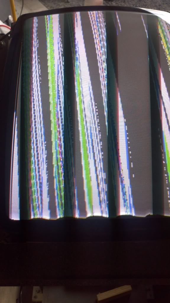

I've got to get make trax finished quick. I've recaped it and put everything back together and I get this
the black bars are the camera but the image is scrambled
I get an okay image when I hook up my pattern generator.
i've pulled, sanded and resocketed everything.
I sanded and cleaned the edge connector.
Now what?
Thanks
have you adjusted you hold on the monitor chassis? just because the signal generator gives a perfect pic doesn't mean that the pcb output isn't different enough for the image to need adjustment. There is clearly an image on screen it is just skewed.
Thanks. I didn't realize that. I mangaed to jump the board to a different monitor and it worked fine. So it looks like im just adjusted way out of wack

I got it most of the way fixed with the holds. I was under pressure to get it finished and just didn't realize that because my signal genartor worked that the monitor could still be way out of adjustment. I'll check that resistor too.
