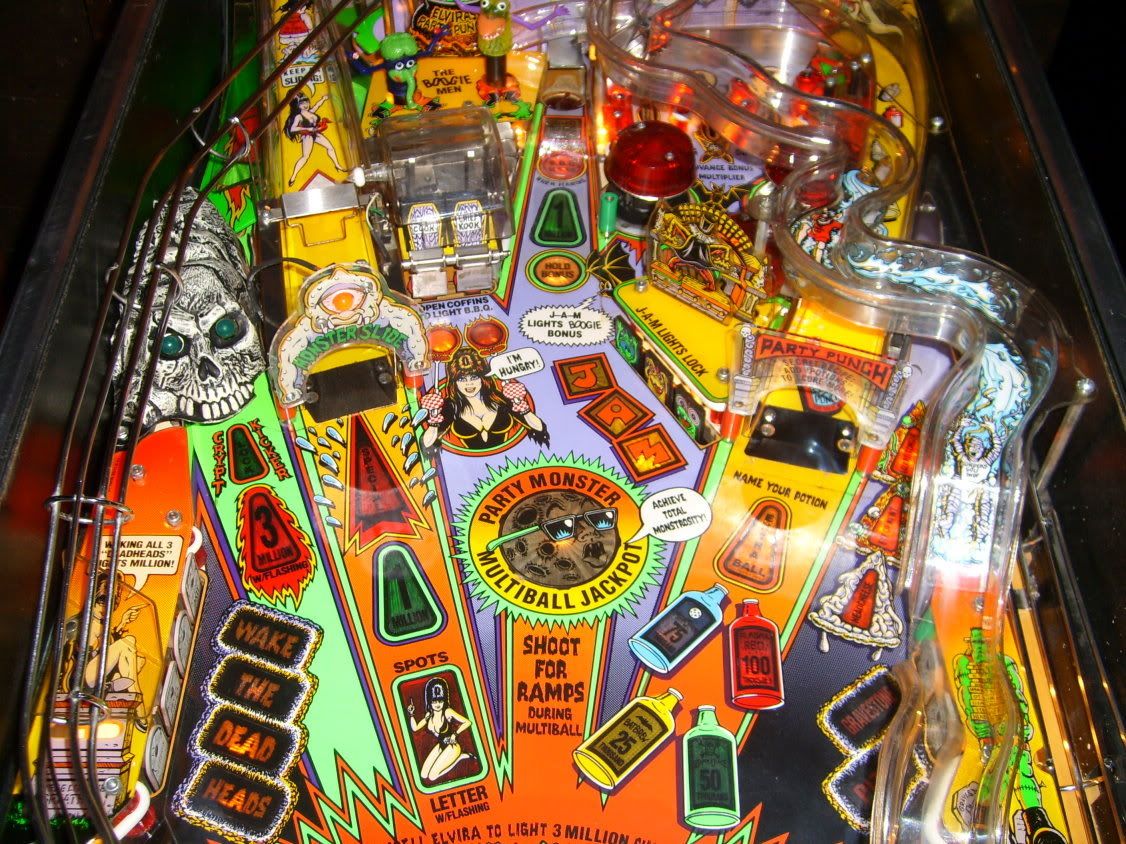

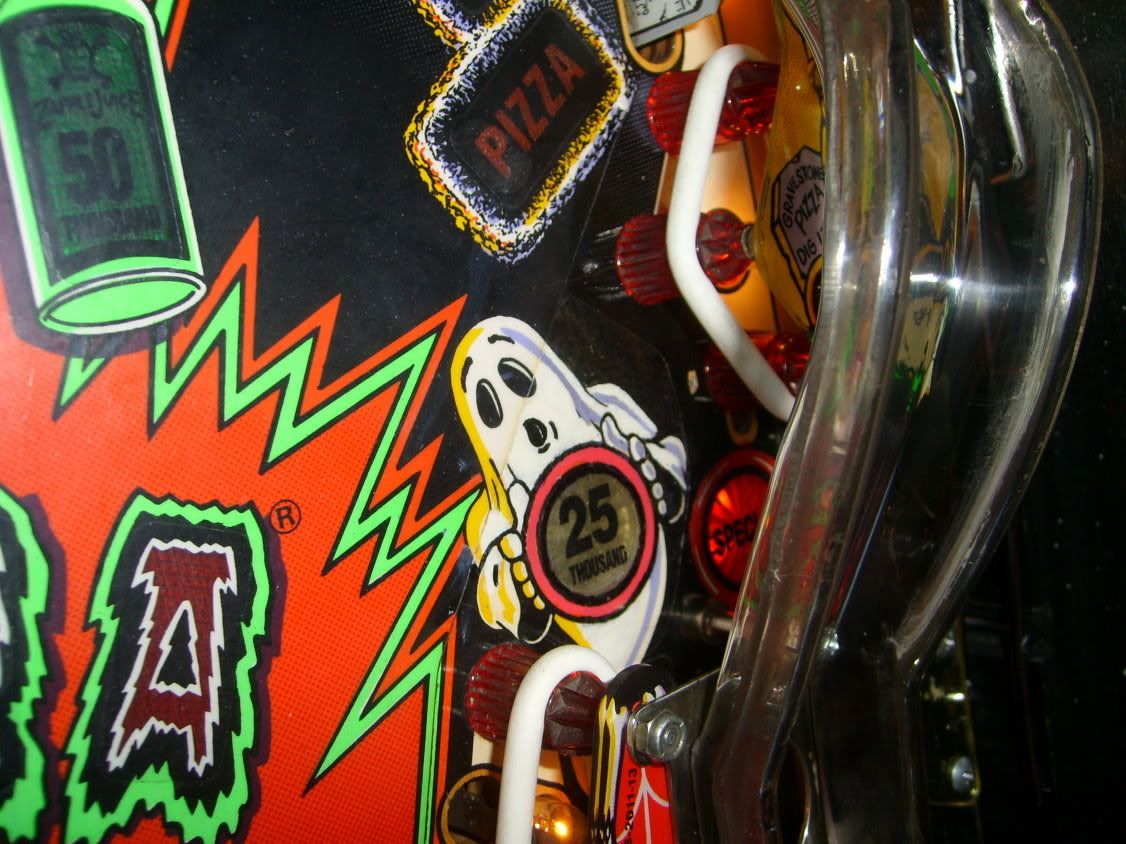

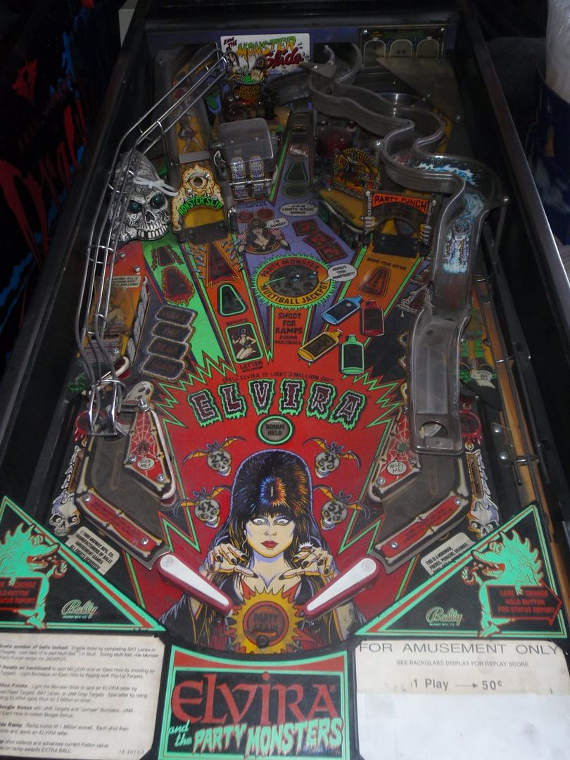

Phew...finally finished shopping out the Elvira & The Party Monsters that I picked up months back. I still need to get a blob plastic and coffin decals, but it's clean, fixed, plays fast and smooth 100%. When I got it, it was absolutely filthy...had some playfield wear, the flippers weren't working well (and it had the wrong flipper bats), most of the GI was dead due to burnt connectors and incorrect re-wiring...
So - here are some "Before" pics....
Right out of a warehouse where it had been sitting for years...both ramp entrance signs are cracked, one Boogieman is missing...

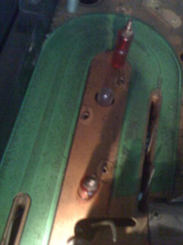

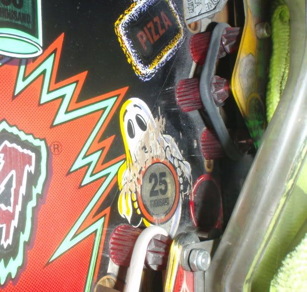

The ghost under the Monster Slide return is worn to the wood...

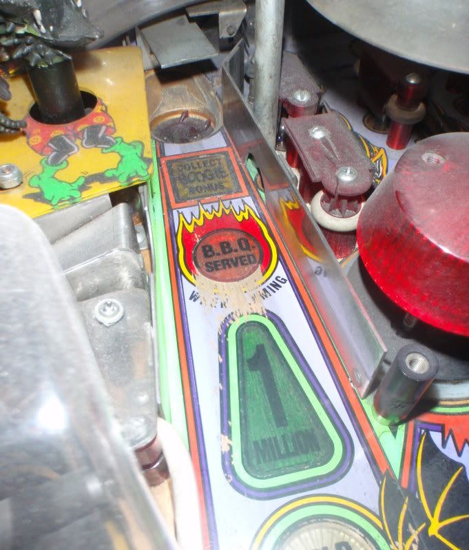

More wood wear...tiny lettering is a PAIN IN THE ASS to touch up!!!!

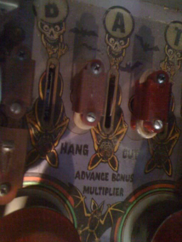

Dirty dirty & the BAT letters are worn a bit.

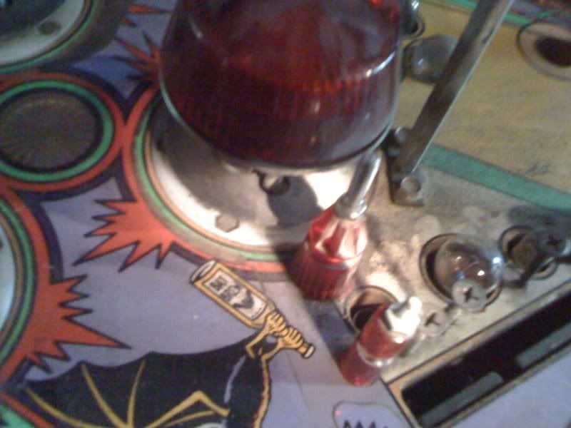

Look at the dirt I found after removing stuff!!!!
Oooh, nails instead of the actual metal pieces that are supposed to be there...
...(continued)...

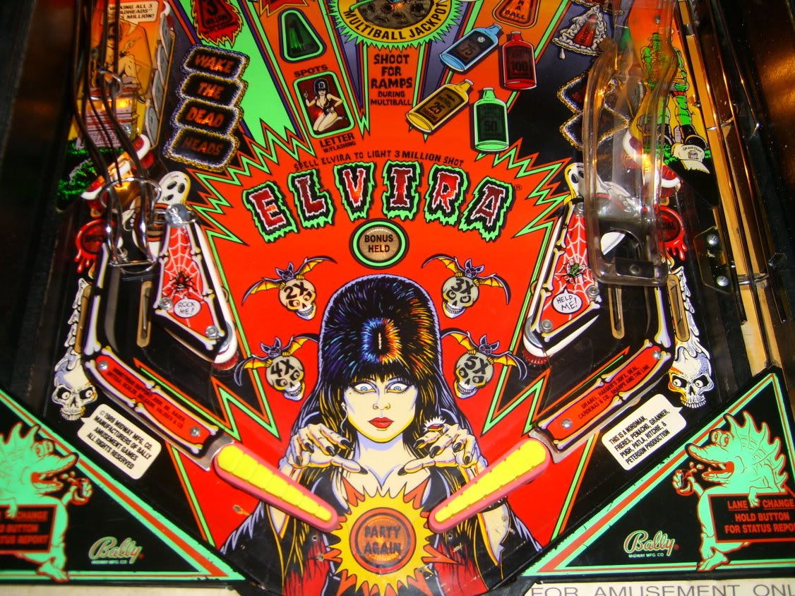

Here's a shot of the ghost touchup. It was really hard to match the white since the top of the ghost's head was under the original mylar. Pure white was too clean/bright..I had to dirty it a bit to match...

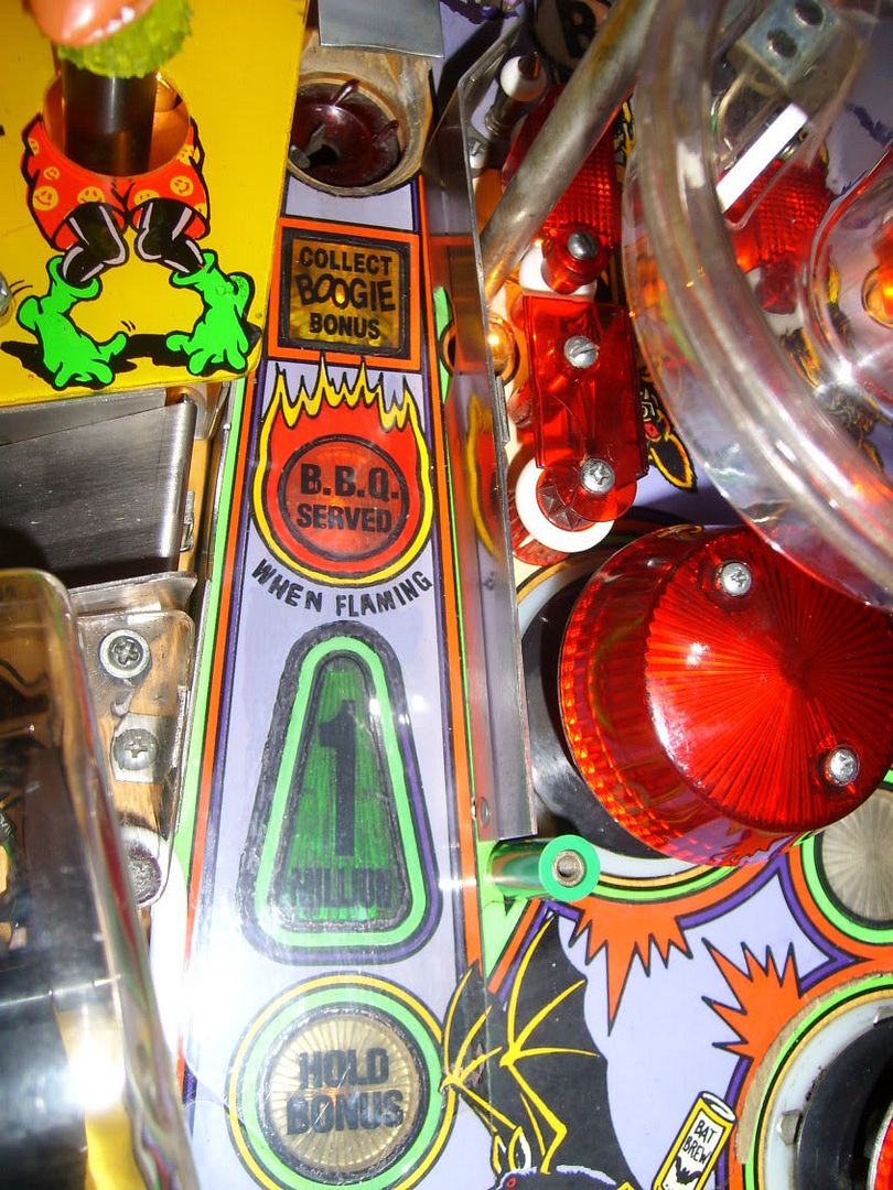

Here's my touchup of the BBQ area and the "When Flaming" text...It's not perfect, but I tried about 6 or 7 times before I got it like this...at that point I said "GOOD ENOUGH!" ..the purple's a bit darker...but from the players POV, you can't even tell.
Touchup in the BAT area...
Damn dude, your touch-up skills are pretty stellar. I'm going to have to try to contract you for any touch-up I may need in the future : )
Great shop job overall. Looks wicked.

Thanks! I've done bettter (my Guns n Roses touchups were more seamless) ...but at the end of the day, this game looks WAY better than how I found it...so - while not perfect, it's better than what it was.
Ya know, for a picture thread - my "after" pics could have been better...I can't find the battery charger for my "good" camera, though...hehe. As soon as I do I'll reshoot some of these.

I just updated the shop-out pics w/ better ones.... :)

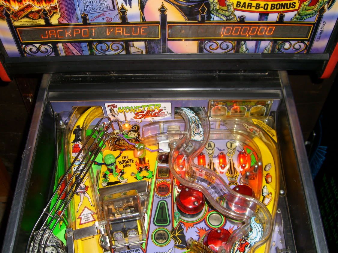

Did you do any polishing on the ramps? They look so clear in the after pics!
Just w/ Novus 2, then Novus 1. I don't have any experience w/ flame polishing...maybe one day! Even though the ramps are now clean and clear, you can still see the ball track on it....flame polish would get rid of that.
