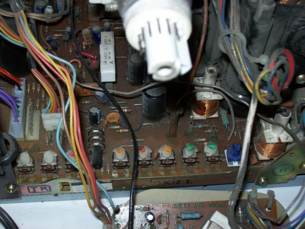

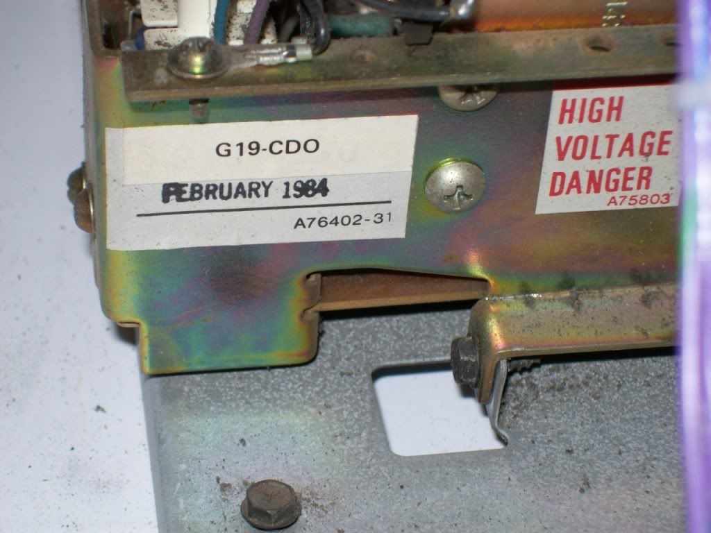

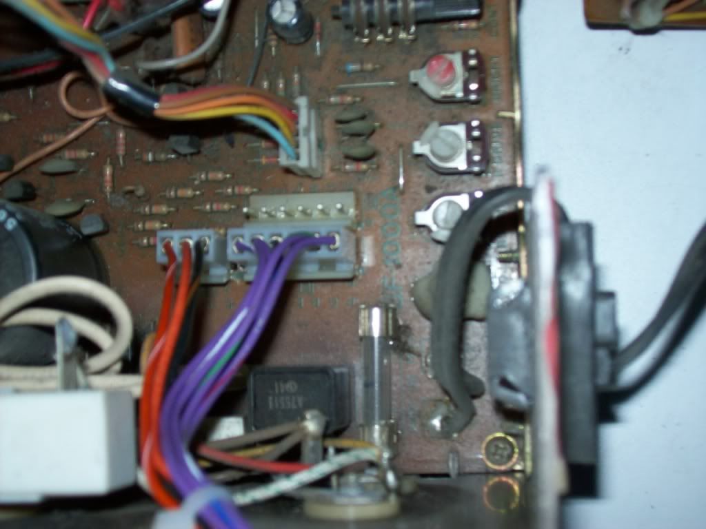

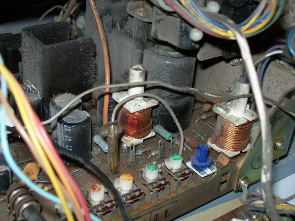

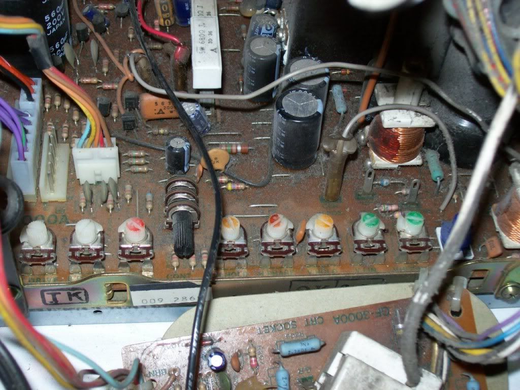

It has become apparent that the Electrohome G19-CDO is a somewhat rare monitor due to the lack of information available on it.
This post is only to provide information on this monitor in case anyone runs into one of these animals in the future. There will be lots of pics, and only a few notes.
This monitor has a low impedance yoke, unlike the G07 which has a high impedance yoke. The measurements that I got were 2 ohms and 14 ohms.
This monitor has individual headers for both positive and negative sync.
It uses a JVC flyback, with a horizontal width coil mounted on top of it. It also employs 2 more with coils directly on the chassis.
It uses the same neck socket pinout as the G07.
There are separate controls for H Hold and H Phas. (H Freq)
more pics to follow...

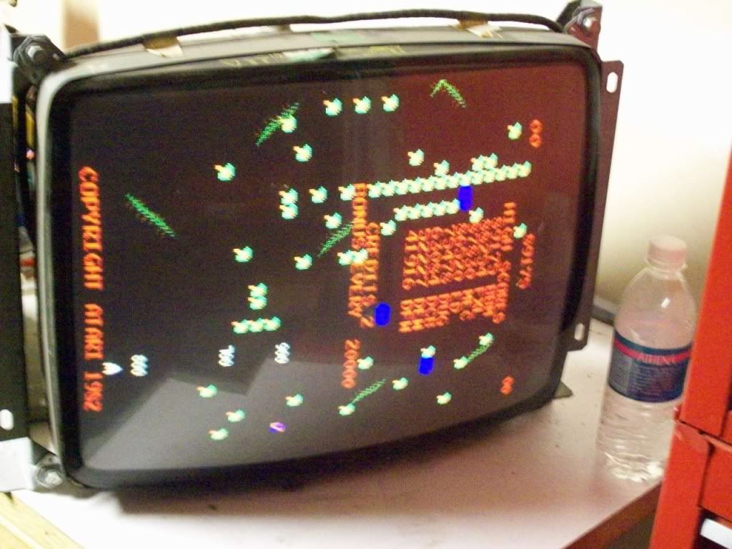

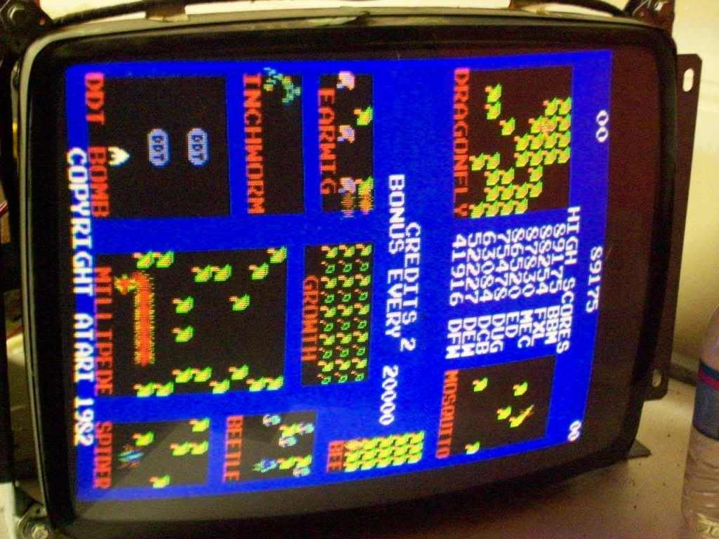

Over this weekend I was going through a stack of 13" monitors and came across a G19-FCO model to work on. Initially would not power up. After changing all the caps it fired up. Apparently the CRT is bad and will have to be changed. This chassis was in really great condition after cleaning.
