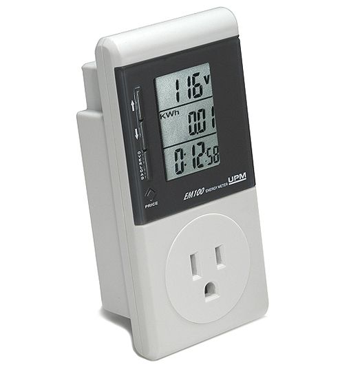

There's a pretty good deal on a power meter on 1saleaday.com today.
$19.99
http://1saleaday.com/wireless/
