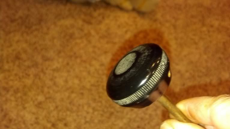

Here is my spinner knob afer cleaning. As you can see it is still faded and brown in areas. How do you restore this back to a nice solid black? Thanks for any advice...

My TRON had 30 years of pizza/people grease on the spinner. I soaked in a mix of about 70/30 simple green/water for about 30 min. The gunk just fell off. However, it left the knob with a greyish/whitish tinge. I had to use several passes of Back to Black. It's still not pure black, but close enough. I suppose if I gave it a few more passes, it would be back to normal.

I thought I had some before/after pics of my spinner, but I guess not. Back to Black can be found at most auto parts stores. It's used to polish/rejuvinate bumpers and plastic trim.
my spinner top looks a little different I think. Are you sure that's an authentic dot spinner top?
I honestly don't remember. I had 2 of them and I think they both looked like this:

Nope your old EDOT had/has a spinner just like his pic shows
thanks for confirming. So whatever this 'knob' is that I have is not a stock dot then. It looks a little more angled, etc.

That is an old Oscar controls DOT repro spinner knob.
I guess huh? My Walmart carries it
..but currently out of stock. I soaked it in glass cleaner for awhile and it seems yo be staying black...still some "dirt" in the grooves...but gonna soak again to see if it takes care of it. If not I will get the back to black...
