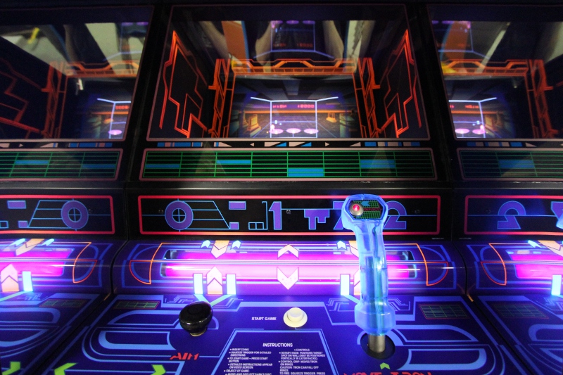

First set installed! They look absolutely fantastic.
You can find more photos and information in my restore thread.
Thanks! Getting the old ones off is the hardest part of the job. If I was going to do it again, I think I'd try a little heat to see if I could separate the mirror without pulling up the vinyl. Also, when you are trying to get the old adhesive off of your hands, WD-40 works pretty good and makes your hands smell nice, too.
Looks great! Any installation tips?
Thanks! Apart from the stuff about the adhesive above, my other tip would be to test fit the panels with the backing still attached. My cabinet had slight variation from left side to right side, so I'm sure there would be variation between cabinets. When test-fitting the mirrors, I paid close attention to which points were touching when the mirror was aligned. (For instance, does the upper rear corner need to be tight to the top, or the upper front?) Then I peeled the backing and made sure those points were tight as I applied the panel. I used a soft, lint-free polishing cloth to apply pressure and stick the panels.
