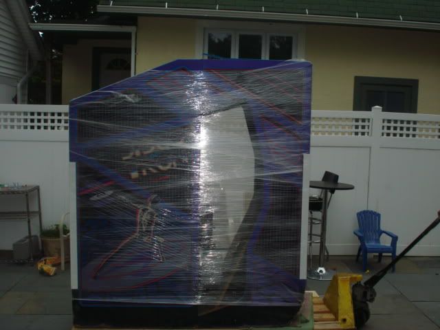

Well, after a long search, one came up locally.
Many thanks to baraka(John g) for the cab/lead.
Not working, and filthy but will clean up nice.

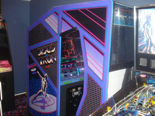

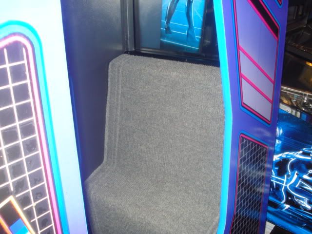

Last night i completely tore it down. There were mice living in it, very filthy. So far its cleaning up nicely. Everything seems to be intact EXCEPT for the back portion - its missing the backglass, back speakers and light fixtures (3 of them in the back?). I was told that the previous owner had this sitting in a basement for 20 years or so, and when they recently hauled it up the stairs, they shattered the backglass and just scrapped the fixtures along with it. Not sure how the speakers ended up missing. I have a nice pair of speakers to put in there, and since i will have a cab against the back, i may just hold off on putting fixtures back there - they will just shine onto the side of another cab.
My only other "disappointment" is the main Bezel is flaked out badly. Hoping for a Thisoldgame repro!

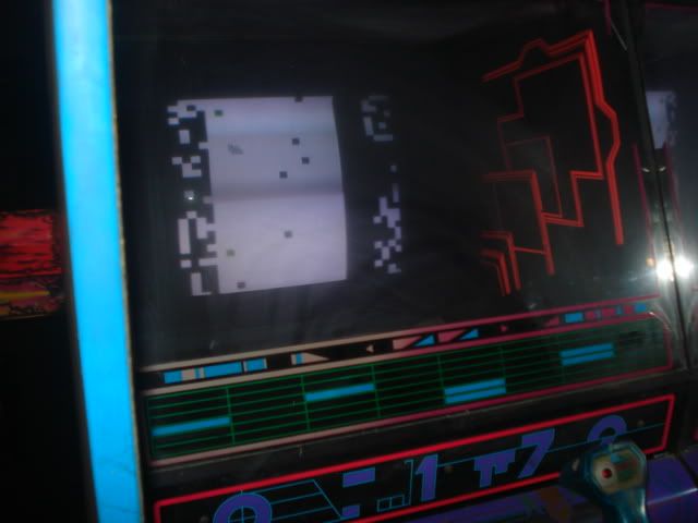

The monitor has no burn - and suprisingly the chasis / monitor was extremely clean compared to the rest of the cab. Boards look good, the PS board has some acid damage, so hoping thats my problem - we will see. I'm not very good troubleshooting boards, so i pray...

Update - It was a mess when it got here, so lots of cleaning and polishing. New carpeting, tore down and tumbled every screw, repainted the insides, etc. Took me alot longer than expected.
Most Boards were rebuilt by CDJump (cant say enough about his help) and the game plays wonderfully now. Many thanks to MJenison, Elutz, Joey for help on a technical thread i posted. Baraka hooked me up with a nice cab - he actually had to talk me into it and i am glad he did!
Last time i played was 26+ years ago, so its been a long wait.... Today it plays exactly as i remember it. I watched ALOT of youtube of it over the years, and those videos do it no justice - its just one of those things. High score last night of around 25,000, i got the logic probe (yeah!). Quite an ingenious game.
Finally i can "push the game to the wall".

The screen glitch was bad filter caps. When CDJump got the boards, they worked (some chips were out but overall fired up). When i got the game back, with a rebuilt PS too, still had the white screen. Bob Roberts sent over some caps and she worked (with some heat issues at the fuses, see a thread i started in technical help section). Right now, i am sure everything is good.

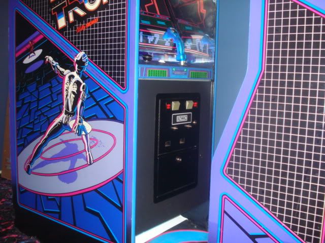

Exidy, yeah, no backglass for me. The previous owner had this in a basement for 15+ years. I guess one day he got brave and humped it up the stairs - with the backglass on! Needless to say it shattered. Fortunately, the back section is intact and the rest of the cab was in great shape, i just needed to bondo the rounded corners a bit. So yes, i am looking for a backglass (and expecting to pay up for one, its part of the deal i guess).
The Encom sticker was a print up by MoreCowbell - he had created Encom style marquees for Tron vids earlier this year and included that in his deal, i had one left over. Its just a sticker. Looks better than the rusted midway plate that i tore off the coin door.

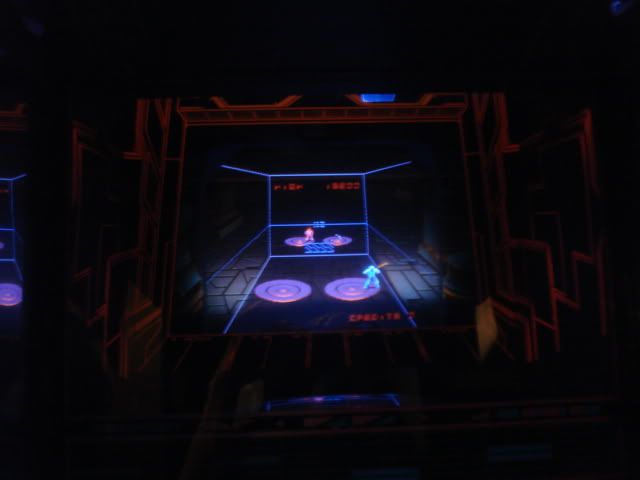

First off, you have the layers of artwork on the playfield - Tron landscape and some bezels behind a two sided mirror. The mirror is for the reflection of the monitor back to the player so as not to hide the artwork behind it. You can hardly tell you are playing off a mirror. In fact - my wife was in the middle of a game last night (last time she will ever play it :) ) and i mentioned she was playing off a mirrored image, she was pretty amazed by that.
Next, the game has a relay board that activates the light fixture beyond all the Tron Scenery. So, none of that depth is seen (its just the text from the attract mode), until you start it up, which dramatically and in sync with the music fires up the light, all of the layers appear at once, kind of like you are dropped into the Tron world.
Another relay serves as a strobe for the lights below the players feet and on the CP. They flash wildly when you get hit. Its actually scary and will "shock" first time players, probably thinking they broke the game (its the equal to a Pinball knocker).
Add in the speech, and yes, its all smoke and mirrors done pretty well. The gameplay itself is pretty good too - like 3D Pong.
