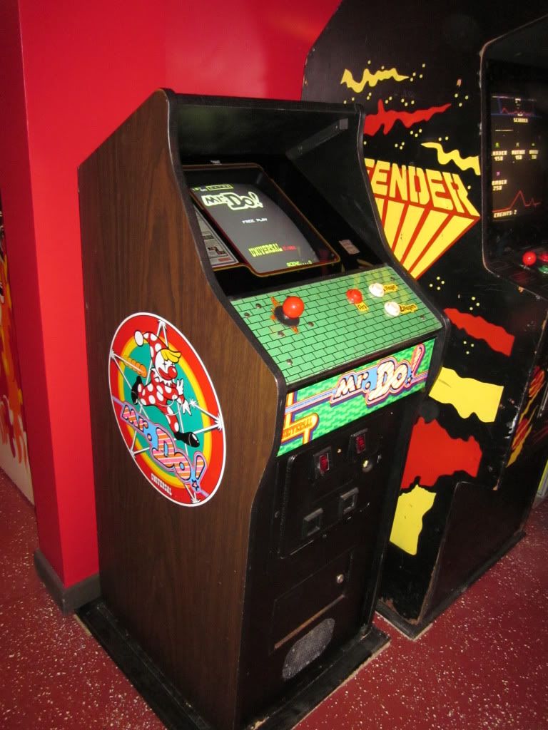

I have my games on plywood stands, with 2 strips of carpet rems glued to the underside. Protects from water damage, they're easy to slide around, and only raises the game less than 1 inch. Reduces damage to the cabinet from the carts, or sliding the game directly on the floor. Reduces damage to the floor as well. The carpet just slips right over it.
Great idea man - really sweet. Just curious - are you cutting all of the stands to the same dimensions or are you custom-sizing them per-game?
I had originally custom cut them for each game. But many games have come and gone since I first made them, so some of them aren't a perfect fit now.
