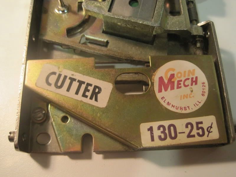

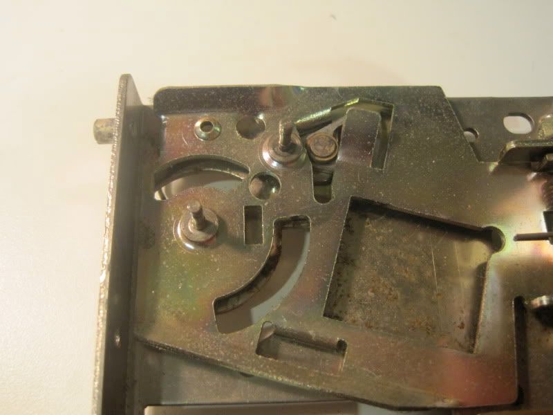

A friend showed me how to mod a metal coin mech to accept any coins. Works great and doesn't jam or fail.
Here's a Quarter mech I want to mod to accept .900 tokens.

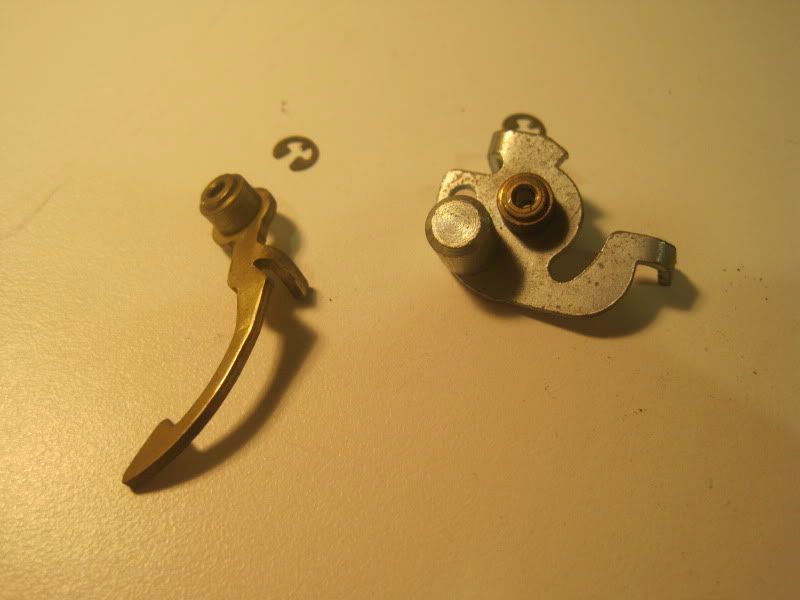

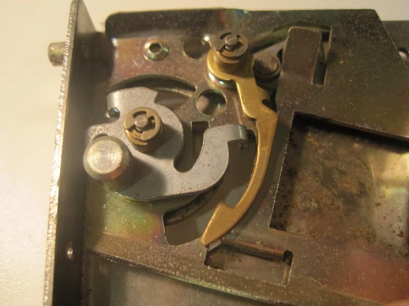

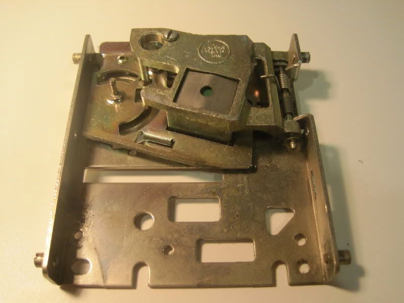

Remove the cradle and arm. Just use pliers to remove the clips.
Don't need these parts anymore.

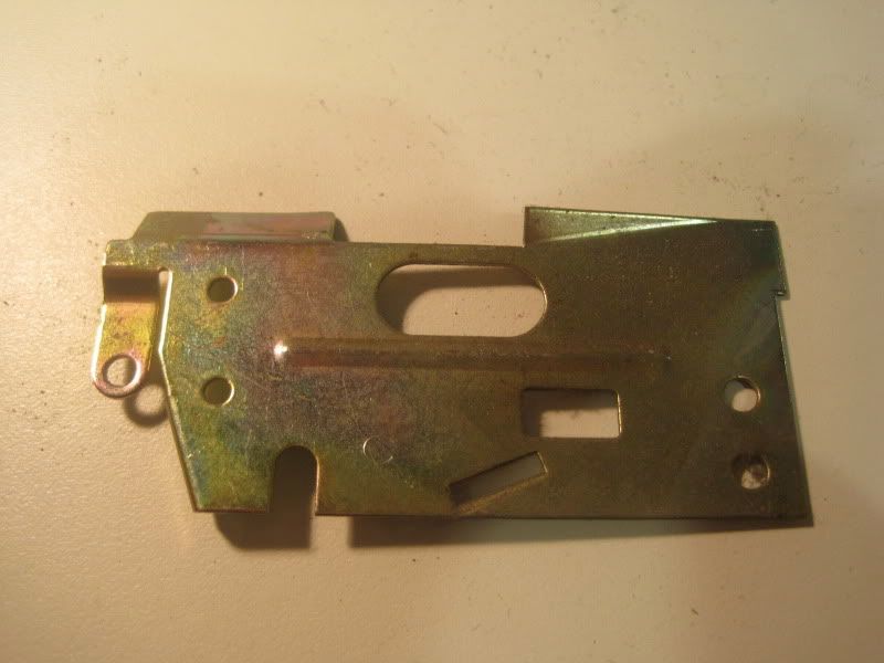

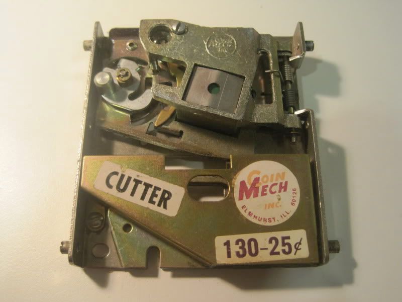

Now remove the bottom pieces by taking out the screw on the bottom left.
Continue next page.

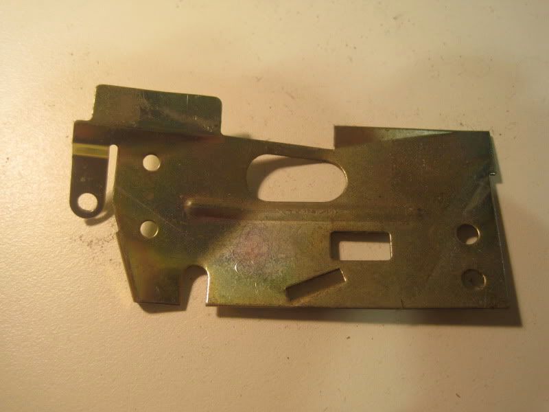

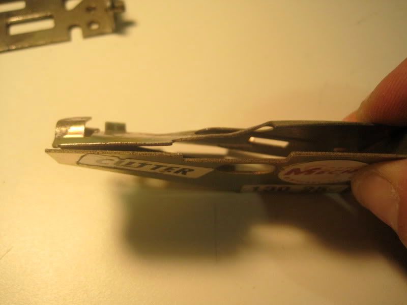

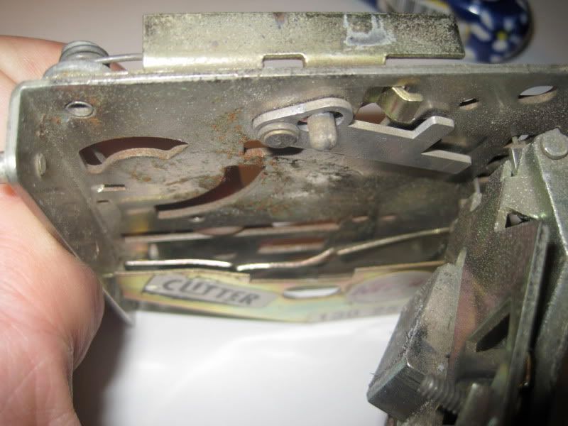

Bend the back piece on the top left so it closes the gap and the coin can't reject.
Now the hardest part of the mod is getting the screw back in. It takes some back and forth of adjusting the bends. A longer screw would probably make things easier. Of course the more you do this the easier it gets.
That's it! Coins now just fall straight down and you can coin up your machine with Quarters, tokens, pennies, slugs, ect...
