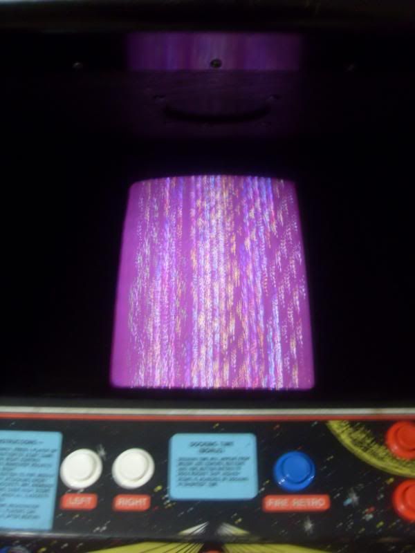

Well my eagle cabaret has started showing garbage when i turn it on now, but sometimes for a split second I can see the game then garbage but all sounds work, I put in a new switching ps and still did the same thing, any clues?
Depends on what kind of "garbage" it is.
Can you grab a pic of it ?
Monitor could just be loosing sync.
Yeah here it is,I can start the game and it will change patters but in lines like that
That looks like the horizontal hold needs to be adjusted... what kinda monitor is it?
DogP
13" sanyo, i dont think its the h-hold, i looked at pics of losing sync and that what it looks like, anyway to fix
Losing sync is the same as hold problems. First, try adjusting h-hold until the image straightens out (you might need to tweak v-hold too if it's rolling)... if you can't get it to lock, then you should check the sync wiring, and check for bad solder joints on the sync pins (try wiggling the connectors and see if anything changes).
