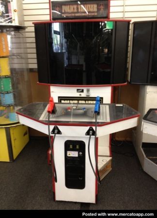

I have the opportunity to buy a Dynamo Showcase cabinet for $80. It has a shooter installed with two guns, but the screen is black (playing blind). They said they recently moved the cab from one location to another and the monitor stopped working. They don't have the money or experience to fix it. Also, do you think a Showcase will fit in the back of a Chrysler Town and Country minivan? The biggest cab I have hauled so far is a Z-back.

This is the actual cabinet:
That actually breaks down into 4 parts. The marquee box on top comes off, the control pedestal unbolts and pulls away, and the monitor section unbolts and comes off the pedestal where the power supply and PCB mounts.
The heaviest part by far is the monitor section.
It's a Dynamo HS-15 and here is the manual for it: http://www.drzero.org/videogames/dynamo/Showcase.pdf
Even with it broken down into the 4 parts I had to have a small truck + trailer to fit it all. The thing is a beast.

it does fit in a Honda Odyssey. it's going to be very tight. I had to move the front seats all the way up.
How did you stack the other pieces, did you take the control panel off of its base? Remove the old marquee box? I think I have about 76, or 78 inches from back of the front seat to the tailgate of the van.
Marquee Box
29.25" W x 9.5" H x 9.25" D
Monitor Section
48" W x 29" H x 26" D
Monitor Base
33.25" W x 41.5" H x 32" D
Control Panel
48" W x 39" H x 29" D
So, if you take off the marquee on top and detatch the control panel section you are looking at 48" W x 70.5" H x 32" D
