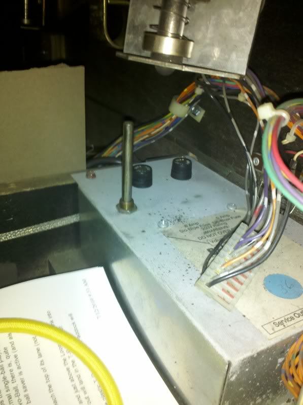

With the help of thirtyfathomdave this weekend, I picked up a damn fine Jurassic park pin. The right flipper is s bit weak, but that can hold out for another day. Right now all I want to do is simply turn down the volume. It's my first Data East, and the adjustments are completely new to me. I'm prepared to look like a fool.
open up the coin door...there's a pot volume control on the right side. this was taken of my JP:
in the game adjustments (adjustment #39) there is also a percentage display of the background volume. mine is set at 100% and then i fine tune it from there with the pot control.
to get to those adjustments, the controls are inside the coin door on the left.....there are two buttons. one you push in and out...this will take you forward in the menus. the other pushes in & stays...while depressed, this button will take you backwards in the menus. to change the audits/adjustments from within the menu, use the start button.
hope that helps.
