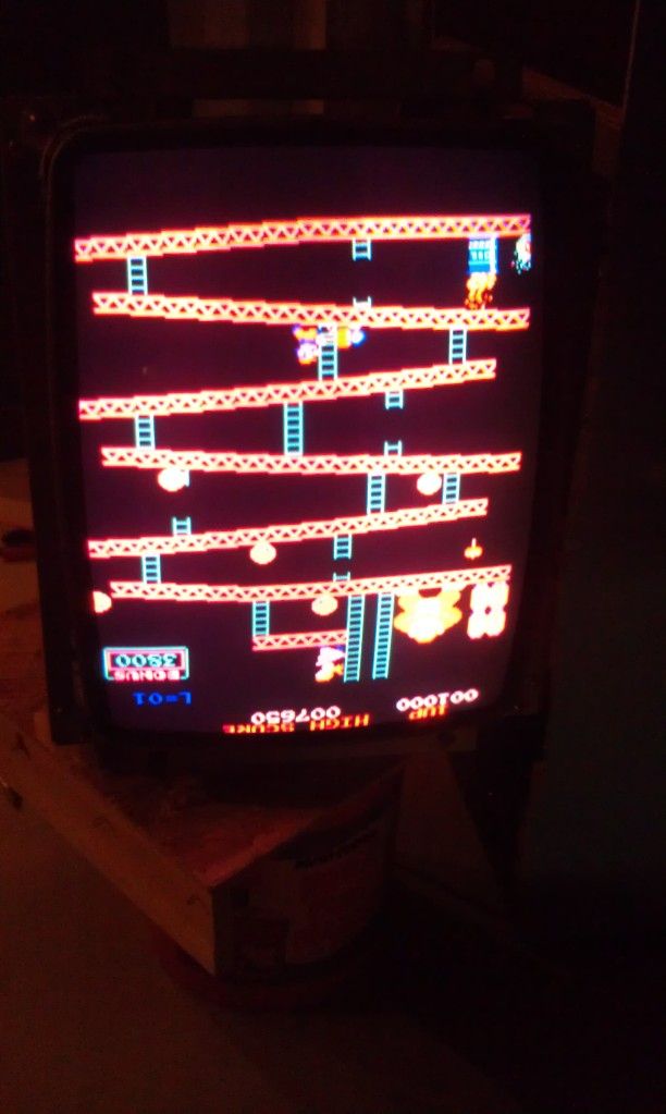

I have a pair of Sanyo 20EZ monitors out of a dedicated .vs dual system...
As you can imagine, the picture is inverted on one of the monitors and its the good one :)
The other one needs capped and can be used in the future after a good cap kit.
I am finishing up my DK project and want to use this monitor... Any ideas on how to turn the pic from upside down to right side up? Is there a dip switch? Is it the yoke? I'd like to get this done tonight!
Here is how it looks:
Mount it upside down :)
If you reverse the two horizontal yoke wires, and the two vertical yoke wires, it will swap around the direction. You'll have to look in the manual to see which is which, I dont' want to speculate and fry your monitor.
Edit: if you tell me the four colors of the wires that are on the yoke connector plug where it plugs into the monitor board, I could tell you which ones to turn around. If you look close I'll bet it's already broken in half where somebody else did it already.
Yes, sorry for the wait. Yellow and green are your vertical, and red and blue are your horizontal. Just like you said, Yellow, Green, Red, Blue would flip it.
You just want to make sure to never swap them between windings, so the blue and red should always be together, and the yellow and green should always be together.
It worked great!

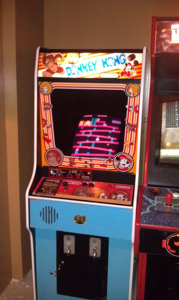

Now to finish, I just need to make some monitor adjustments, make a monitor shroud, and locate the right color buttons!

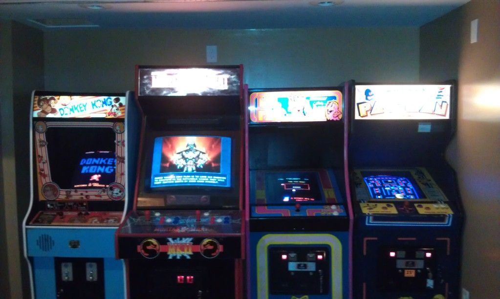

and in my small lineup!
