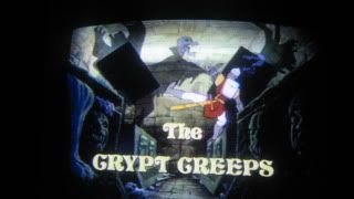

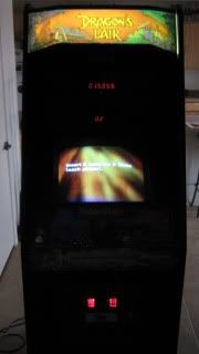

It was almost dead. After cleaning it I installed a new harness (the previous one had been cut, spliced, and had it's plugs smashed?!?! How did this happen?). Changed out the lights, etc. New buttons & cpo. The LDP it came with (LD-V1000) was dead so I got a Pioneer LD-V4400. Then I installed a LaserCon card and now it works!

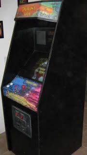

The sides looked like they were altered before. One side had vinyl on it, the other was painted? So I painted the cabinet black. I know it's not how it came from the manufacture, but it was easier at the time. Later I may read up how to apply the vinyl to the sides, but I'm happy with it.
Still got to add side art and some other little things to address, but the last few attached pics show how it's looking now.
