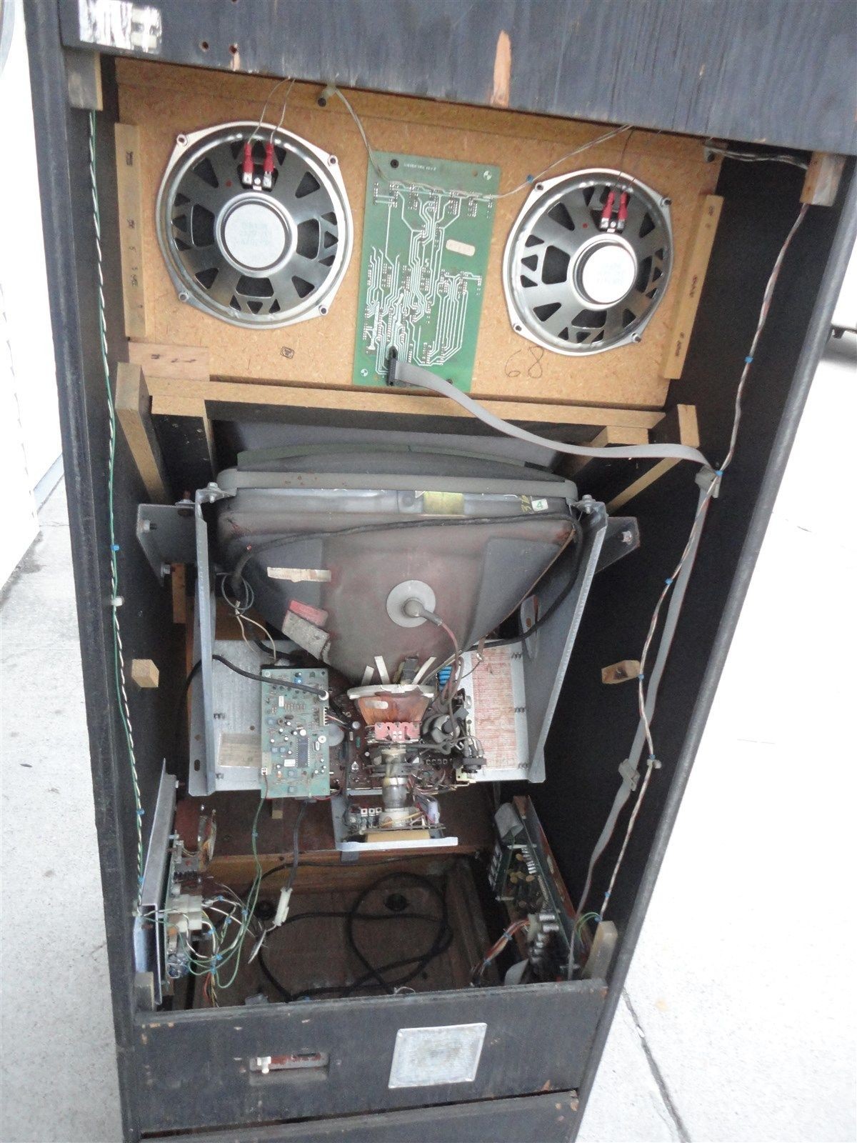

I'm bringing up a dragons lair cabinet and want to get video output so i can run diagnostics. The internals have been worked on before so I spent today figuring out how to wire power and figuring out what is original.
Picture of ntsc decoder board attached. I believe this is original. Should anything be connected to p204? There is replacement power supply so I do not see how this board gets power.
Also the monitor is a Zentih model, and I do not believe this is original.
I attached a scope to bnc input of the decoder board and not seeing anything.
So, I need some help testing the monitor, decoder board' and laser disc player. Any help geatly appreciated.
Also there is a board labeled sidam 11470. It has an edge connector and is spliced into some signals going to the main logic board. I don't know what this is. It is pictured here.
My main goal is to get video output so if i need another monitor or a dvd player to test i will do that. Thanks.

I believe Sidam was the company that made the Italian Dragons Lair cabinets.
That's a Wells Gardner P371 NTSC board and P204 is for power and blanking input which comes from the monitor chassis board. Here's a link to info of this board at MikesArcade.
https://www.mikesarcade.com/cgi-bin/spies.cgi?action=url&type=info&page=wg-ntsc.txt
As for your monitor, Zenith is not the model just the manufacture of the picture tube. USA Dragons Lair games originally had either an Electrohome G07 with their NTSC reticular board or the Wells Gardner K4900 with the square NTSC board like the one you have.

Zenith is just the tube manufacturer and not the monitor manufacturer.
Take a pic of the monitor chassis and we'll tell you what arcade monitor you have.
Chances are it is an Electrohome G07.

The sidam board looks to be a coin doubler circuit. I would remove it entirely.
You have your player ribbon cable plugged in backwards, the red strip must be on pin-13 not pin-1 like you would expect (this is just an odd quirk of Dragon's Lair).
Your NTSC board is the Wells Gardner Type. Your monitor may not be WG, so it's going to be difficult finding the proper voltage and blanking signal. I would ignore that for now, and simply connect an old TV and find out if the game is working. Does the game boot? Does the laserdisc play?

Seems your monitor is a WG K7000 series.

Yes, the ribbon cable coming from the laserdisc player is 180 degrees off on the connector. Flip it around and see if the player spins up.
The player is almost always the problem with non-working Dragon's Lair machines, so if it spins-up and begins to play, consider yourself lucky. Otherwise you will need one of my Merlin boards along with a newer player.
All video in Dragon's Lair comes from the laserdisc, so you are right on target to bring another monitor to test with. But don't count too much on the diagnostics tests in Dragon's Lair, I've found them to be fairly useless. The beep sounds are the true indicator of a working board set.

Your Monitor is not original, so you will have to figure out how to connect the NTSC board or replace the monitor.
Your Laserdisc player may or may not work. If it doesn't, you will need a LD-V8000 or Dexter replacement and a Merlin board.
