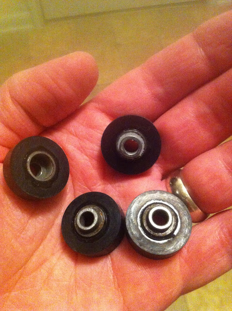

The old bump stops in the yoke were completely shot. After some digging and hunting I came up with what seems to be a very close substitution. Here is the thread of my quest to make these parts.
http://forums.arcade-museum.com/showthread.php?t=253842
I found these rubber rings in the plumbing section of Ace.
Once the old metal center shafts were cleaned up htese were a perfict fit.
