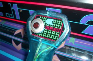

I'm totally green when it comes to collecting/restores and I've got no clue how to check if there is any power going to the led so forgive me if I'm asking a stupid question here. My deflect button works fine but will not light up. I've attached a picture of the button housing inside the joystick. Is this a common issue with DOT and if so is it usually the wiring or the LED burning out? If it's the latter it there a way to get the housing open to replace the light or is there a replacement part for it altogether somewhere online?
Any help/info is appreciated!

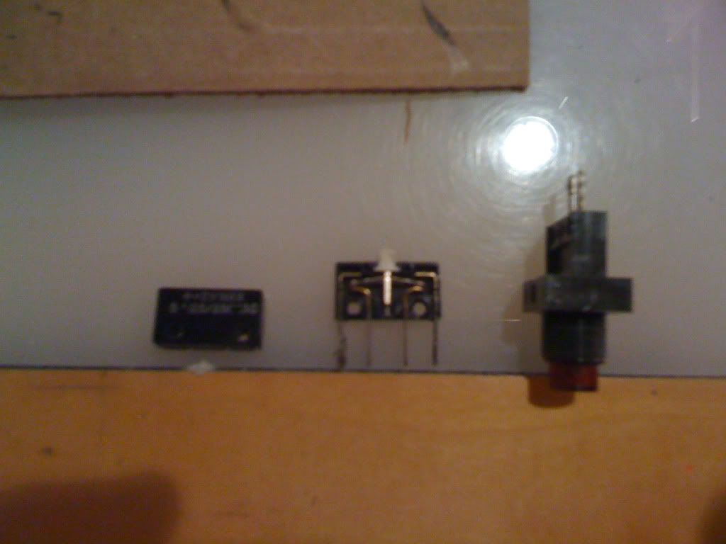

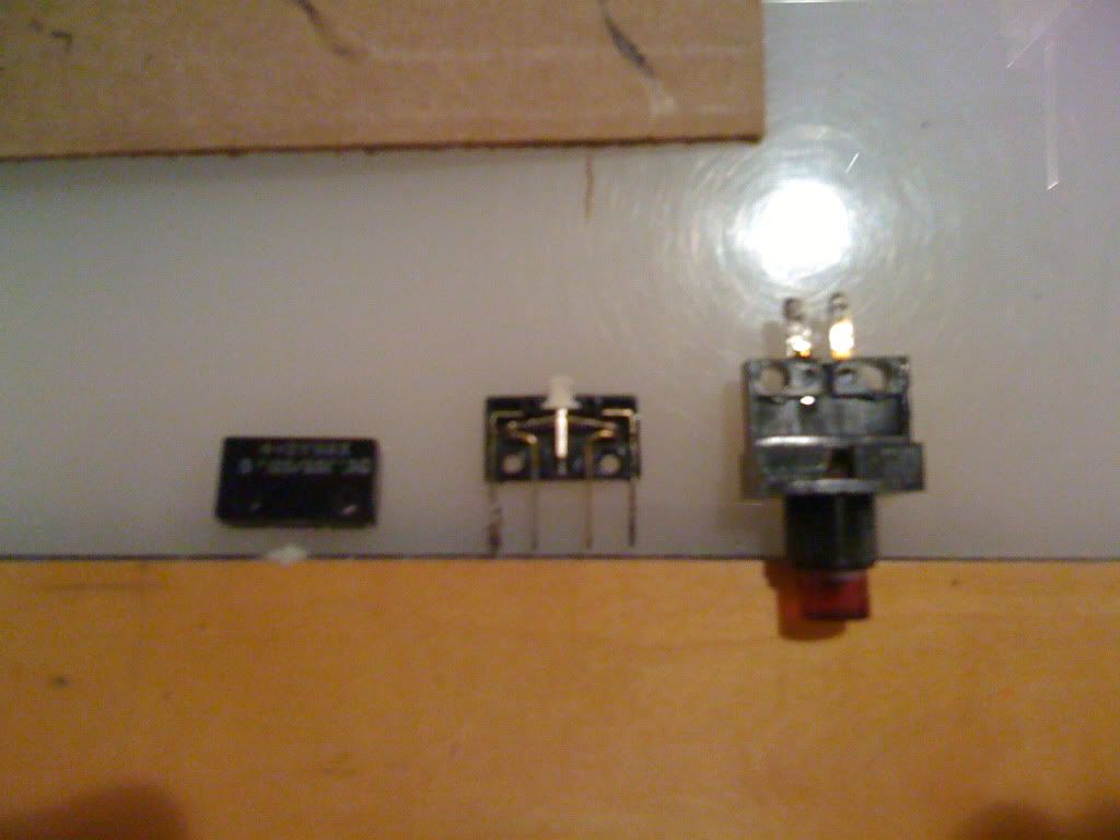

OK so I bought the Multimeter tested the switch and it read at 5.113 ( and based on your prev post I'm gessing thats right around where it should be?) so that means the LED is burnt out. here is a pic of the switch.
Unfortunately this was also my first time using a soldering iron on anything....... ever. Sooooo I think I held the connection too long and melted a bit of the plastic housing...... Sorry for the crappy blurry pics (Damn 3GS) you can just make out where the plastic is bubbled slightly.
So fearing the worst I kind of freaked and bought a new switch online. But because I still need to get my skills up I was wondering if this thing is still fixable? If so I'd like to try and salvage it if only for the sake of getting some practice.

Well I think I've got a little problem here. Once I got the switch apart I realized that the difference between mine and yours is that the housing around the LED/red button on mine is one solid sealed part. check the blurry pic I took. (currently looking for a decent camera I own that is lost in my wife's office somewhere)
If you know a way around this please let me know. It's really no big deal. The NOS switches I ordered have already arrived so I'm good to go that way. I'm just curious. Thanks again for taking the time to post the tutorial though.

are these aluminum Atari cones that are being sold over at videogameparts.com the same as the housing around the deflect button on the DOT joystick?
Mine is pretty thrashed up and I'd love a new shiny one!
Wow....Actually looking at them here in the post it's clear they are not the same..... The hell was I smoking? So does anyone know where I could find a new deflector cone?
Well that sucks. Look to see if there is a seam on the housing that you can split with a razor blade to open it up.
Yeah, those Atari cones won't work. Try some Brasso or Nevr-Dull on your cone to shine it up. I wouldn't use a wire wheel, it'll probably scratch the hell out of it.

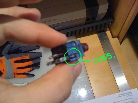

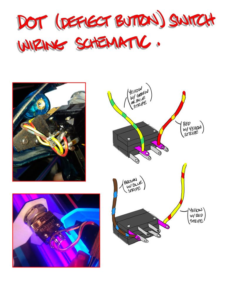

OK so its been a while since I've been able to get back to this. and splitting the switch at the seam with a razor was just not happening. So I ordered the new switch soldered it on, powered up the machine and still no light. I rechecked with the multimeter and it all looks good. Which leads me to believe something may not be wired correctly (although I'm so green I'm more than likely speaking out of my A$$). So I am attaching a little illo of how the deflect button is wired up in my machine. If there is anyone out there who sees something wrong with the placement please let me know Or, if you're a DOT owner and are willing to take a pic of how yours is wired up that would be great too. The pics you see are from when I first opened up the stick. I just re-attached it the way it was when I detached it.
Any and all help is much appreciated!
-J
I hope this helps. Sorry it took so long. This damn NE cold weather keeps me from getting into the garage.

Rats! And Double rats. Same thing happened to me. I miswired and pop!
Licon sucks for the record. At any rate, going to attempt to replace both leds'. I popped both of them in a Tempest project.
