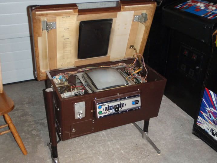

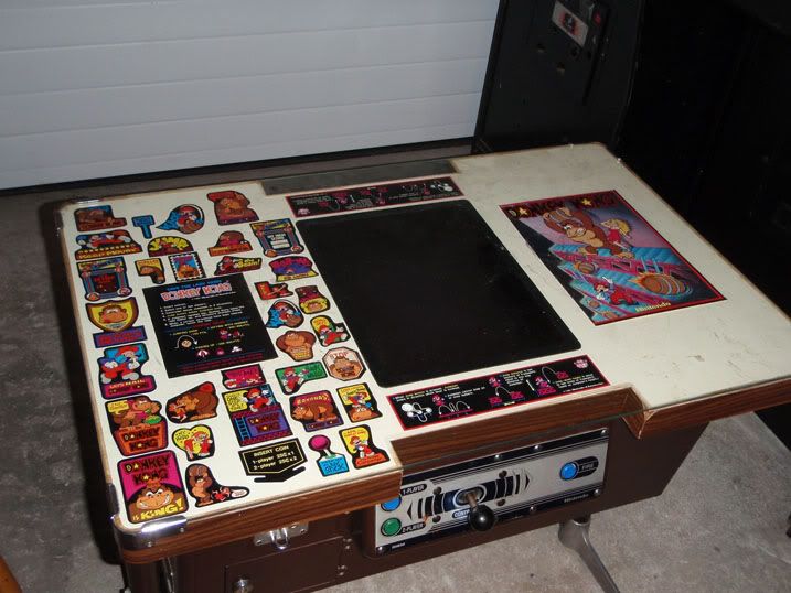

So last night I picked up a Donkey Kong cocktail in a Radarscope cocktail cab
Model: TRS-US

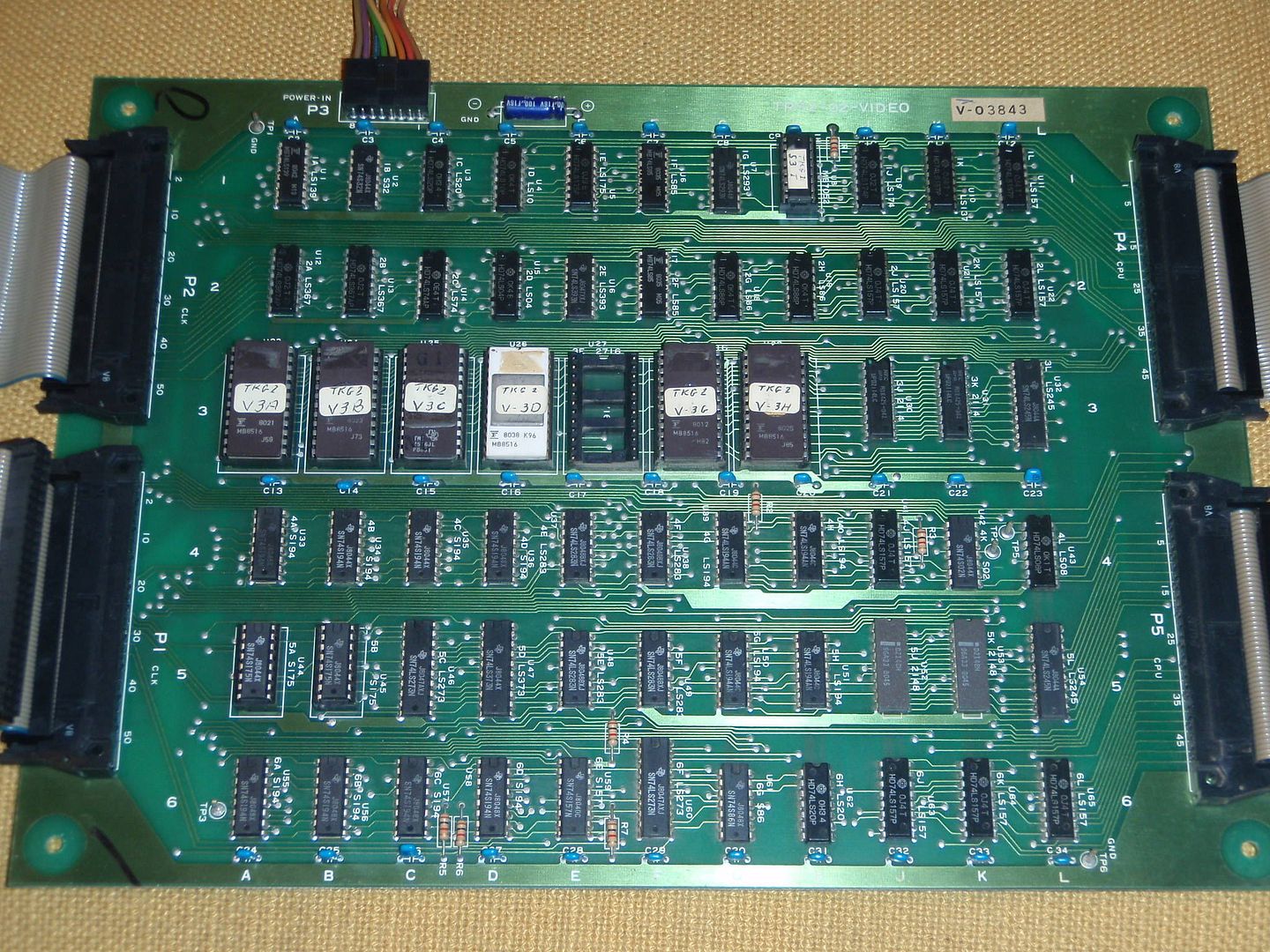

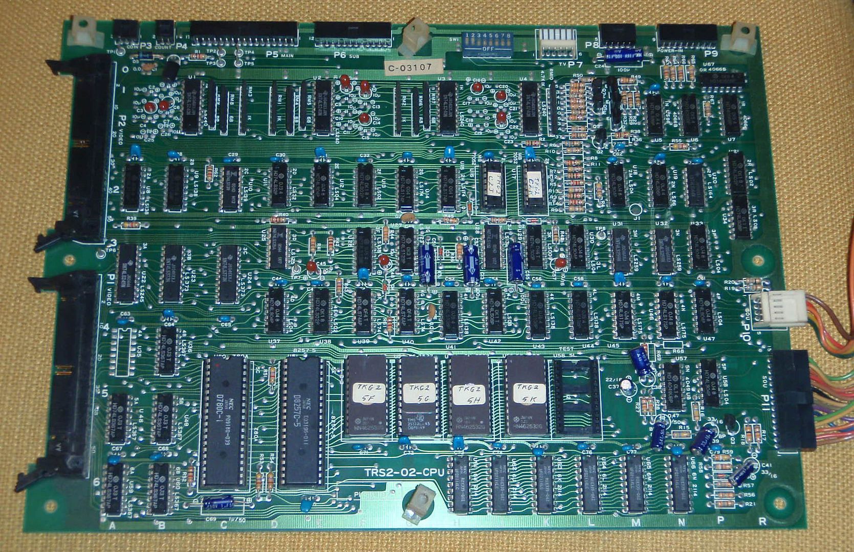

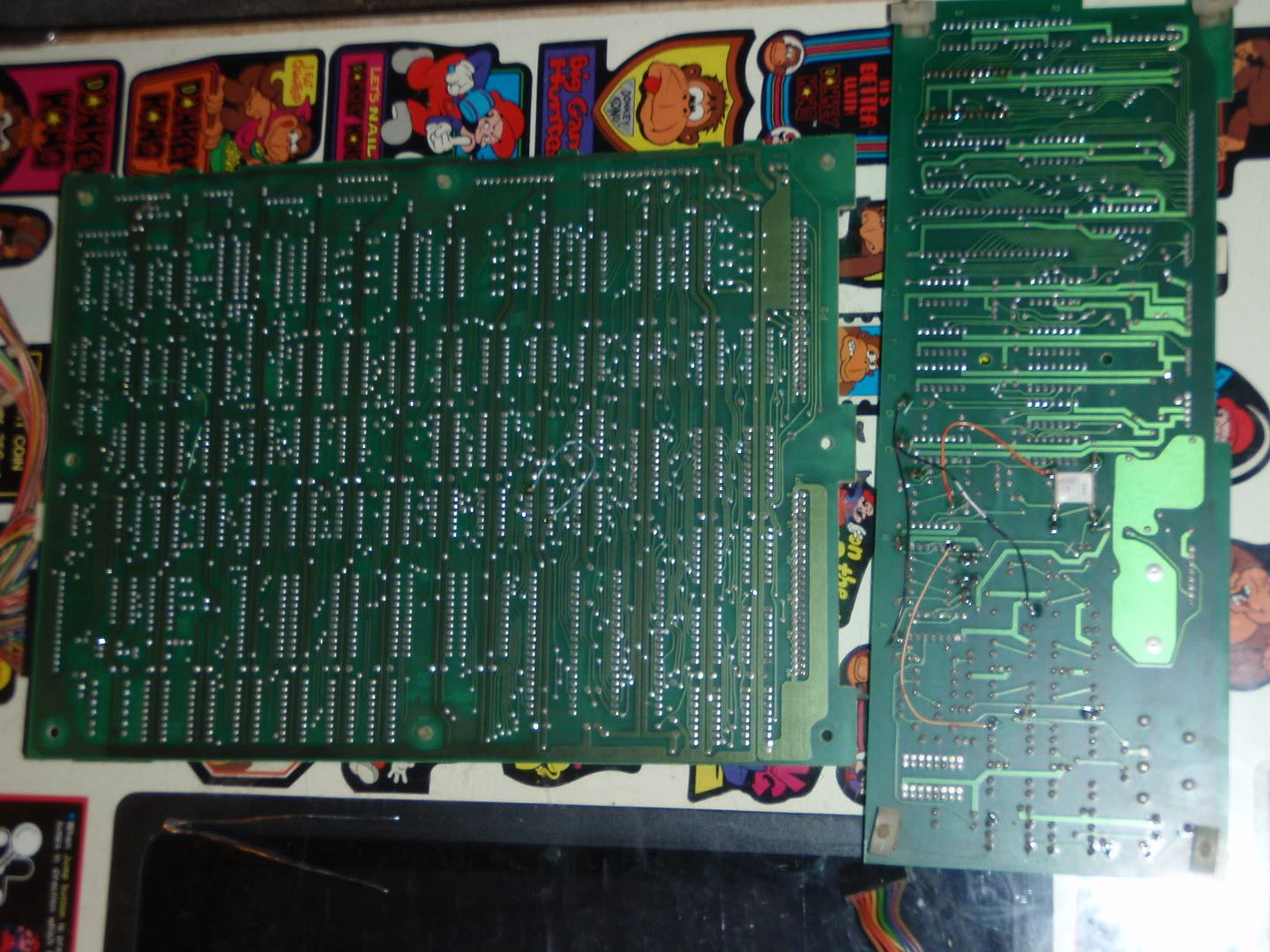

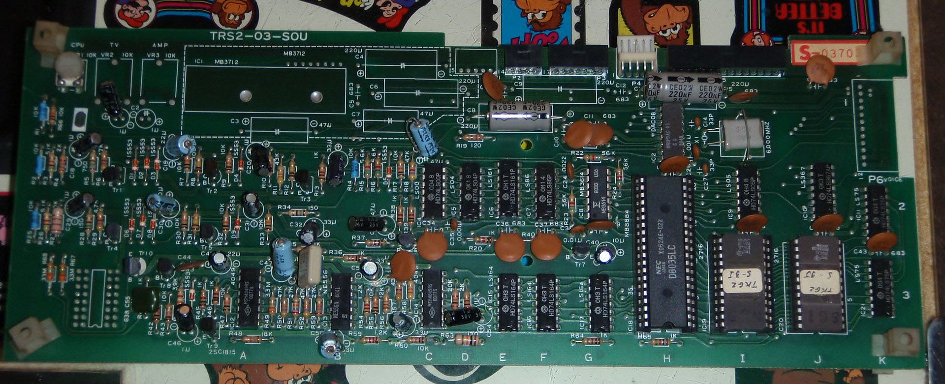

Here's some high res pictures of the gameboards:
TRS2-03-SOU
TRS2-02-CLK
TRS2-02-CPU
TRS2-02-VIDEO
Bottom side of boards with bypass
This link is to a RS repair log for video: http://www.ostermayer.ch/video.html
I'm going to try cleaning all the boards, sockets, and chips. Then inspect the boards closely for any damage of poor solder joints. Man it's a lot of work to mount and unmount all the boards together. My left wrist is in a cast, with my thumb immobilized so it makes working tough.
Can anyone recognize if any socketed chips are missing? I can't seem to find much info on this type of board set

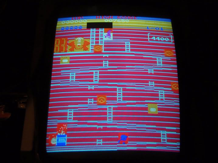

Aha, after cleaning everything and checking a couple solder joints I have fixed the color problem. Moving sprites have issues (4M (CLK) on 4-board set), along with once the jump man death sound is played, it keeps repeating indefinately... any advice on that?

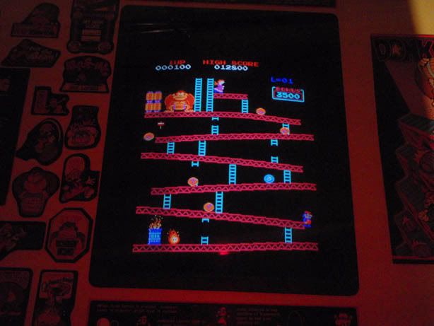

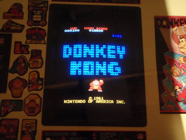

Good news is I got the boards 100% working now
My sprite issues were caused by a faulty socket at 5A on TRS2-02-VIDEO board.
Sound issues were solved by cleaning the 15pin cable header between the CPU and SOU boards

good job ... how did you identify the bad socket? visually?
I decided to reflow the joints of sockets 3A to 3D along with the related 74S194 (2 per 2716), and followed the schematic to 5B and 5A. When reflowing one of the pins moved very easily. Voila detected. Crude but it worked :)
The leg was rusted off on the bottom between the socket and the parts side of the board. I guess my first round of cleaning removed the hint of rust that was present on the board
