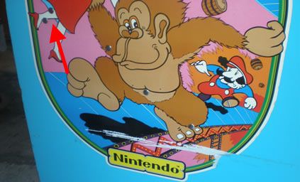

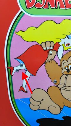

I have several images of cabinets with their original sideart intact, and I've noticed something consistent in the placement of the art (at least on the right side of the cabinet).
It has to do, specifically, with where the two (vertical bracket) bolts always seem to be in relation to Pauline's leg.
I saved all of these when I came across them. Unfortunately, I stupidly didn't copy down where, specifically the images originated, all I know is that they were all threads (at least one of them KLOV) made by people who were dealing with cabinets with intact original sideart.
Exhibit A (this one definitely from KLOV, I just don't remember the thread):
Exhibit B (same spot on a blue):

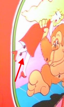

Exhibit C (another red, but I'm not positive this is original. Still the same spot though!):

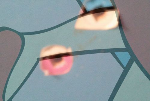

And finally, "exhibit D" from my first DK cabinet (which had never been worked on in terms of refinishing/repainting).
When I removed the bolts from the sides to take out the monitor, I noticed some remaining sideart bits under the bolts:
Look familiar?
In other words, for correct placement, the sideart should be placed such that the top bolt is just a hair to the right of where the top of Pauline's upper leg intersects with the blue part of her dress.

Thats cool you figured out where to put the DK graphics by the those 2 holes, seems to be spot on. Here is a video I made last night apply my inkjet sideart in case you go that route. Note.. has silly 8bit music.. lol
Before I placed my side art on my DK, I searched all over the net. I found "original" machines with the decals in various places. I don't believe there is a completely "correct" placement for the art. I believe that the factory didn't worry too much about the location and that it may have changed over time.
It is definitely true that there is no one right answer and that variations in placement can be found among original machines (which is why JeepGoesBeep shouldn't worry too much).
But it's nice to have a guideline to work from that one can be sure is at least not-wrong! I like this particular placement because of its consistency.
I'm not in a position to give the actual from-top/left measurements, since I don't have sideart yet, but anybody who wants to apply their sideart can place it according to this leg/bolt hole relationship and work backward from there.
