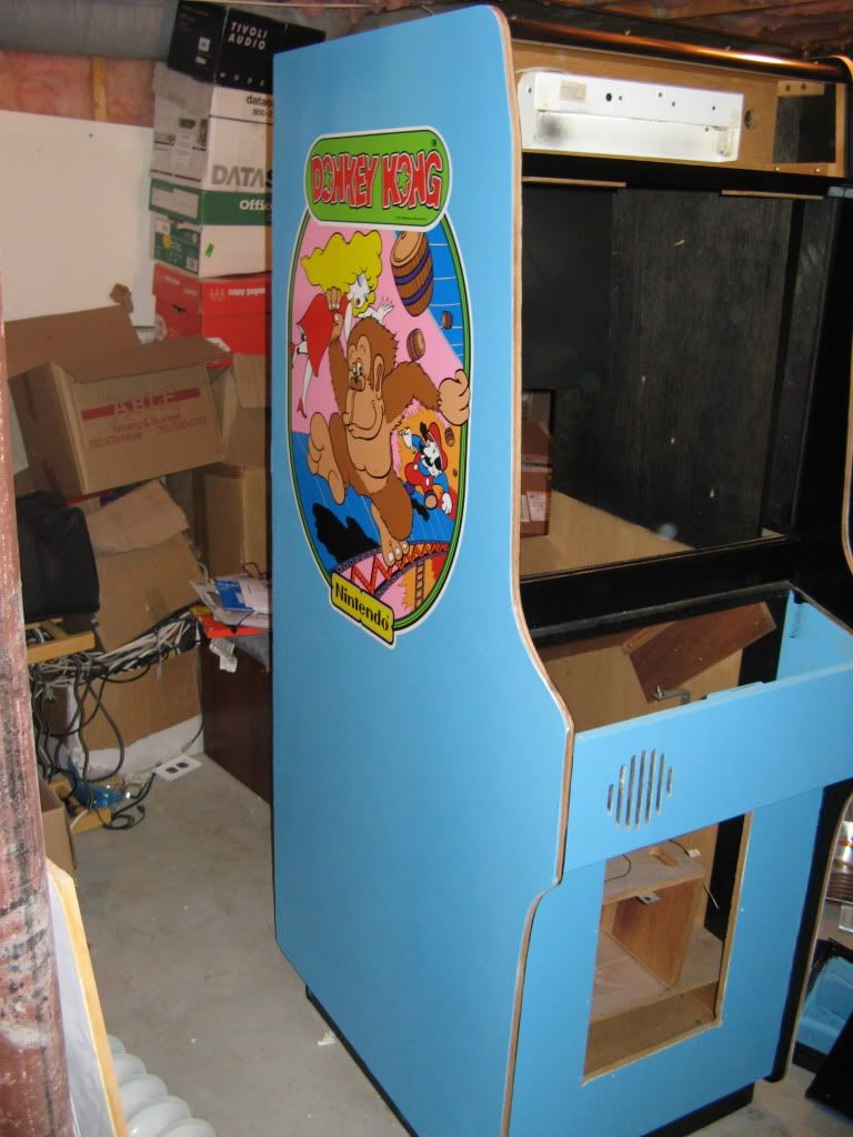

Donkey Kong Restore, with pics!
Proper side art placement for the challenged people.;)
attachment.php
By the way I have another cp with NOS overlay also.
Yep. Looks same as mine (see my pic)...about a quarter inch (maybe 1/8th) lower than center...thanks for the confirm!
Did you clean the paint off of the CP positioning plate before you put it back together? Looks like you didn't remove it before painting. If you didn't, pull that CP off, remove the 4 screws that hold it on and get out the paint stripper. All those parts in the CP area, including those plywood blocks the cp latches mount to can and should be removed before painting. As far as the side art placement, I always mount it higher than the flyer shows. The cabs are short enough the way it is.

No, the metal plate attached to the back of the speaker grill. You painted right over it. 4 screws, remove it, clean off the sloppy blue paint and any rust that has formed on the back side.

I think he's talking about the metal piece that sits on the same side as the speaker grill. It pokes up slightly and sticks into the groove (lip) of the control panel. Take off the CP and look at the groove, then you'll see what I'm talking about :)
