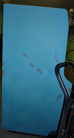

I also got the cab sanded quite a bit. It's crazy how much you can sand the blue paint without stripping it off completely...been able to just sand away a lot of the scratches and scuffs. I have a pretty smooth surface, just need to sand down the bondo areas and give it another going over and it should be ready for vinyl soon.
You can see that I filled the bolt holes that aren't necessary. Considering sinking the bolts for the upper bracket as well so the side art doesn't have bolts poking through, but it won't be the end of the world if I do, since it was how they did it originally.

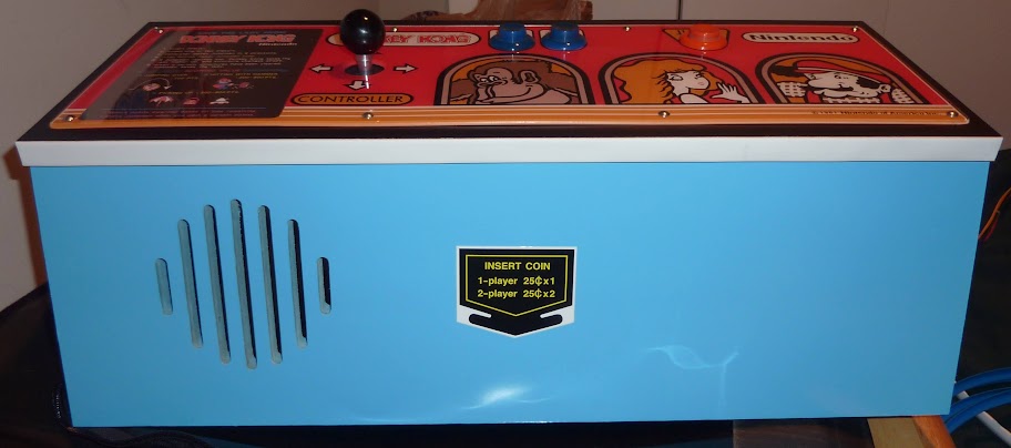

Front panel is vinyled as well, came out pretty good, no issues going over the gap where the coin door goes. Obviously not much to see here, but a picture anyways:
Probably get the other side done in the morning, think I need a break for tonight.
Well applying the vinyl on the other side went much better...but then putting on the side art, I somehow managed to scrape the vinyl :001_scry: On top of that, the side art went on TERRIBLE, had bubbles everywhere. I ended up just pulling it off and I'll have to order a new piece. So frustrated with things at this point.
I put the cab back together, at least it looks good from the front:
