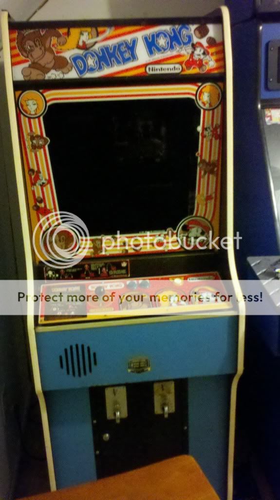

Just got a DK machine (finally!), so starting this thread to show off the restoration as I go.
In this thread, all thumbnails are "clickable" to see the full-size version.
Pics of the machine so far:

That is a very nice machine. Has anything been done to it before that you can tell. If not, it's tough to find a DK that has not had the horizontal monitor mounting holes drilled in the side. Nice!
It's almost entirely factory stock -- the jump button has had the "button" part replaced with something white (the button's "base" is still the original orange, though), and the marquee light fixture has been replaced with two screw-in incandescent fixtures.
Other than those two things, everything I can find about it is absolutely original.

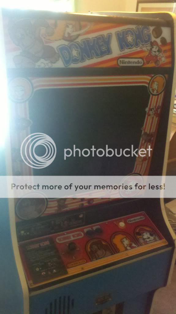

It's pretty beat up on the corners, it *was* super-dirty, and the side art needs replaced. I'll get it fixed up, but this thread won't be nearly as interesting as some of the more impressive restorations where the cabinet was in much worse shape.
EDIT: it's unfortunate how awful my phone's camera is -- the graininess really covers up a lot of the flaws and makes it look a lot better than it is. Not a bad machine by any means (not like my Neo -- that was an adventure), but not great either.

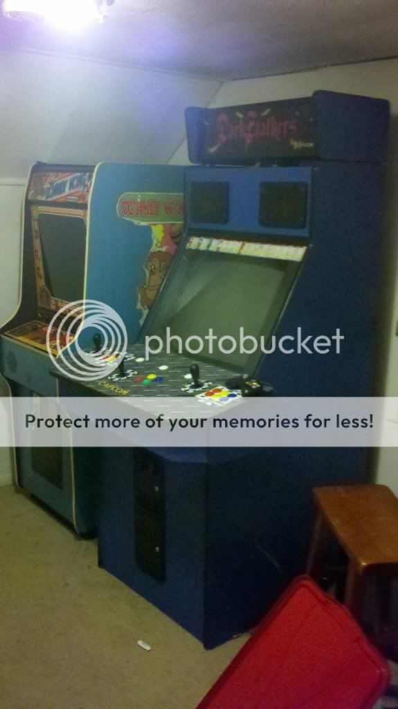

The DK cab in its new home! This is where it will be, save for those times when I pull it out to work on it.
Too bad the Neo Geo and the (empty) CarnEvil are surrounded by bins of tools and such right now -- had to clear a path for the DK to move in, and kind of just tossed it all to the side. Thus, they're not in the pictures.

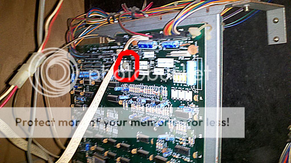

Audio fixed!
As it turns out, I just needed to adjust the digital sound potentiometer on the main PCB. I believe it's called the "V2"?
In any case, here's a photo of the main PCB with the pot that one needs to twist circled in red, just in case someone ends up with the same problem I had (only jump, pound, and walk sounds present; all other sound, music included, was missing). It's not going to solve every problem, but it's a solid first step to try.

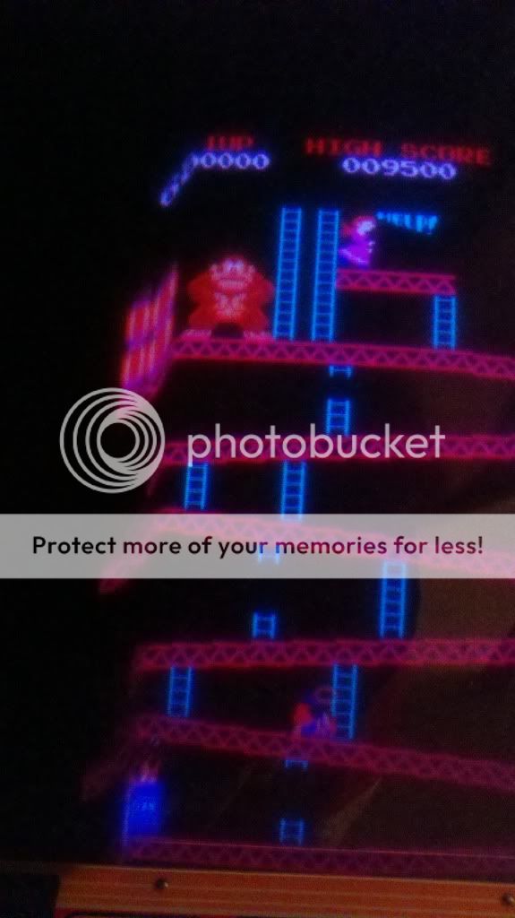

Fresh issue (now added to list).
It had been there since I got it in some capacity, but now it's gotten significantly worse.
There's "drooping" on the left side of the screen. I don't know what it is, but it's possible that it might go away when I install the cap kit. It's listed as a sub-item of the cap kit until that's been completed.

Play around with the sync on the monitor and the board. You might be able to solve that.
If not, Cap kit will prolly fix it.
This is very common. It's the horizontal screen position pot on the PCB board[b/]. Turn it back and forth a bit and that typically fixes it. Once you get the screen positioned correctly, leave it alone and you should be okay (mostly).
Good to know that it's an easy fix. Got a key in today, so if it fits, I should be able to get started working on it in earnest. I'll find that pot and adjust it first thing
When you open it up you should see the PCB on the left side of the cabinet, held in place by 2 metal "L" brackets. The pots should be on the left PCB (that faces the left side of the cabinet) right at the top. There are two of them there. I can't remember which is which but they move the position of the game on the screen (Left/Right and Up/Down).

I got my key in yesterday.
That fixed it! The horizontal pot is the one closest to you if you're behind the machine, just for future reference.
