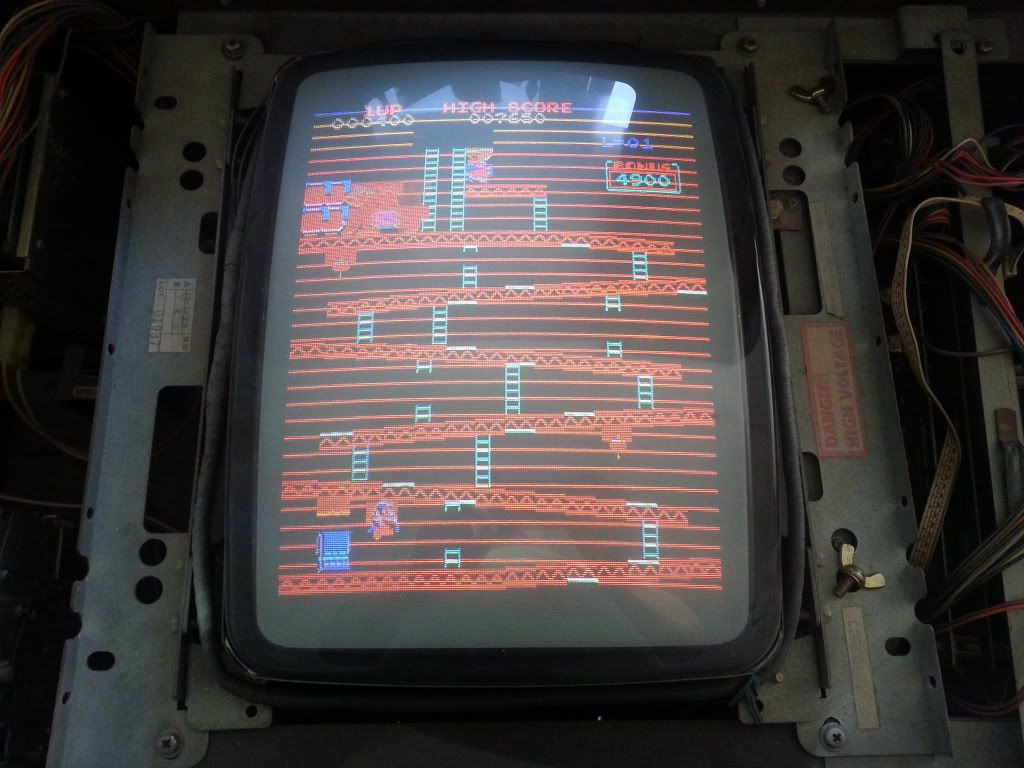

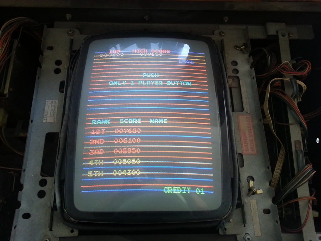

Got a Donkey Kong cocktail in the shop that was said to "freeze" at times. When I powered it up, I got this:
I tried reseating chips, but haven't looked into anything else yet. This is a 4-bd set...
Bad eprom sockets. I had this issue once.
EDIT: Also, I see bad eproms. Specifically the 2716's in row 4 on the clock board. See here (from the braze page):
Bad 7E (which is 4R on the clock board)
The freezing is likely due to another bad socket somewhere too. (separate issue)
PM Darthi8nt on this - he's run into this before.
