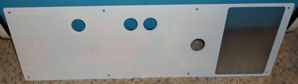

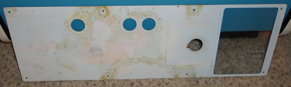

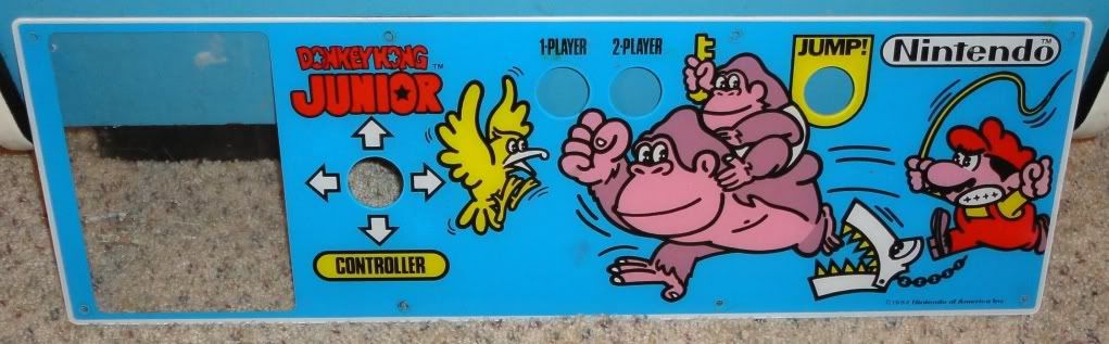

Here is a picture of the front and back before I started:
As you can see, it's dirty but not in too bad of shape. I have had to fix much worse. I am using the same materials I used in my other Donkey Kong Control Panel build with one new item.
500 grit sandpaper
1500 grit sandpaper
Novus 1, 2, and 3
Goo Gone (***new to my process)
Wet rag
Dry rag
Power Drill with buffing pad attachment
I gave the CPO a once over on the back with a wet rag and then with the Goo Gone. It worked out great. I used Goo Gone because it seemed least likely to cause any damage to the CPO art. I did a once over on the front with the 1500 grit sandpaper to give it a nice, smooth surface. I then hit the problem areas (cig burns, deep scratches, and CPO underlay viewing area) with the 500 grit sandpaper. I wiped the front down with a wet rag. Then I repeated the use of the 1500 grit sandpaper.

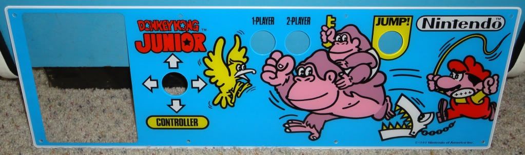

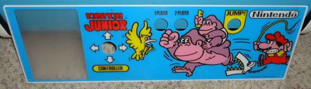

Here is how the CPO looks currently:
That's all for tonight. It already looks a lot better. Next I will polish the CPO to a nice shine. I will post up new pix as soon as that part is completed.

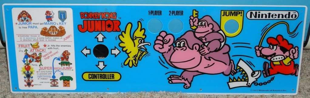

Today I got to work on finishing the CPO. I noticed from the pics I posted yesterday that I had missed a cig burn in the top left corner (above the O in Nintendo) so the first thing I did was remove that. I then polished and repolished and polished again. I made lots of use of my power drill until the battery died. I then did a final polishing by hand always starting with NOVUS 3 and following up with NOVUS 2. After the polishing was to my satisfaction (about 2 hours worth of work), I finished the CPO with NOVUS 1. I took a picture of the CPO after all this was complete.
I then installed a new repro CPO Instruction Underlay Card made by OldTimeToys. It looks great. This is the best and most thorough CPO restore I have done yet.

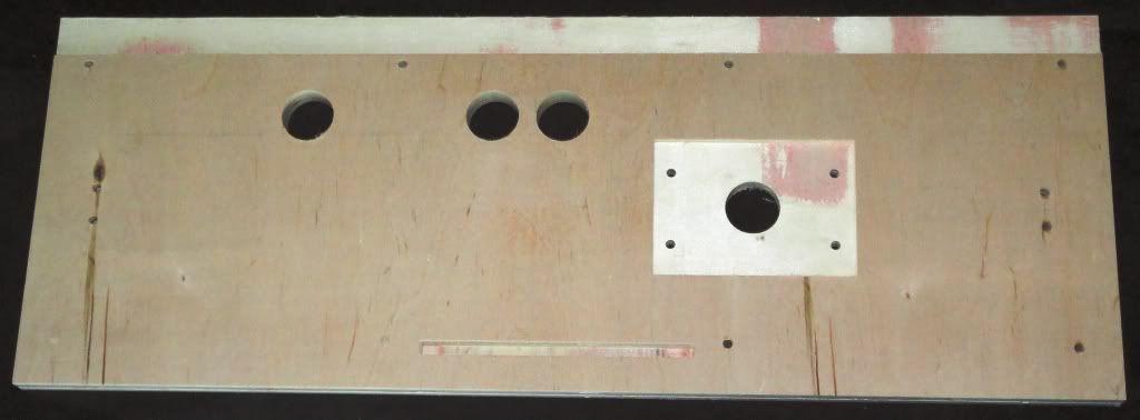

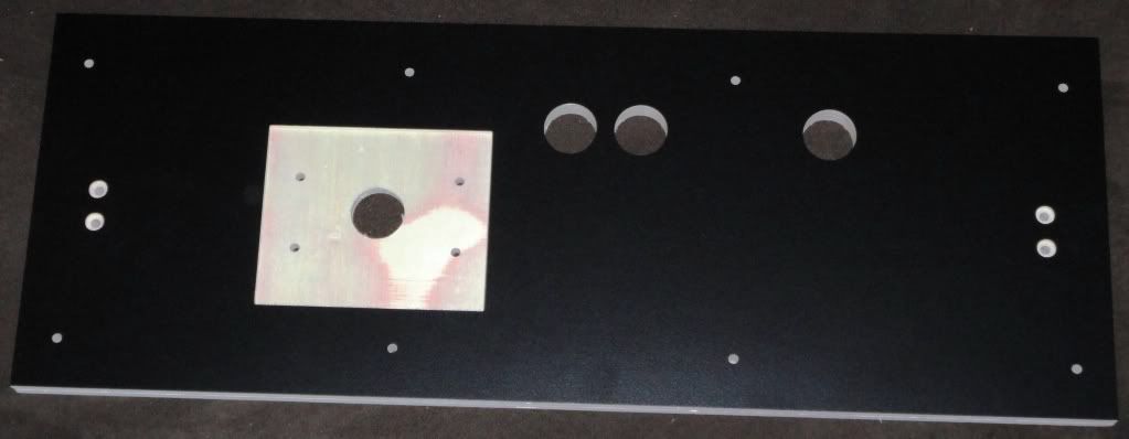

First, here are pix of the repro cp wood plank made by jeff412:

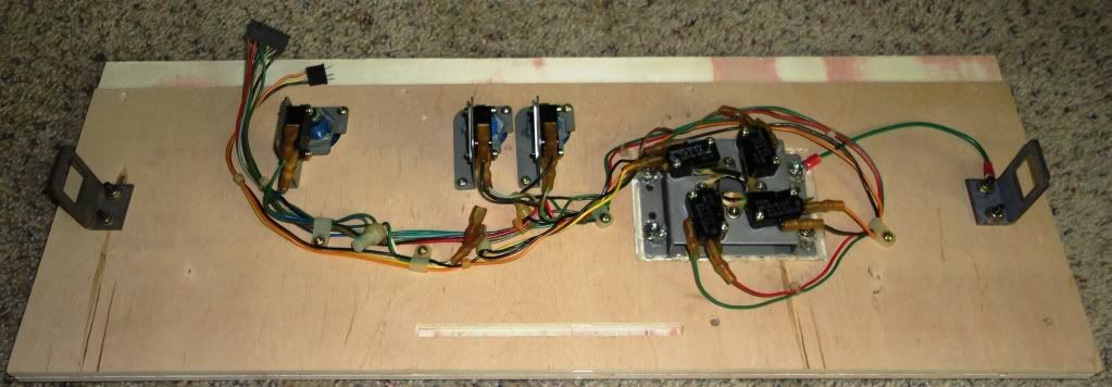

Here are pix of the underside of the control panel populated. The buttons seen in the pictures were just place holders for me to mount the button switch housing. The buttons that are going on this panel should arrive this week.
Like I said, the hot glue is unsightly but won't be noticed by anyone but me.

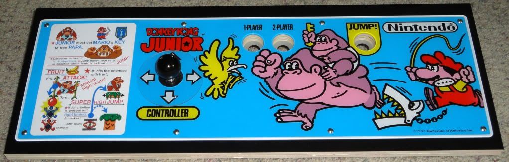

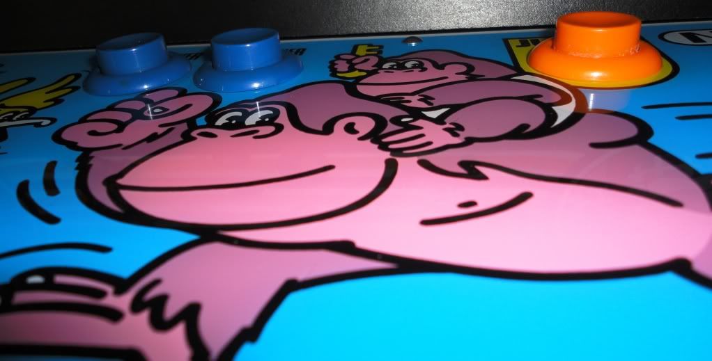

Got my restored buttons from Tighe today and I have finished the CP. Buttons and T-Molding has been applied. I will post final pictures tomorrow after I have tested it with my DDK board. It looks great.
Tested the completed control panel today and it works better than my original Donkey Kong control panel 9I'm going to have to do something about that when I restore my DK CPO). Here is a nice close up angle of the newly refurbished buttons by Tighe...

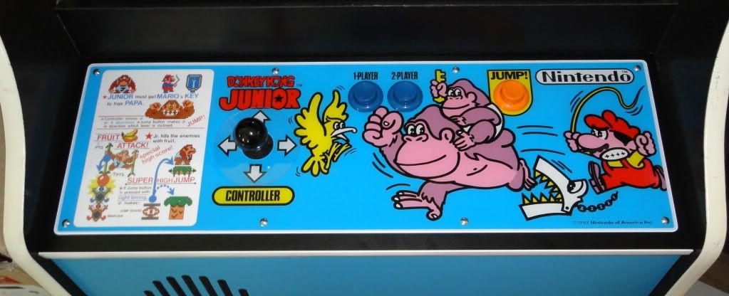

And here is a picture of the finished control panel as it looked while installed in my DK for testing...
I think it utrned out great. I gotta save some money to get some more wooden CP reproes from jeff412 (my last one has a broken corner in the laminate) so I can make the last control panel I need for my universal Nintendo cab...Popeye.
