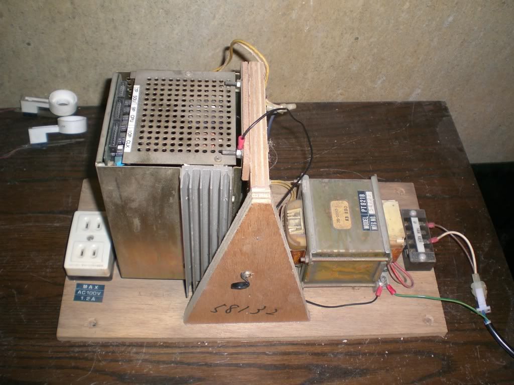

Well after 2 days of working on game I finally found out I have a Sanyo 20ez from and old Dokert post help. (i thank you) Now I need to flip the screen vertical and make sure this monitor is all set to go with excepting a DK jr board. It now works with Wonder boy so that's good. I now need to know what these 2 things are in my cabinet and should I keep them in when I remove wonder boy board. Yes I know, noob.

Picture 1 is a Nintendo transformer. You need to keep that in order to feed the correct 100v to your 20EZ.
Picture 2 is the switcher being used by your Sega board. You will want to replace this with a Nintendo power supply, or a newer switching power supply with a DK adapter installed.
Here's a picture of a DK power supply and transformer assembly. As you'll see, the transformer is the same, but you're missing the 'other' piece of the puzzle, the power supply.
Picture 3 is the inverter board. Nintendo boards put out "inverted" video kinda like looking at the negative on a piece of film. Sanyo EZV20 monitors accept inverted video. When You wanted to hook up a JAMMA board or other common board to the monitor, you would simply use the inverter board to reverse the colors so the Sanyo monitor would display correctly. If you get a DK game board, you won't need to use that inverter board anymore.

Isolation Transformer = A transformer used to isolate devices from transient grounds. Your transformer performs a TWO FOLD function. Function #1 and MOST IMPORTANT- it is an isolation transformer. If you plug that monitor directly into a wall it will blow up. I know that looks like a house plug on the end but TRUST ME. THAT IS NOT WHAT IT IS THERE FOR. DO NOT PLUG THAT INTO YOUR WALL OUTLET. Function #2 - voltage reduction. Sanyo EZV20 monitors run on 100V and NOT 110-120V like we have here in the US.

Yeah, I'm going to guess that the pair of white wires at 10pm on this picture are going to a similar 2 outlet fixture like my picture has. His monitor is likely plugged in there.
Mongo's right - never plug a Sanyo 100v monitor into a standard household outlet. You'll fry some components on the chassis.
