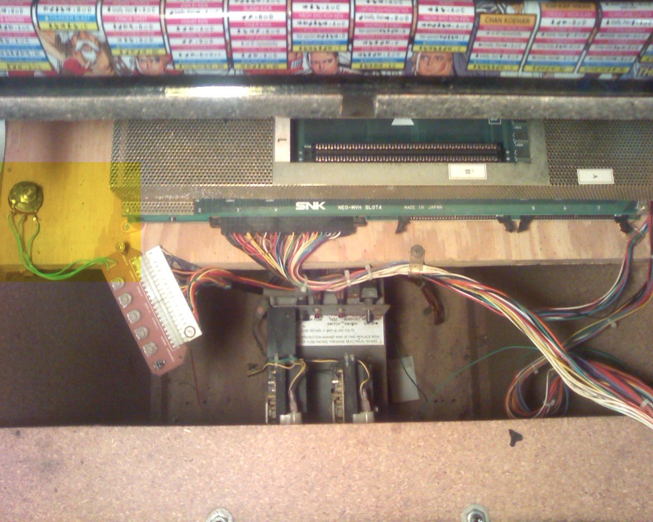

Rather than wait for a pot from Bob, why not stop by you local electronics supply store (maybe radio shack if they have it) and replace the pot with a heavy duty one. Check out what I did with my MVS:
The hoizontal postion pot was flakey so I replaced with a heavy duty pot and wired it right into the board. Not the pretty, but it is on the inside, and the cabinet isn't original (4 slot in a 2 slot cabinet)
