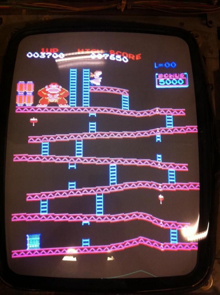

timahtimah New member VAPS Joined Aug 24, 2010 Messages 65 Reaction score 0 Location Seattle, Washington Oct 2, 2012 #1 Donkey Kong has this weird pinch problem that cannot be adjusted out. Does anyone happen to know if it just needs a cap kit, or if it is a problem with the board?
Buffett Well-known member Donor 2012-2013 VAPS Joined Mar 12, 2010 Messages 10,991 Reaction score 263 Location Manassas va, Virginia Oct 2, 2012 #2 my bet is a cap kit would fix that issue. if it has never had one then it is over due for one. you could try and adjust the H-Hold on the chassis. Peace Buffett
OP OP timahtimah New member VAPS Joined Aug 24, 2010 Messages 65 Reaction score 0 Location Seattle, Washington Oct 2, 2012 #3 Tried all the adjustments, so I think a cap kit is in order, thank you for your input.
That80sGuy Well-known member Donor 2011 Joined Jan 11, 2009 Messages 5,354 Reaction score 147 Location Georgia Oct 2, 2012 #4 Don't forget to check the 20EZ flowchart stickied at the top of this section.
local413 New member Donor 2011 Joined Sep 21, 2008 Messages 3,441 Reaction score 34 Location Longmeadow, Massachusetts Oct 3, 2012 #5 But don't forget it's an 18" Sanyo or sharp in a DK cocktail.. Very close to a 20EZ but has some differences.. You can buy a 20ez cap kit though That80sGuy said: Don't forget to check the 20EZ flowchart stickied at the top of this section. Click to expand...
