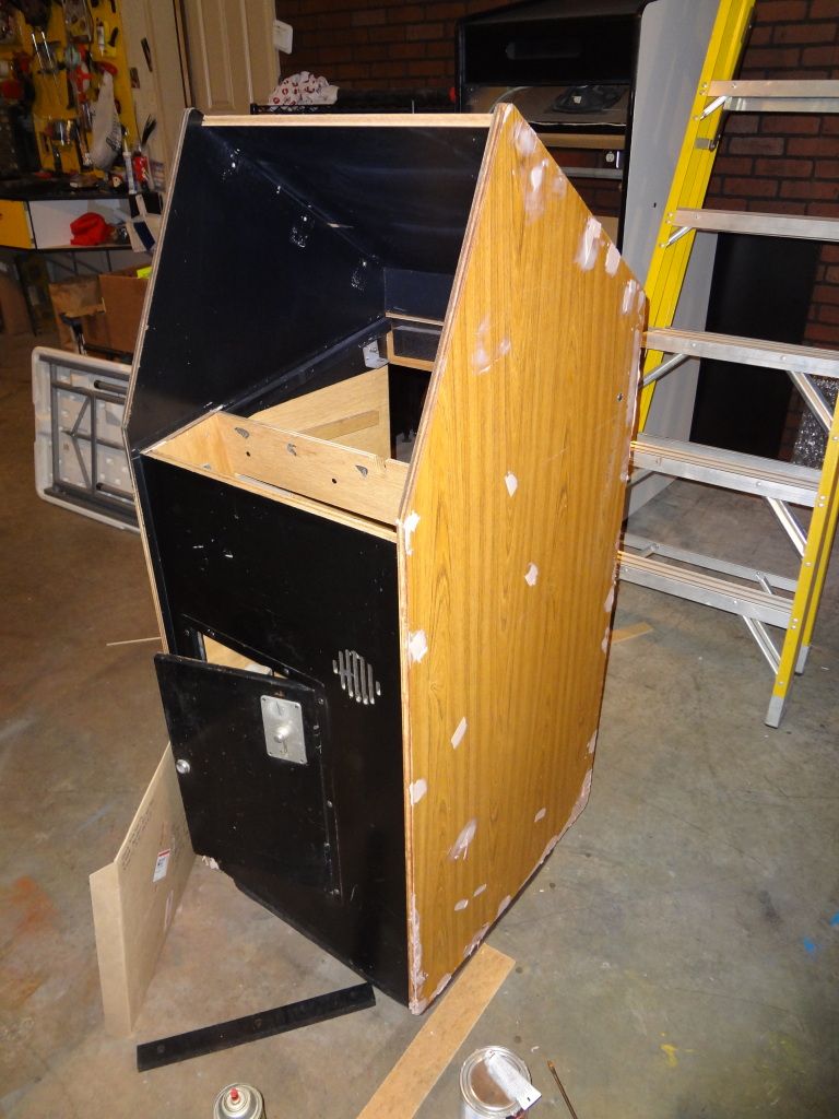

A few months ago, I decided that I better restore this cab. I first removed the brackets and fixed the bolt holes.

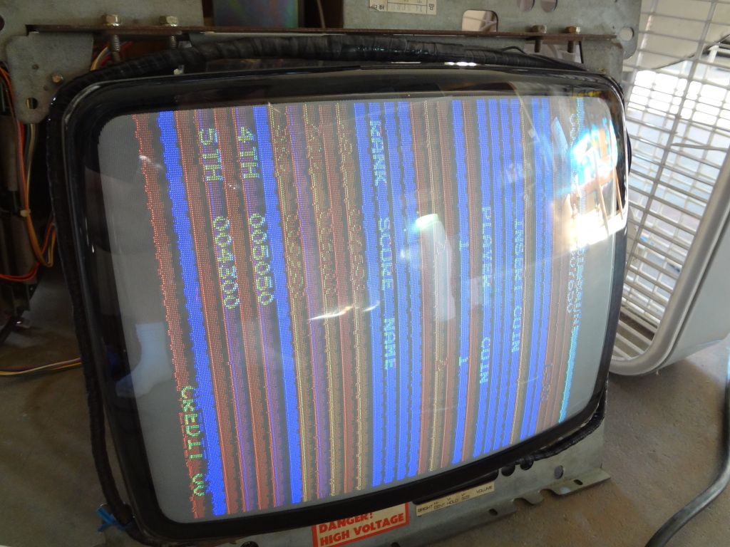

Then I recapped the monitor, but was getting a weird screen:

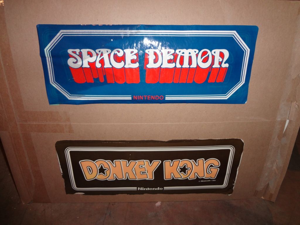

I found that I had a bad chip at location 5K (more on that later). Next I was peeling the original DK sticker off when I noticed a perfect Space Demon marquee stuck behind it.
So then I realized that this had been a factory conversion from SD to DK which was cool. Since I didn't feel like sourcing a SD board and other SD parts, I decided to just restore it as a DK.
Well, earlier this year, I had been bondoing and sanding and bondoing and sanding this cab when I'd get little snippets of time. After the 3rd bondoing session, I pushed it out of the way when I needed to clean my garage and just let it sit.

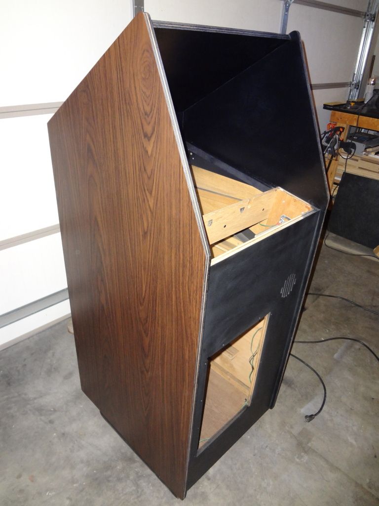

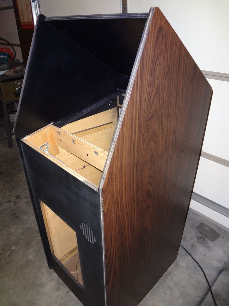

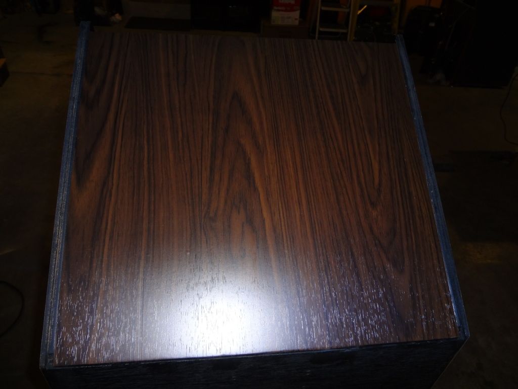

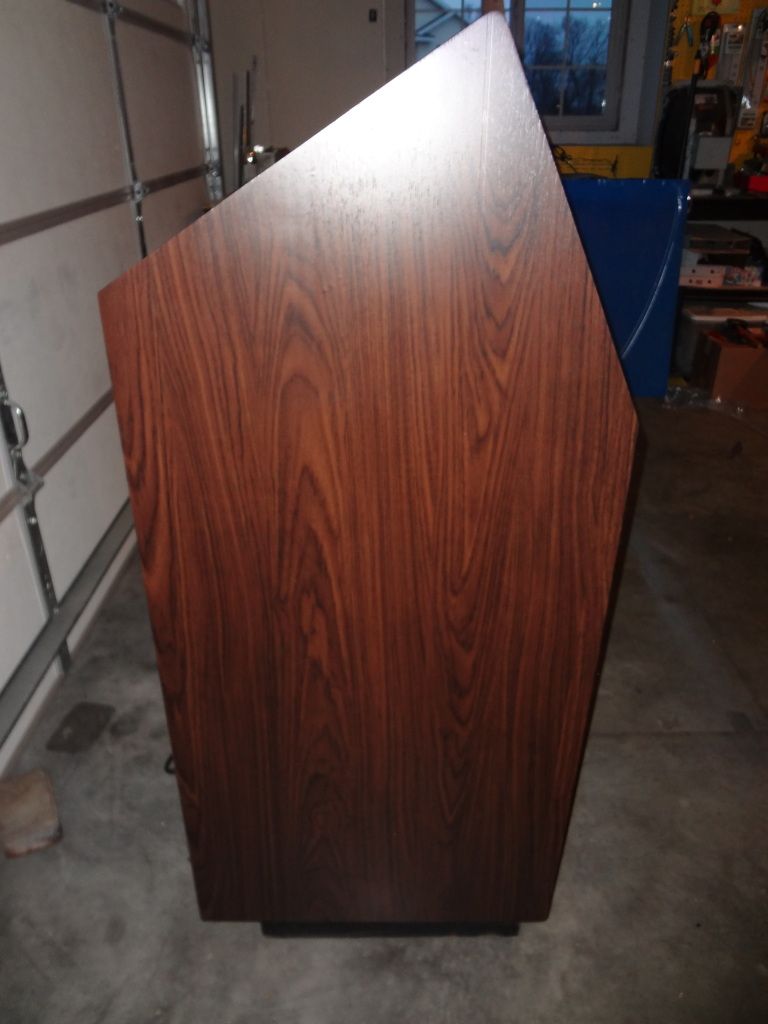

Fast forward to this past weekend. I decided it was time to finish this little bastard up. A few months ago, I purchased wood grain vinyl from a shop in Hong Kong. I decided to go with a darker walnut print, which was closer to the later DK cabarets. I started with the roof piece. I lined up one edge, then laid it down from left to right, which worked out well. I then trimmed the overhang on the right side.

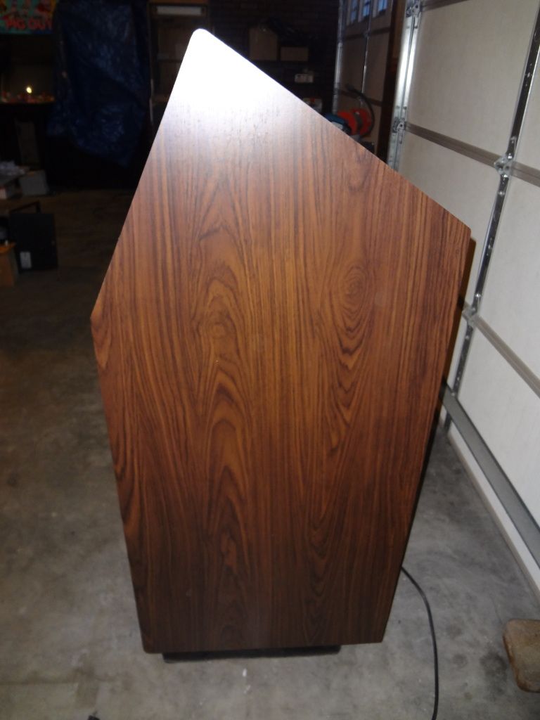

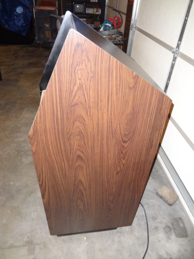

I then moved to the sides. The company only sold it in 24" widths, so I really had to be careful lining it up, as I only had 1/4" of overhang on either side, for a length of over 4 feet. After lining it up, I taped it in the middle and put it down from middle to bottom, then from middle to top. I did this on both sides. I then trimmed it. Here is how it looks so far:
WOW WOW WOW WOW!! That vinyl looks amazing! great job applying it! I really need to get to repainting the black on mine and installing the NOS marquee.

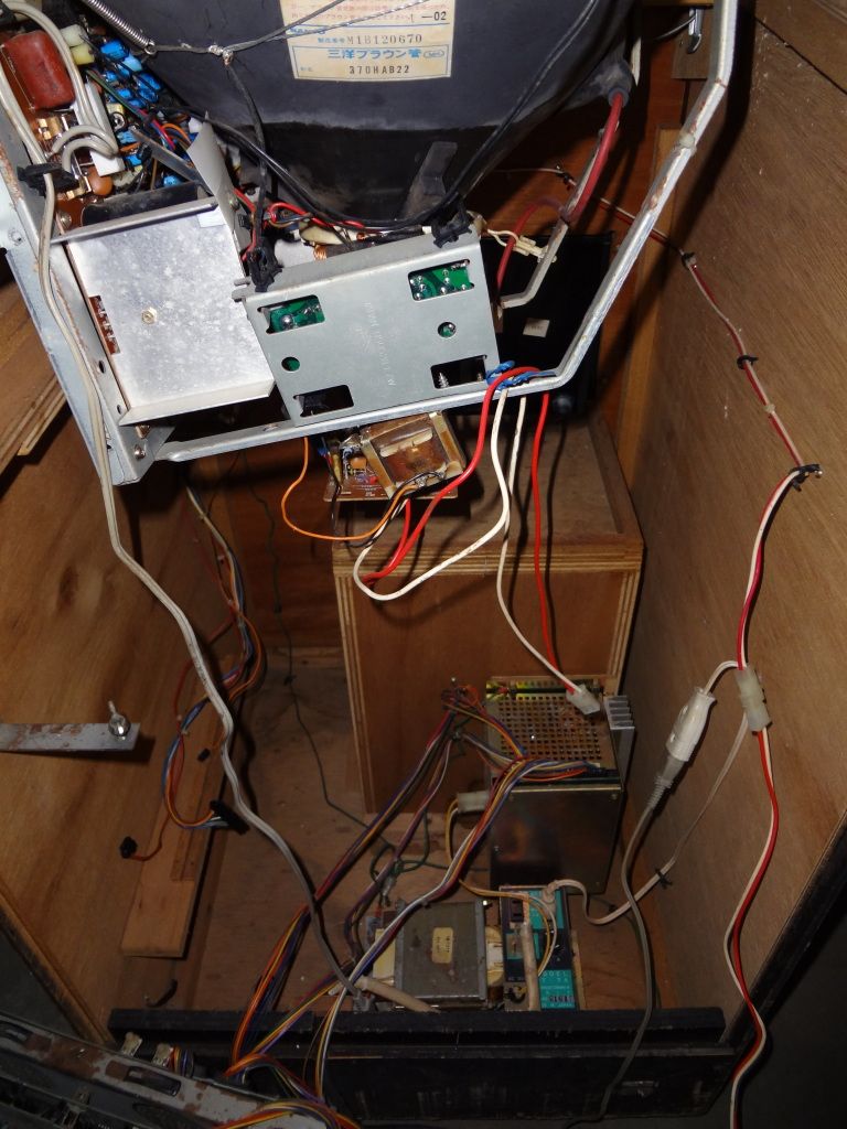

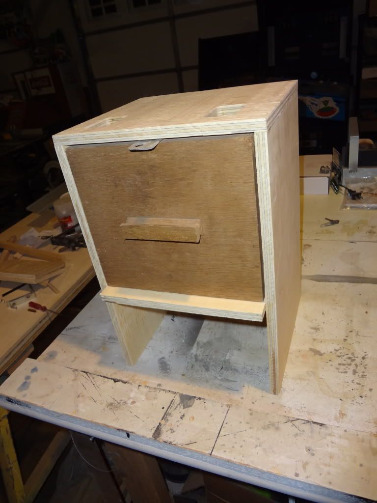

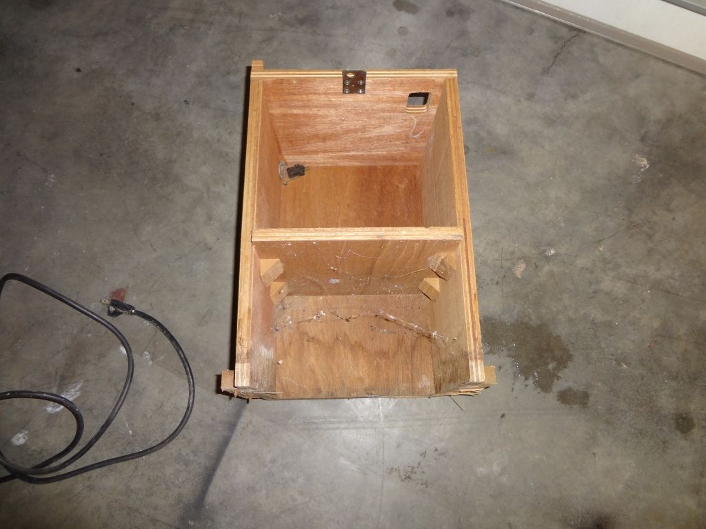

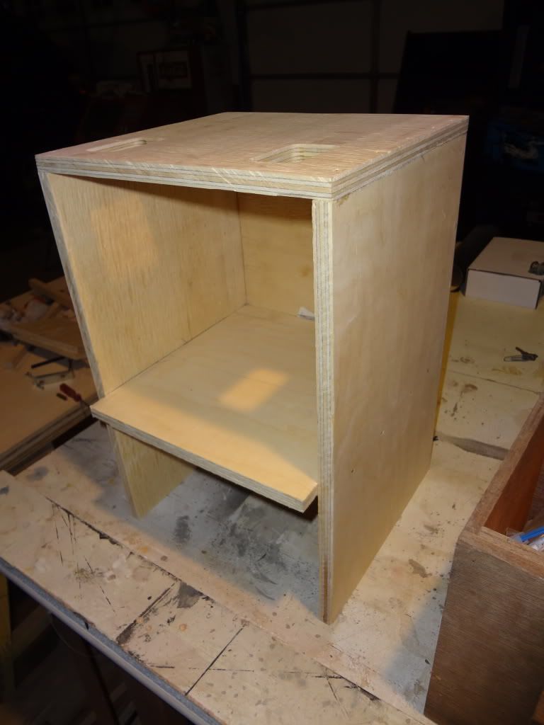

I kinda got ahead of myself a little. I forgot to tell you about the inside. Well, from building my custom DKjr cabaret, I knew a little of what I was in for inside this cab. These cabs came with a 'coin tower' that was basically a large open face wooden box on a stand that was screwed and glued to the bottom of the cab.
The open face was towards the front of the cab, behind the coin door and held the coin box:
The sucky part was that in order to remove the coin door, this tower had to be removed first. Because they also used wood glue to attach it to the floor, removing it was even more sucky than the fact that it had to be removed. Eventually I got it out:
Well one other weird part of the design was that there was a large void that was formed under the coin box shelf, between the 'legs' of the tower, which were really just the tower sides that extended to the floor. Since the back of the tower was where they mounted the gold box power supply, it had a solid panel that also ran all the way down to the floor. As the void was facing the front of the cab, it was completely blocked from view and from access by the lower part of the kick plate, under the coin door. Basically, whether by design or not, the void is inaccessible from all sides while the tower is mounted in the cabinet.

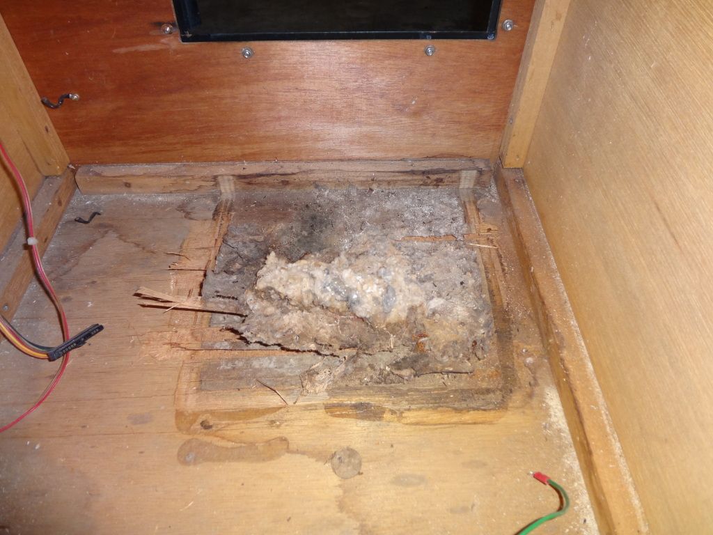

Well at least inaccessible by humans. When I removed it, here was what I found where the void had been:
Do you realize that many people would have just moved this machine into their homes, without ever knowing what was hiding "in the void"? Think about that the next time one of you lazy bastards decides to just move that skanky game from the barn you found it in directly into your game room without wasting time on the pesky cleaning part. Disgusting.
Anyhoo, the rat/mouse urine had penetrated so deep into the wood that the whole upper ply layer basically peeled/crumbled off in several flaky pieces, giving me a blank surface to sand and clean up, making it look like a new floor.

How did the mice even get in there if there's no way in?
I said inaccessible by humans. On either side of the tower, between it and the kickplate, there is about a 5/8" gap. You can't see it from the front as the shelf lip overhangs an extra 3/4 inch to keep coins from falling down there, effectively blocking the view of the void and the gaps from the top.
Ah. Yeah I would definitely shit there if I was a mouse.

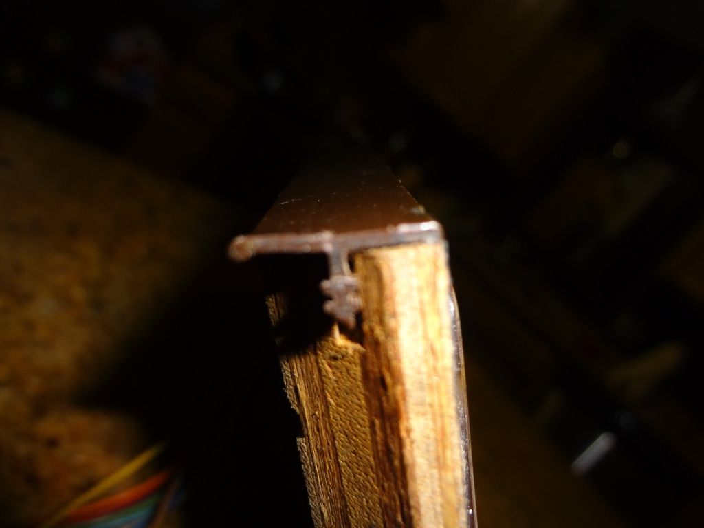

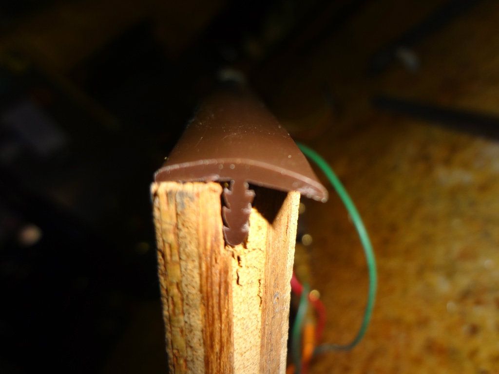

And Tighe kills another one. Well, moving on, I still have to get some brown T-molding for this cab. I found a source for a decent replacement molding (if not an exact match for the original) online. The original brown molding was flat in profile and semi-gloss in finish:
I found the right size and color of molding online, but the profile is slightly rounded and the finish is satin:
Side by side comparison:
I am fine with it and would be happy installing it on this machine, if the company that sells it didn't require that I purchase a minimum of 250 feet. Until I can get at least 10 people to commit to buying a machine's worth, I just can't justify buying that much at one time. Until then, I will keep looking or hoping Bill reproduces it within the next month.

Well the conversion was done at the factory. Nintendo's Space Demon was a stinker, Donkey Kong was a huge hit. Instead of shipping out a game that would have either sat there or been shipped back, they decided to convert and ship out a game that was a sure winner. Either that, or the demand for DK machines was so great back in '81 that they decided to just rebrand every machine that they had laying around to cash in. Same concept as the Radarscope to Red DK conversions.
