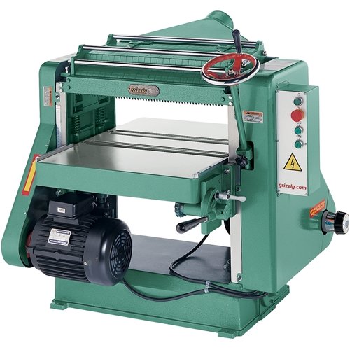

All you really need is 3 phase power and a 24" planer (not mine, pic is hot)
