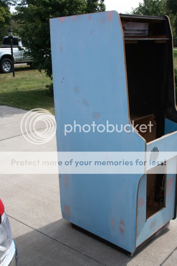

These are some photos of the first day tear down of the DK I picked up Sat.
This game was thick with dust and smelled of elderberries and rabbit crap. :)

I still need to find a coin door. I haven't thrown out the old one yet... but I am bummed that nobody has a door. I got lucky no laminate on this cabinet. I am going to uses stripper to clean off all the paint...then fill with bondo and try to tighten the cabinet up this weekend.

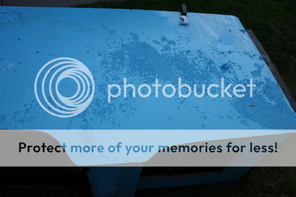

easy paint removal
Man is chemical stripper worth it. It still took about 3 hours. but most of the time was spent petting the dog and watching the kids play.
Later tonight if I don't fall asleep will come some bondo, Tomorrow sanding, priming and painting the cabinet with a couple coats of DK blue. I hope that 2 coats will make it really smooth, but I have a gallon so it may get 3. I wish I had a better air compressor... Mine can not keep up. It is only an 8 gallon. It take quite a while to do a cabinet. I may just have to go out and get a bigger air compressor.... Anyone have a good idea of what size to get?

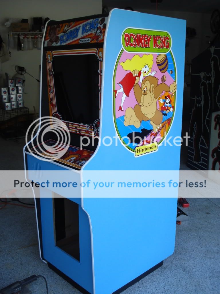

almost done.
I need to get some board work done. I fried some of the audio on the main board after a mistake when I capped the audio board.
still need to cut the some black paper for inside the cab, and either fix or replace the board I screwed up.
Got the DKII KIT into it can play without audio...
Expensive mistake. up next is space invaders.
finally in the basement

Yep I primed. I am much better at using bondo now. At least the coin door looks good. the next restore will go better.
Looks good. The only thing off that catches my eye is the t-molding on the top not going all the way to the back of the cab, other than that looks like a really nice machine. Good work - Barry
