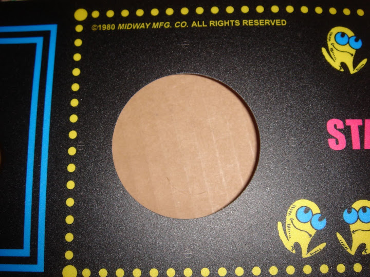

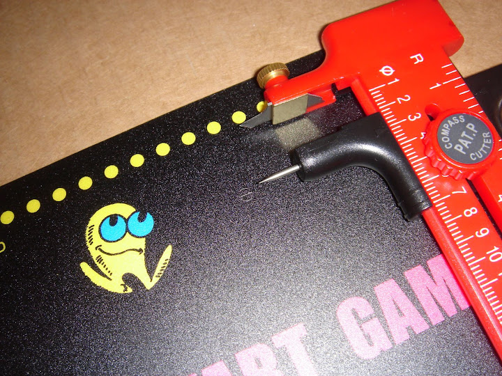

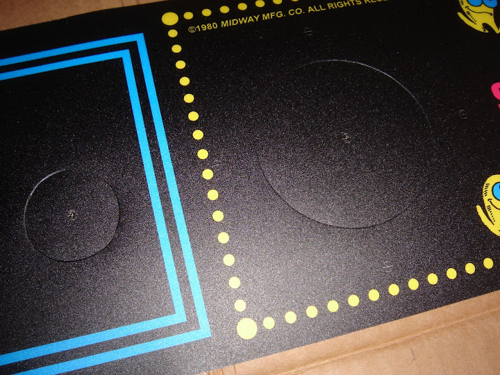

I found using an exacto knife works far better then a box cutter. Scalpels work equally if not better, if you can get ahold of one.
You can buy a compass cutter from a crafts store and cut perfect circles. I got this one at Michael's. I don't remember how much exactly, but I think it was pretty cheap:

All the hole edges are covered when the CP is reassembled. Using a sharp knife (as described above) after assembly should give you perfectly acceptable results.
