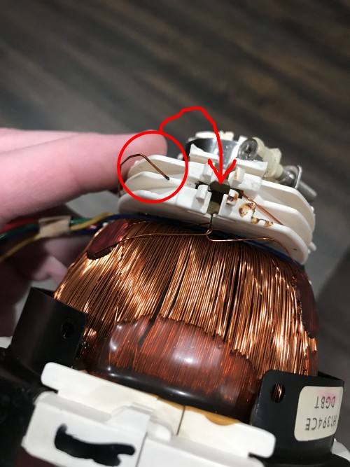

Here is a picture of all my extra yokes right now. The 3 on the left are original red tent yokes. The one on the far right is supposedly a k7000 yoke but it doesn't look exactly like the k7000 yoke I transplanted on a friend's red tent monitor a few months back. (I can expand on this later as it might be the most viable option)
Anyway, they are all burned up on the inside. Unfortunately, I don't have a picture of them before I used them, but I suspect they all looked like this before me.
And here is a picture of my friend's yoke up close. The corrosion was so bad when I got this yoke that the wire was literally severed inside. I pulled the wire out for the picture.
What's the brown goop? Does it dissolve in water? Is it some kind of glue used in the manufacturing process? That's a bit curious.
Looks like something is corroding those yokes (or rather damaging the insulation on the magnet wire).
That's clear epoxy they applied at the factory. I fear that will be impossible to remove if I decide to disassemble one of these for repair. It's tough as nails.

I can't really tell from the pics, but are those yokes more corroded/burned on the bottom halves? That might support your soda theory.
Ok.
Oops...I just realized you were referring to the brown stains on the inside of the yoke.
Yea...I'm not sure what that is??? I'm also not sure why all of these yokes seemed to have some kind of 1in tape applied inside the yoke as well. The strips are brittle and basically crumble away when I touch them. You can seen rectangular remnants of them in the 3 on the left. (Maybe those were small convergence strips installed at factory?)

Yes, I did. A fellow KLOVr ended up selling me his a yoke from a Sharp XM-2001N.
It's interesting that this yoke has pretty much the same ohm readings as a stock XM-1801N yoke...but the picture doesn't fill the screen entirely. There was a 1 inch border around the entire edge of the screen. Also, I had to back the yoke down on the neck to get the image to look correct.
Now I was able to adjust the picture for the most part and got it looking pretty good. No problem getting the picture to fill vertically using the vertical height pot.
However, I can't get the picture to fill the entire screen horizontally. I have the width coil maxed out.
But all-in-all, I'm still super thrilled I was able to track down both a tube AND a yoke. Something I'll probably never be able to do again.
Oh, and this new yoke is in great shape. Zero corrosion. Unlike all of my original red tent yokes. They all had corrosion. I'm convinced now that it comes from spilled drinks.
