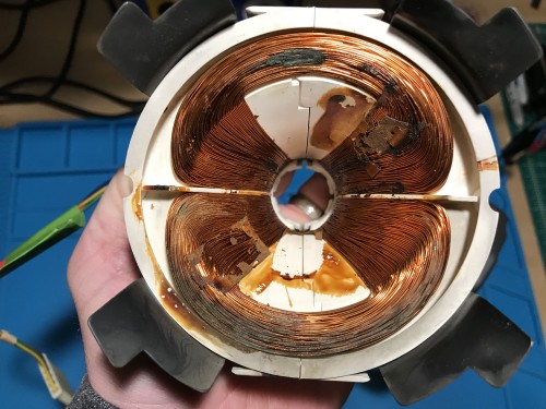

I fear that I already know the answer to this but here it goes anyway....
I'm sitting on 3 broken XM-1801 (Nintendo Red Tent) yokes right now! AHHHH! :(
I know these yokes are not the easiest to find so it seems like a shame that they are not being reproduced...or at least repaired.
I'd love to tackle this project of "rewinding" my own yoke but I'm afraid that all 3 of my broken ones have a defective interior winding. The interior winding seems like it would be the most difficult (impossible?) to repair.
Does anyone do this? Is it even possible?

How are you confirming that they are bad?
I'm validating this a couple of ways:
1. I have known working yokes that I can swap
2. The B+ voltage on my chassis is dropping to 75VDC with the bad yoke. (Should be 110VDC normally)
3. I am probing around the corroded portion of the yoke with my multi-meter on continuity and it's beeping. (short)
4. Visually seeing smoke rise up from one of the yokes when powered on. LOL
5. Yoke is producing erratic static visually and audibly on the CRT screen.
5. Another yoke was so corroded the copper wire literally broke free. (In a spot I couldn't repair it)
6. And another yoke produces an image but smells pretty bad after only being powered on for a few seconds. The image on the screen is massively out of convergence.
Interesting. The enamel they used on the wire must have been cheaper than other yokes, as magnet wire is usually pretty tough stuff. (Or something else in the cab/design is causing it to come off.)
I'd say you're probably SOL. Repairing them isn't going to be easy, especially if the enamel is as bad as you say, such that you can probe it with a DMM and get shorts. That means it's a massive failure/delamination of the enamel.
Bingo...I'm pretty sure they used shotty enameled wired in the factory on these yokes. I'm seeing post after post after post of burned up yokes with this monitor.

I had a bad K7000 yoke. It (and the game) were sitting somewhere and conveniently it seems some drywall fluid leak dripped into the cabinet air exhaust vent at the top of the cabinet. It dripped onto the yoke (and main chassis board). The acidic nature of the fluid caused the yoke winding to corrode and "short". (The chassis board had open copper traces). I ohmed the yoke wires out and found the shorted area ... tried to fix but was unsuccessful.
Interestign you should mention that because many people have a another theory as to why the yokes on these red tents are dying so often....it's becasue people set their drinks on top of the machine. The drink would inevitable spill, leaking corrosive fluid down on the monitor. The yoke would act as a "cup" catching all the fluid. Thus, sitting there heating up and chewing away at the enamel.
Typically a good/bad yoke is determined, as well, by the H/V impedances being in spec or not.
On 2 of the 3 bad yokes I have (as far as I can tell) when I ohm them out, they are within spec. So that kinda surprised me that they didn't work. But then again...they definitely had open traces so even if they ohm out...that's not a guarantee they will work. :(
sent a pm explaining how to repair it but i will post it here again for people in the future.
#1 find a donor yoke of similar inner coil inductance and of the same deflection angle
#2 separate the outer coils from your yoke and reuse them on the donor yoke (there are 2 common ferrite molds amongst all manufacturers for 90 degree yokes)
#3 OR replace the entire yoke with a compatible unit from a tv or monitor
luckily the inner yoke coils of most raster and vector yokes are compatible with each other but please test them first.
it is commonly the outer coils which differ so vastly
this is a reason why testing impedance is more important than testing resistance when it comes to an inductor.
if you were to short out only 1 single yoke winding in other words make 1 single shorted loop of wire your resistance will pretty much be the same . but it would throw the inductance way off since that single coil of wire is producing a current and is being directly shorted
