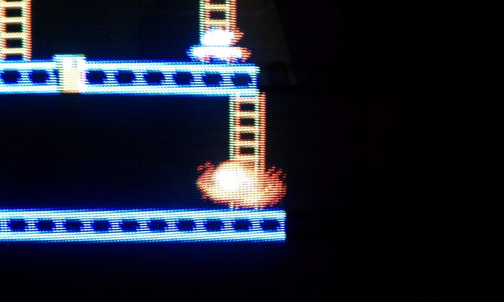

Ok so I turned up the B+ voltage pot(new) and the voltage stays the same 88 to 90v. I turned up the Brightness via flyback like you asked and the voltage drops down into the 70's. Doesn't go up at all.

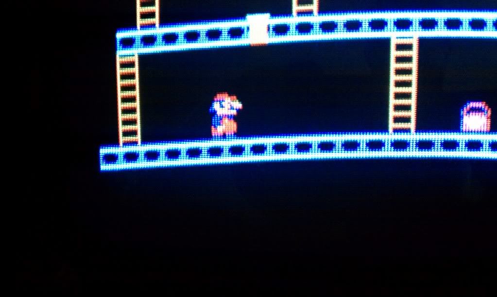

I installed a new switcher, and that cleaned up the screen a little, but not much. As the the screen still Flag waves and I've got what looks like interference lines running on the screen itself. That go one way, then stop and turn and go the other way, so it makes straight lines look squiggly.

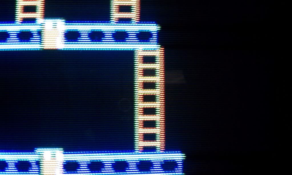

Also the left side of the screen kind of droops down, but the colors and lines look matched up(on the left side). But on the right side, it appears that the colors are mis-aligned. Look at pics for what I'm talking about.
And the screen still "Blooms" when the music is going or donkey kong bangs his chest. But I assume that is due to the Voltage being so low.

Those are on the right and the different colors dont line up. But they do line up on the left side though....but it dips on the left side...
Everything lines up perfect on the left, but it does droop down on lower left portion of the screen though..

Hello, your are missing B+ regulation which have symptoms of a low b+, high b+ and or the flag waving problem... I have seen the flag waver from a bad filter cap. However a bad filter cap is extremely rare... You should be able to fix your problem by replacing ic601, vr601 & D1090 transistor right next to ic601... If you still have a problem it's possible however rare to have a corrupt HOT (replace with 2sd869 or 2sd870). Then the next I would look cap legs migrated to another circuit while soldering in or you have a open trace / pad from handling the board... godo luck!.
