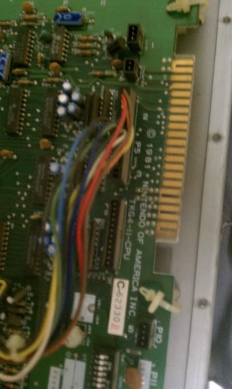

Alright guys, I've finally gotten my hands on a DK boardset (2 boards), and it came with a couple harnesses, but I literally have no idea what all I need in terms of wiring. I have a stripped DK cab that I will be restoring, have a monitor, cp, bezel marquee, the whole kit and caboodle, but what I dont have are the correct wires, can anyone tell me exactly what I need to bring this poor dk back to life? here are some pics of the board and the attached harnesses:
Thanks in advance for your help!
You've got power (x2) and control wiring there.
P5 (Main) is out to control panel, P3 and P10 (9-pin and 10-pin) are power to the CPU and VIDEO PCBs. You can power and play that board right now except that you won't be able to see it, hear it, or coin it up :D
You need the 6-pin white video cable (P7, TV) to hook it to a Sanyo, a 4-pin brown audio cable (P10) to connect to the sound amp, and a way to coin up. Either the 3-pin "COIN" cable (P3) going out to mechs, and/or the 5-pin "SERVICE" cable (P8) going to a service switch. Mike's carries the video and audio cables.
Alternately, you can buy and go the edge connector route, which will also probably require you to furnish coin door trimmings like the P3/P8.
