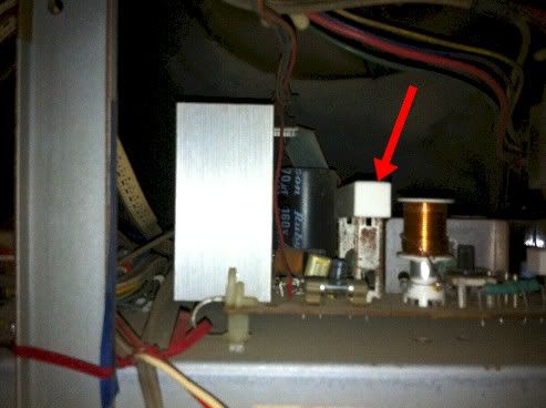

...but I do have a smell coming from the monitor/chassis area when the game is turned on. :( Again, I have no sign of video (no flicker or anything) and absolutely no sound. I have no idea what direction to go from here unless it's just find a whole replacement.

The audio amplifier in Nintendo games on the monitor chassis, and is powered by the monitor's power supply. So, if that's dead, you get no sound.
Sounds like you've got something blown. Check the 300ma fuse on the back of the chassis, as well as that big ceramic resistor. I'm going to guess that someone replaced that fuse with a larger one, and now the ceramic resistor is sitting there cooking. Just a hunch... seen it before...

The fuses were good and if this white thing in the pic (arrow pointing to it) is a resistor which I suspected, it gets VERY hot.
So, if the fuse is bigger than what is supposed to be there, I assume the correct one would blow. If so, do you know what might cause it to blow?
Yeah, that's the resistor I was talking about. It's probably what's producing the smell. It should not get that hot - if you leave it like that long enough, it'll crack apart from the heat.

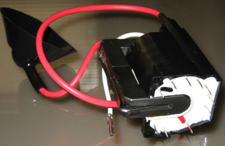

That fuse is supposed to be 300ma. See what it's actually marked as - it's probably much bigger. The correct 300ma fuse would have blown. That's the B+ power supply line. Chances are, you have a blown horizontal output transistor (HOT). Check to see if it's shorted. You may need a flyback - the blown HOT is usually a symptom of a failed flyback. Chad at ArcadeCup has replacements.
