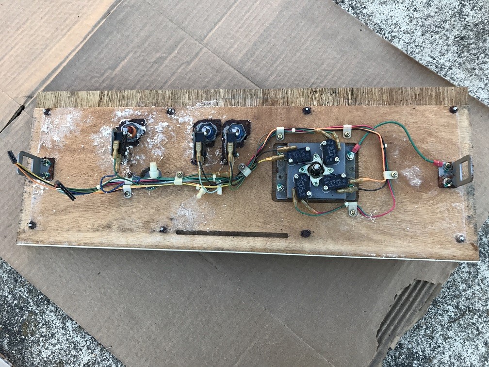

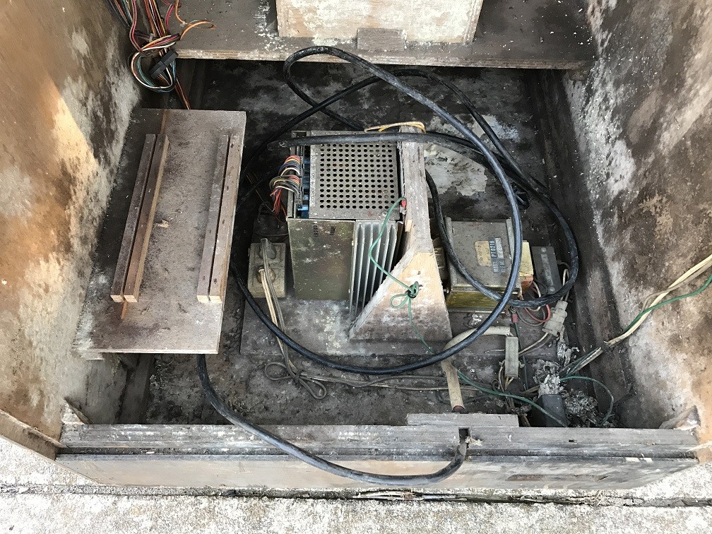

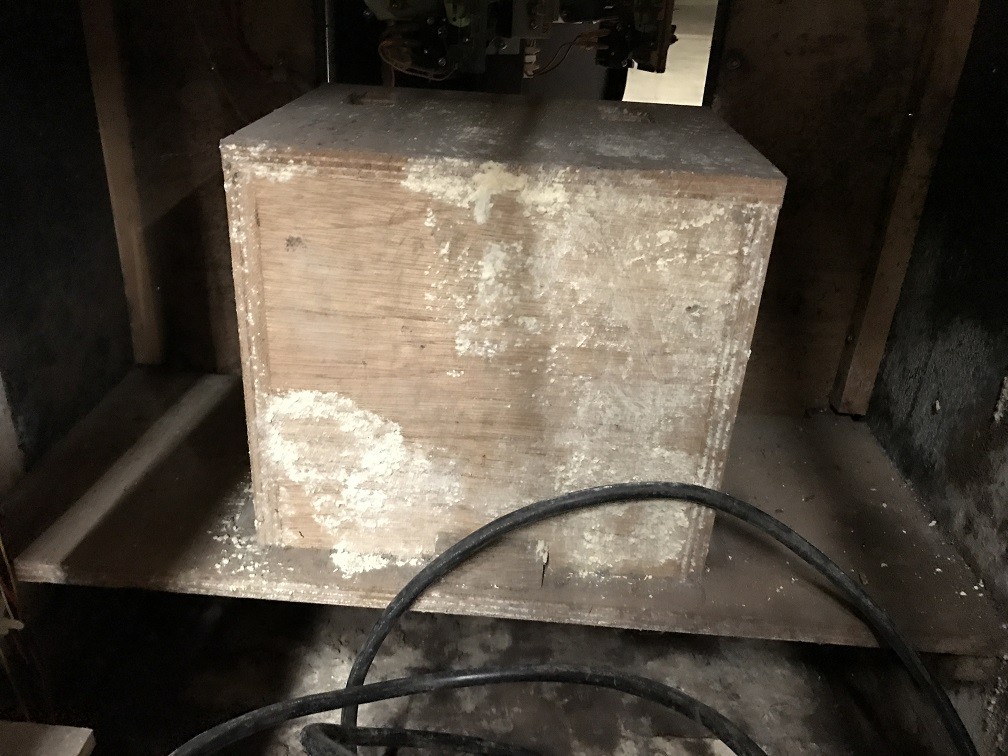

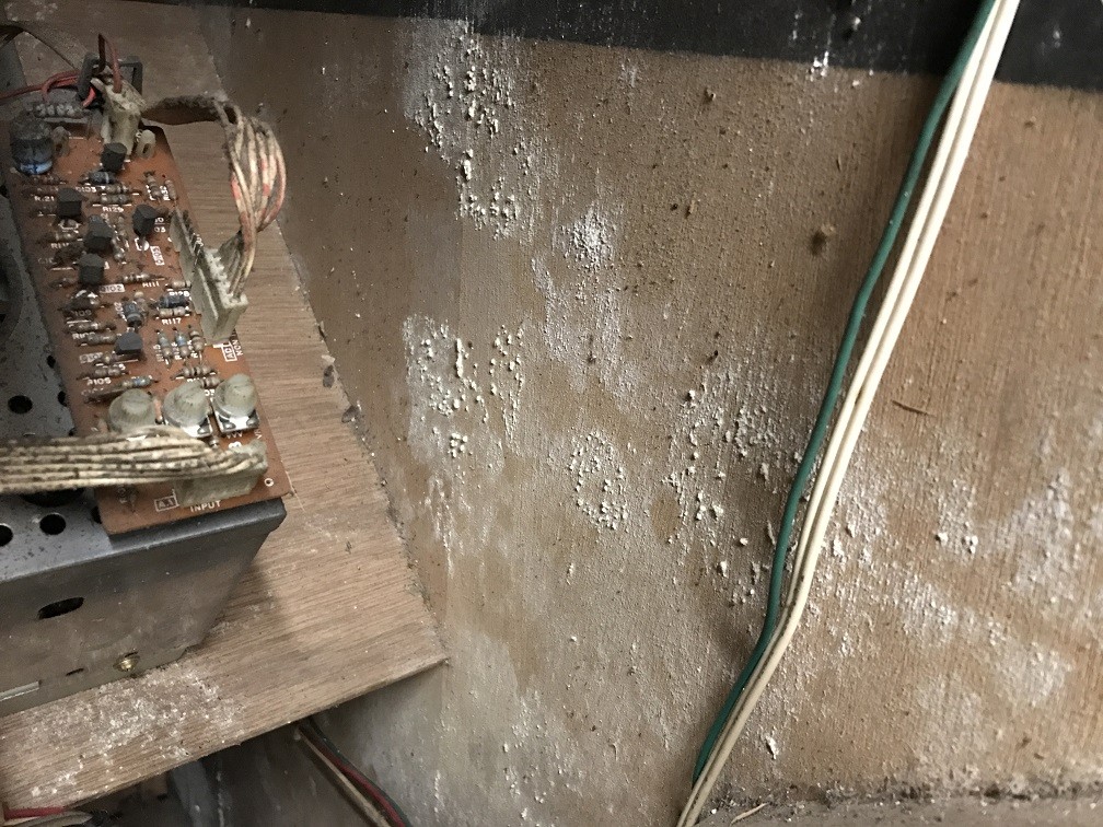

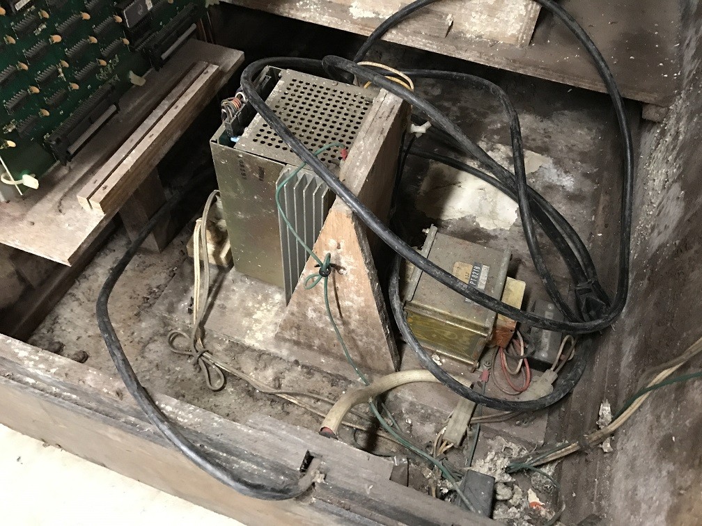

picked up a DK Jr cheap(ish) earlier today, but it is FULL of funk ... what i'm assuming is mold and the remnants of critters past.

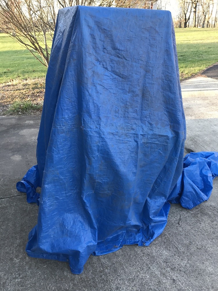

should i even keep this thing in the garage? is it even safe? i was gonna gut it (pull PCB, CRT, PS, harnesses, etc etc), put the guts in the garage (is that even ok?) and maybe cover the cabinet with a tarp outside for tonight.
the cabinet itself seems solid, but needs some hardcore hazmat treatment. where do i begin de-toxing this thing? i wanna bring it back from the dead and make it safe to be in a home again.
I found a little bit of mold once on my shed but it was in Arizona where everything is very dry. It depends on your area you may want to cover it with the clear plastic tarp so the sun can still hit it. If it's still cold where you're at you definitely going to need to clean it with pretty harsh chemicals. Unless you're going to call a professional you can start with some Ajax sponges and paint scrapers make sure that you have a painters drop underneath the game. That you can throw away after using it. And by God whatever you do don't bring it in the house. Make sure that you dress up I. some pretty covering clothes goggles, air mask. Don't just get the cheap painter's mask did something that allows for air Exchange. Otherwise you could be sick for two or three weeks.
For mine, moldy water logged cabinets get a commercial ozone machine while tarped for a few hours first. A few hours of Ozone will kill anything you should come across.

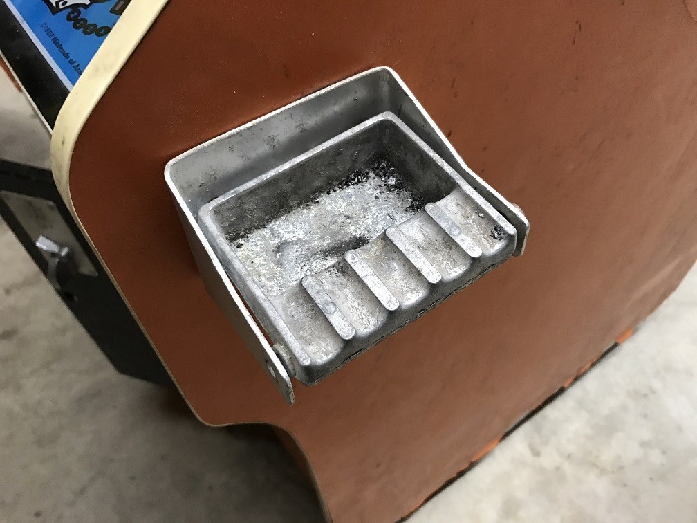

1. Remove the ashtray and trash that right away.
2. Remove all artwork (marquee, bezel and CP); clean those up and put aside.

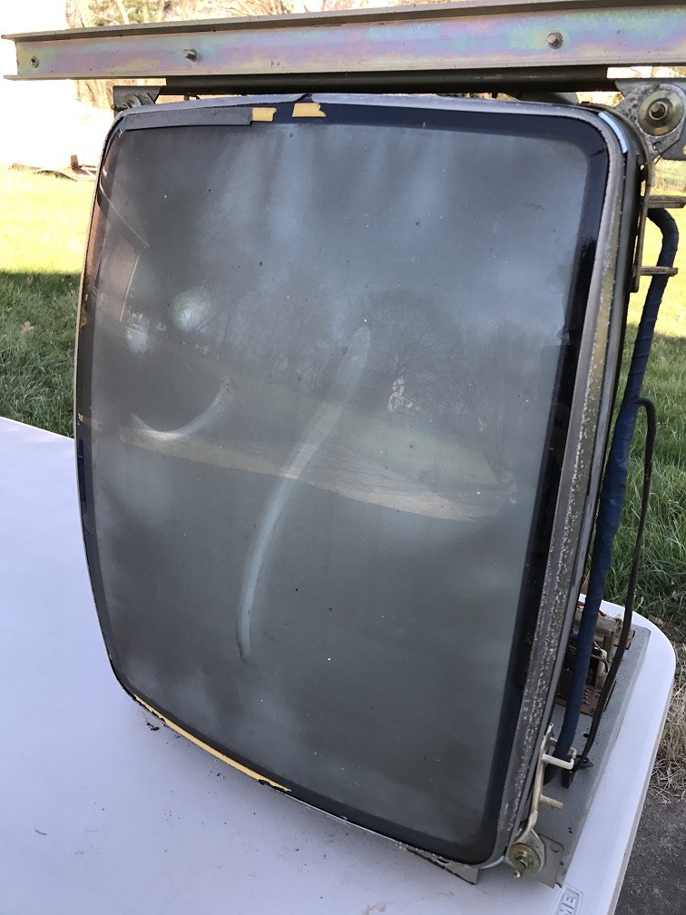

3. Remove monitor. Spray with Simple Green and hose it down. Put aside and let it dry for a week. LOL
4. Remove PCB(s). I'd spray and hose those too and put them aside.

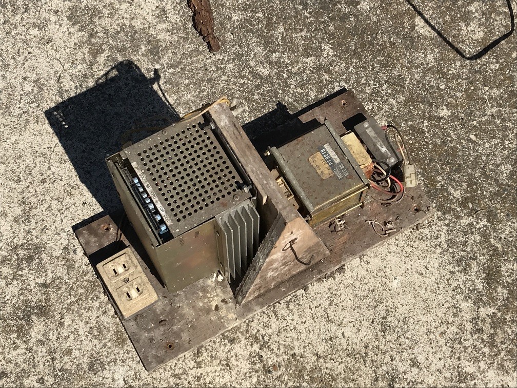

5. Remove the power. Ditto as above.
6. Put on the hazmat gear and clean/bleach the crap out of the cabinet inside and out. Might want to repeat this step several times.
7. If it was my cab, I might want to seal the interior wood or paint it. YMMV
I would be surprised if it doesn't clean up well. Most cabs can be revived from neglect.

Strip the cab....and spray bleach in that sucker...wipe...repeat several times...leaving the beach time to really soak into wood...as long as the cab isn't mdf or particle board the bleach won't hurt it and it will dry out eventually..I've seen way worse cabs exposed to mold, water, and god knows what else..just patience and time...
For your safety..wear a mask, goggles, and gloves..your skin, eyes, and respiratory system will thank you.
As someone who has tackled these types of cabs wayyyyy too many times:
- Usually mildew not mold.
- Shop vac works wonders
- Spraying compressed air gets rid of cacked on gunk.
Do these outside. Wear protection.

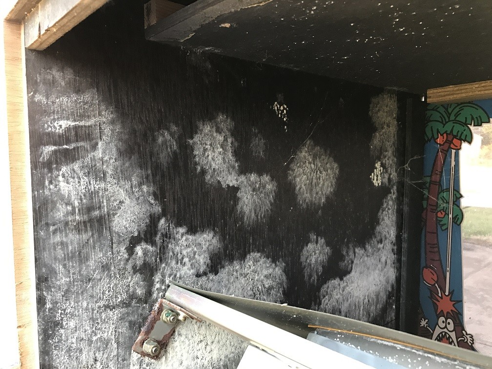

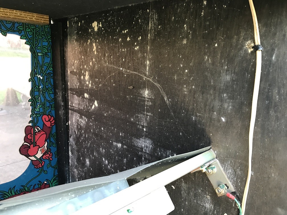

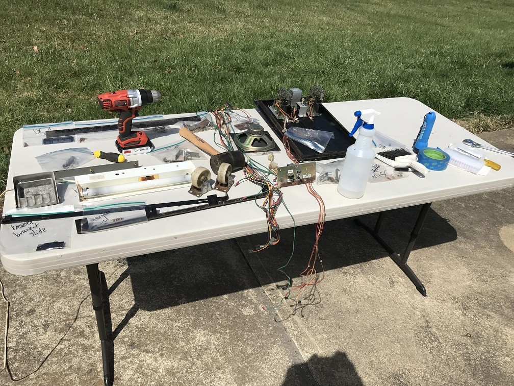

stripped it, gutted it, wiped it down inside and out, sprayed it down inside and out several times with a half water/half vinegar mix (was gonna do bleach, but read in several places that the bleach only ends up addressing surface nastiness).
everything is baking in the sun right now to commence stage 1 decontamination. i'll probably hit it several times more throughout the week with the vingear mix to realllllly make sure all the funk is KIA. do i need to use something stronger during this detox phase?
dead tired at this point though. will re-tarp the cabinet outside and move the guts into the garage tonight. will have to hose down the CRT and PCB, disassemble the power block and CP, etc etc later. i'm beat.
i'm guessing you gotta remove the rear exhaust grills at the back top of the cabinet and spray like crazy in there.

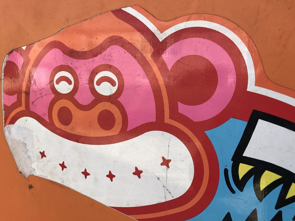

side-note ... i just put repro'd side art on my good DK Jr and noticed the side-art i applied has no orange border like the original in the pic :( oh well
