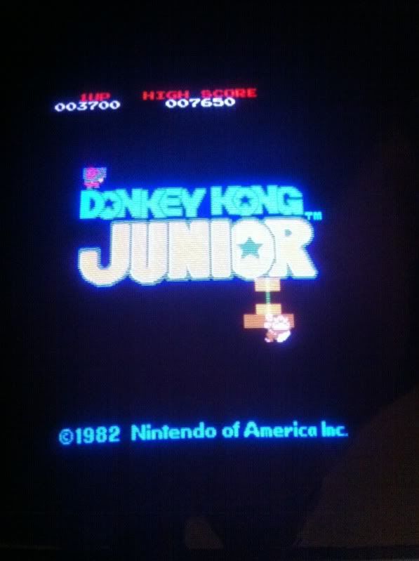

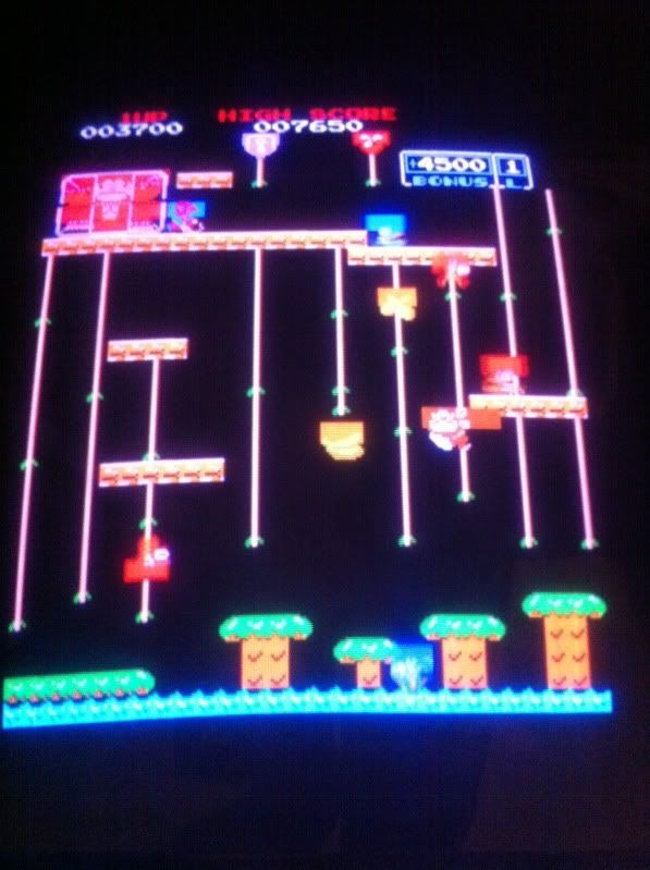

My DK Jr. started acting up with some block-type images above some objects. The game still plays fine though. Any suggestions on how to fix the issue?
looks like it is a bad 7c3 rom. I went thru the same issue a while back, if I can find the website, I will let you know
Its certainly a board issue. After verifying voltages I would pull and verify all the roms. Could be as simple as a bad rom, anything else and you will probably want to seek someone with nintendo board repair experience.
That is a rom issue in the 7X series Eprom on the video board. Have you tried pulling those roms and cleaning the legs. Push down on each rom with your finger maybe one came slightly loose.
