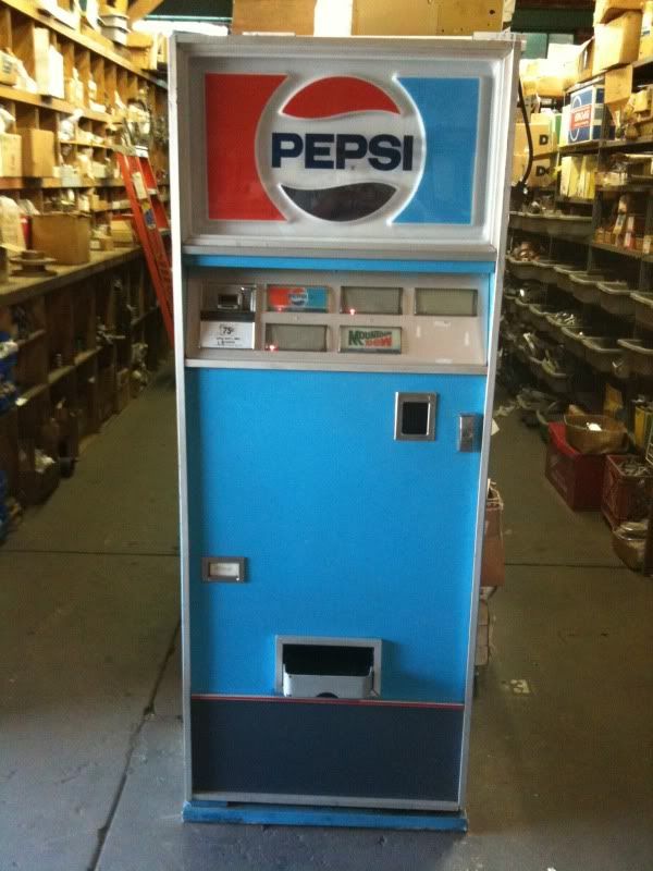

thanks. i had a guy from CNR vending come by last week and give it a once over. he said the coin mech i had was toast. he replaced it w/ one he had in his car for $50. works now. he showed me how to change the cost settings. but after looking at how much soda is, i am keeping it at .75
this unit is older then me, which might not be saying much. here is a pic;
Nice
wow, Nice good looking machine.
Freon i assume?
Not a bad unit.
their usualy pretty good
My machine is newer, takes the "new Freon"
and already had a leak, I have since had it patched and filled
Mine needs a motor.
nice thing it seems like parts are still pretty findable.
