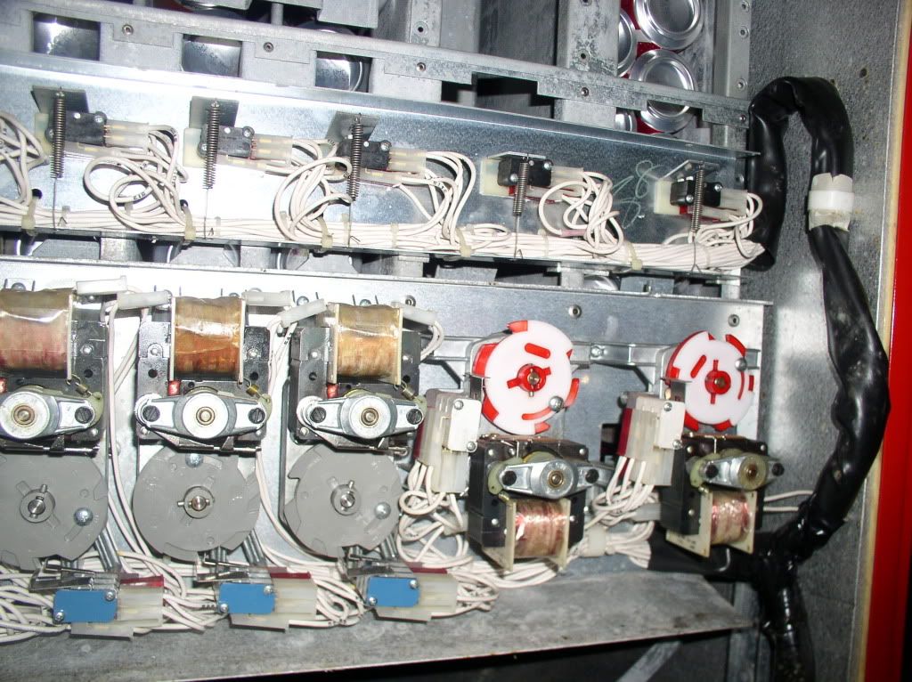

you need to check the motors first to make sure that they are all in sync. if the micro arm on 1 motor is out of place the machine will shut down. relays rarely fail i may see 1 bad relay every 75-100 machines.
oil your motors tap on the pivot arm a few times then cycle each motor.
also check continuity to each button if you have a wire loose or off it will stop also.
if in doubt post a pic of the bank of motors.
also if you reversed a wire on a motor (would be one of the lower 3 on the motor) it will not allow a signal through either. i had one i fucked with for half a day simple fix once i found it haha.

just a quick look all your cans are all in backwards
colum 5 motor switch is not pluged in check all of them and make sure thay are in the connector not just in the plastic

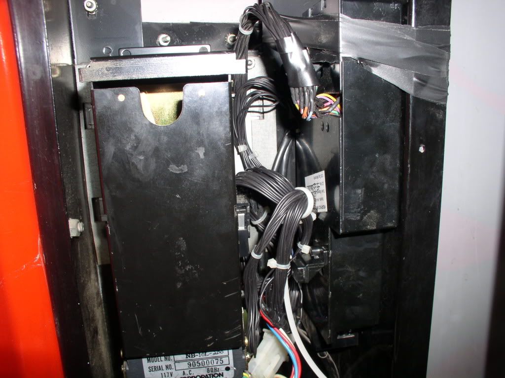

hello, i have also just purchased an old dixie-narco dncb 440cc 252-7. its old and has some gremlins in it unfortunately. i have no experience with vending machines however i am ready to conquer these problems that are presented to me.
here is an internet picture of the machine i have:
http://dfwvendingsolutions.com/images/178_Dixie-Narco-Coke.jpg
there are 2 things that i am having trouble with
1. the bill acceptor doesn't work, it doesn't pull bills inside it and the whole bill acceptor seems to be lacking power in general. i'm not sure if it is a power issue or a bad censer or something completely different. i am aware that the bill acceptor can be replaced but i would like that to be a last resort.
2. i can't seem to be able to program the prices for different drinks. this seems really easy and everything i have read makes it sound rather simple, however i am still having no luck. i have read this:
http://www.vendingadvantage.com/manualspdf/dixie/SIID-2-Button-Manual.pdf
the manual is helpful but i can't seem to find the SIID. there is a black box above the coin dispenser and next to the bill acceptor that does resemble a computer's motherboard like the manual described however i have looked up and down it thoroughly and i can't find the button that the manual seems to be talking about. so i guess this is a simple question, where is the SIID?
anyway i would greatly appreciate any help or advice you could throw my way.
thanks, krimit

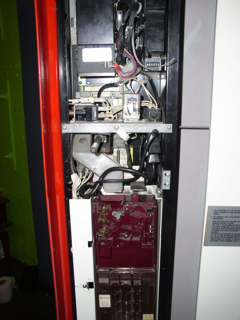

here are some pictures
here are some pictures of my machine Narcoholic. you might find them useful.
and the black box i am talking about is in the top right of the first 2 pictures other 3 are of my machines motors and wiring, which all works perfectly. and the last one is the machine itself.

1st thind on the doller val. is to check all the connections, make sure you have clean tubes on your changer ,make sure it has plenty of change ,
2 the siid is the computer in the machine the one your looking for is a big silver box should be the last thing on the top of the door with lots of wires running to it . in the 5th pic the 2nd colum from the right check the plug on the motor switch it dont look like its connected Ron
