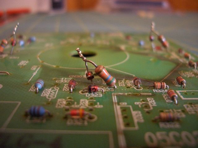

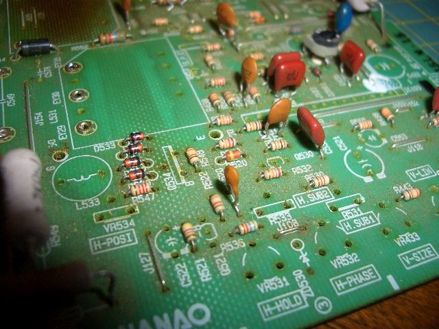

Some of you may already be aware, I have been on a mission to tear one of these chassis apart, to have more accurate information about them. I am almost finished with removing and documenting, just about every dang piece on one of these chassis. I am down to just the tiny resistors and diodes, and would like to ask for some assistance. If there is a member here, that is a diode guru, and would like to help me finish documenting these, I would appreciate it. Even if it's pointing me in the direction I need to go, to educate myself more regarding these tiny little bastards, I'll take it.
For the record, this chassis has about 40% lifted/removed pads, and some other damage. I felt this was a great candidate for dissecting and documenting.
Pics previous to my latest stopping point, connectors/poly & disc caps/misc removed, waiting to document these tiny diodes and resistors:
Making progress, have roughly 50-60 resistors to still document, but it's getting there. And in the end, will help rewrite the schems for this chassis.

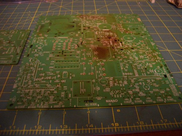

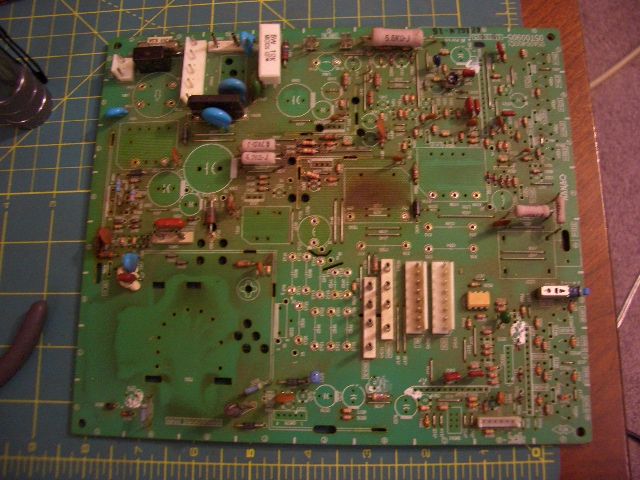

WARNING!!!! The images below are NSFW, do NOT view this on a work computer.
Are you guys ready for some nakedness? Isn't she pretty? Yep, she's a little dirty, but we like that.......... :)
Bare Main PCB:

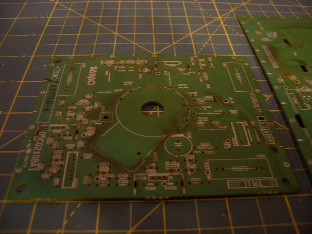

Neck Board PCB:
And 15 pages of documentation(my Holy Grail at the moment, yep, used the word "grail"), parts listing and positions, with a couple of detailed notes. Also, I found two items populated on the board, that's not even on the schematic. Verified these parts, with two other chassis, from completely different ends of the US.
And these little bastards(diode and resistor tied) were fun to document, there's three of them on the neck board:
Slowly and surely, bits and pieces are getting done :)

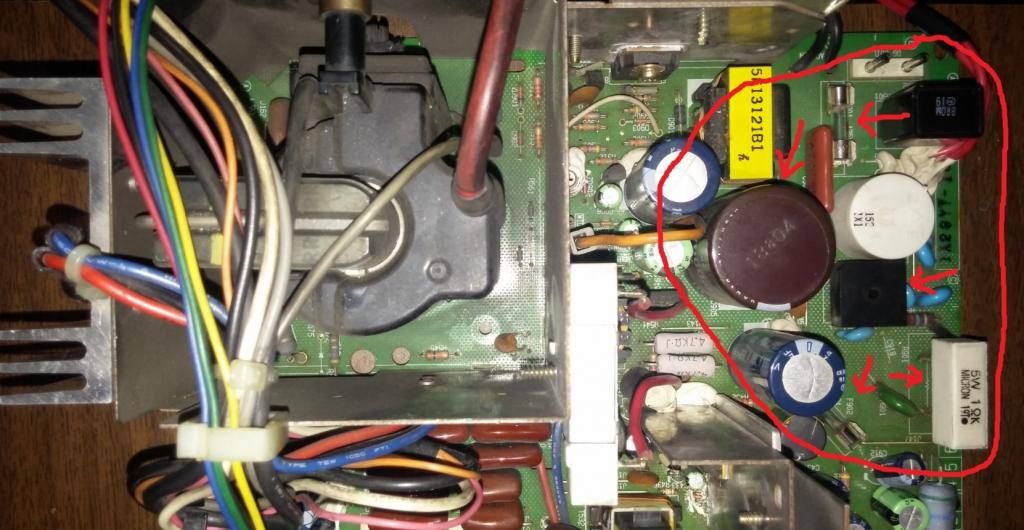

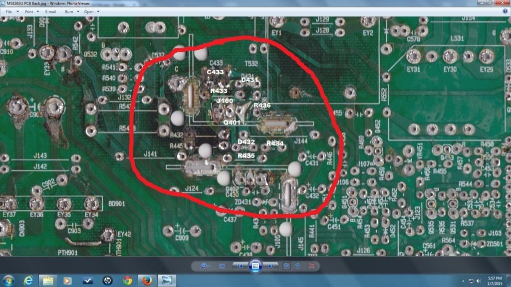

Awesome job man, I need to fix two of these so hopefully we can document all the trouble spots too. The burn marks in your photo are revealing, thinking I should double check stuff in those dark areas to try and bullet proof the chasis.
That burned area towards the middle of the chassis, I have seen the pads and traces in that area, being prone to lifting or destruction. Use caution when handling that part of the chassis, the constant heat weakens that area, and the weight of the heat sinks likes to push around the pads underneath. It starts with the pads for the heat sinks, and likes to start tearing away from there. I've got a few different pics in other threads, I'll bring them into this one, when I'm not on an IPad.

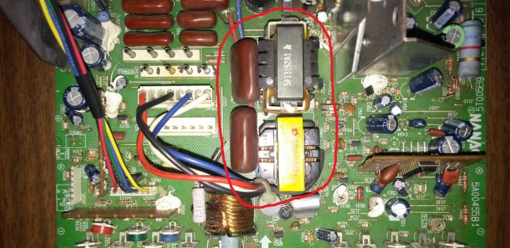

Bringing these pics in, from another thread I posted in, trying to centralize more of the info for the MS8-26SU. Below, show differences from a MS8-26A chassis, to a MS8-26SU chassis.
I've noted the chassis, to show the differences by a visual inspection.
MS8-26SU:
MS8-26A:
Could you please post the values for the following resistors?
R432
R434
R435
R445
Mine are burnt and cracking, thanks.
