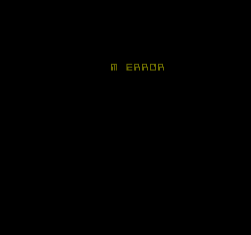

OK, removed the chip, soldered in a socket. replaced with new 74ls244 at position F2 on the SSIO board and now I get "M error". Either in test or normal mode, that is what it boots to. I can not find anywhere what that means. Anyone know what M Error is?

and there is no other text besides "M Error"? When you take the board off are there any missing text etc on the screen?
The reason I say this...is that screen shot I displayed... doesn't actually exist. (I had to create it, to see if that error looked the same of some letters missing from another error message)
The only 3 messages with the word "error" in the disassembly are
* ROM Error (from which the shot I got was taken)
* RAM Error
* Long Error about the IO board
The thing is both RAM and ROM match the pattern
"M Error" assuming the left two letters were missing.
Now that's entirely possible, if the video RAM that makes up those tiles are bad, it could cause a few columns of text to be blank. That also might explain why your game is resetting with the SSIO board off.. (assuming the RAM error is more widespread than just one chip (buffer issue?) but if that's the case I'd think without the SSIO board you'd still be missing those columns of text and probably have other video or resetting issues.

Thanks again for responding Brian. There is a blue square before "M Error". That is the only difference from your link. I did only remove the top ssio board so only those cables were removed. I double checked to make sure the cables were reconnected properly. I can try disconnecting the ssio board and see if there is missing text in the same location as the missing letters. Not sure if it will be in the same place since the picture inverts when I do that. Here is a picture of the error:
