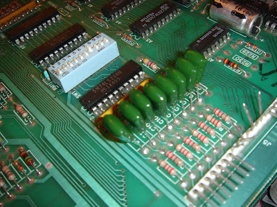

Also, the original PCB has had some work.. and there is a capacitor (forgive me if I'm calling it the wrong thing) that is not attached... see pic below. It is located in the CP26 part of the board.. can anyone research what this area of the board would be responsible for? My other PCB appeared to have the capacitor at CP26 intact, and I didn't hear the deflect working when I hit it. Here's the pic of the detached capacitor:

Holy tall capaicitor Batman! What part of "through hole mount" did the PO not understand?
I would reattach that cap leg, actually I would un solder all those caps and mount them down low next to the board as they should be. However, there is a good chance that is not your problem with the deflect. Sorry I dont have a better answer.

If you're concerned about the caps, check the PCB diagram (p38) and find out exactly what is supposed to go in those spots. Something was most likely missing or bad and replaced. I had an entire row of the .1mf caps missing from my board, and replaced them with the larger green ones too:
