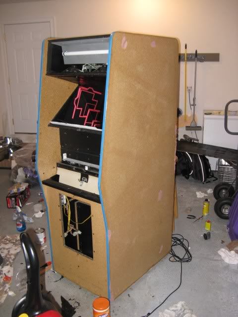

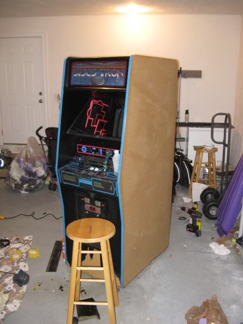

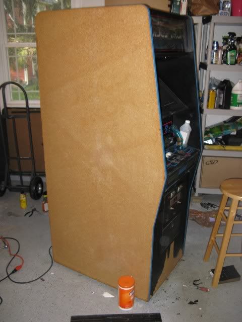

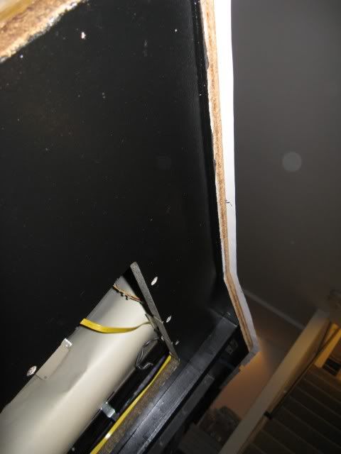

The side art wasn't bad, but it had a couple of dings and there was some minor swelling on the bottom and a few chipped out parts. Time to strip it off with a heat gun:
This was the easiest side art I've done so far. The heat gun got it started and then it just pulled off quickly as the adhesive was pretty old. It took 20 minutes of working slowly with the heat gun to do half of one side before I figured this out. It took 10 minutes to finish off the rest. I was going to leave the black alone, but upon closer inspection, the heat over the years had warped it in some areas, so off that came.

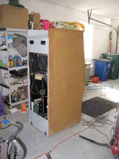

I Bondoed all of the sides and corners and sanded that all down…God I hate doing that. I also stripped and primered and painted x2 the back and front, and sanded and polyurethaned the sides x2.

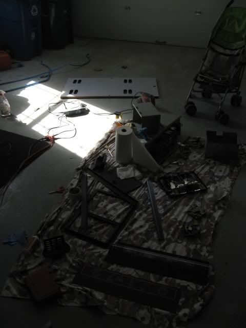

I removed the coin doors and coin boxes, sanded and repainted them only as the powdercoating was pretty good. I found an MCR II instruction manual to go with the printed and bound EDOT/DOT manual I had made…I also found a cool little sheet of paper that looked like an arcade owner had made for an op with a list of games and what wasn't working on them. Fun little read…
I removed all of the cardboard inserts and mattes and spray painted them flat black. I also cleaned all of the glass and inserts (DOT/EDOT owners all know how fun it is removing all of those), wires and power supply. The ballasts of all of my lights seemed pretty good, but I replaced all of the starters and bulbs. It was interesting to see the development changes from 1982 to 1983 after having restored my Tron:

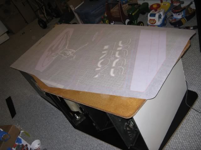

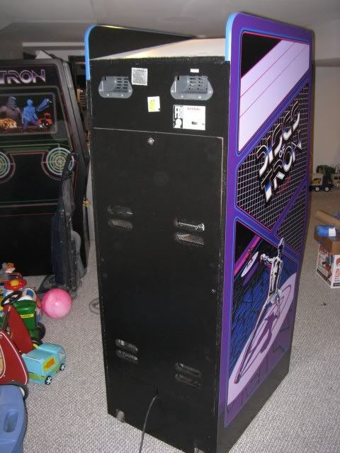

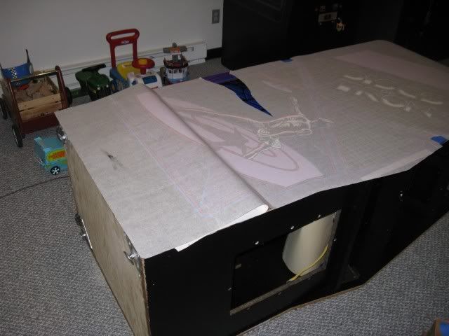

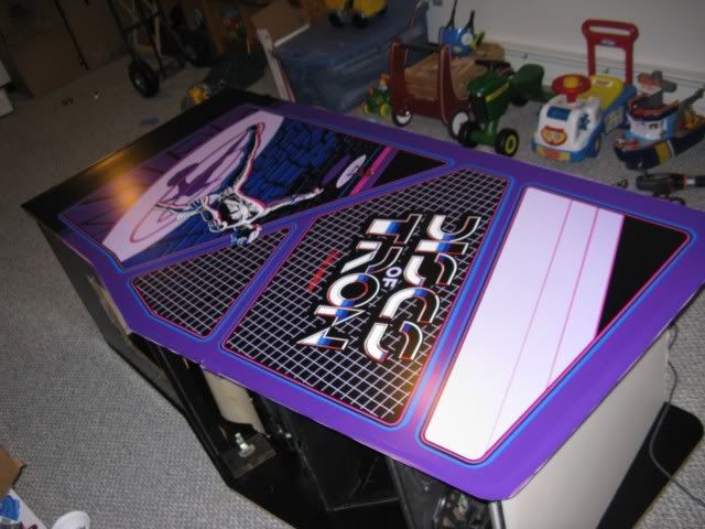

Then came the fun transfer from garage to basement with a hand truck with a flat wheel…still have the marks on my arms from that one. My side art from Rich came in record time…no surprise there. This was my first time applying full side art…Tron only had the one piece and 720 was full vinyl, but in smaller pieces. I had considered the wet method, but didn't trust that my polyurethane would be water proof enough. After reading a few threads, I went with laying it on its side. Rich's notes state that there's about a 1" overhang/bleed on the art. I ended up cutting it all to shape to make it easier to manage. It also allowed me to line it up easier…I used the front "point" and "indent" as my starting points, and then checked for equal overhang all around:
In order to keep it stable, I cut in two little notches on each side of the side art to the edge of the machine, and taped it down:
I then worked from the middle down:
After a few inches, I would remove some of the masking to ensure there were no bubbles:
This was by far the easiest side art/vinyl I have yet to install. It's tough and durable, doesn't stretch, and the air channels work very well. Not nearly as difficult as the 720 vinyl or Tron side art.

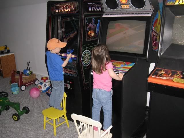

For those of you that care, that's the Disney Tron statue from years ago…pretty cool for Tron fans!

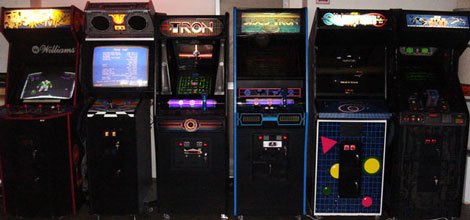

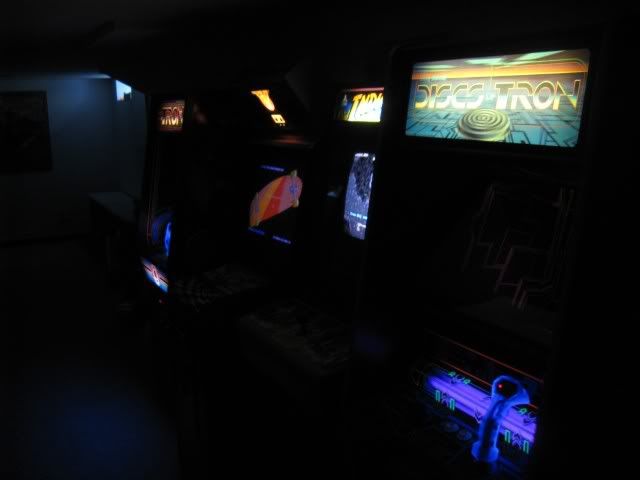

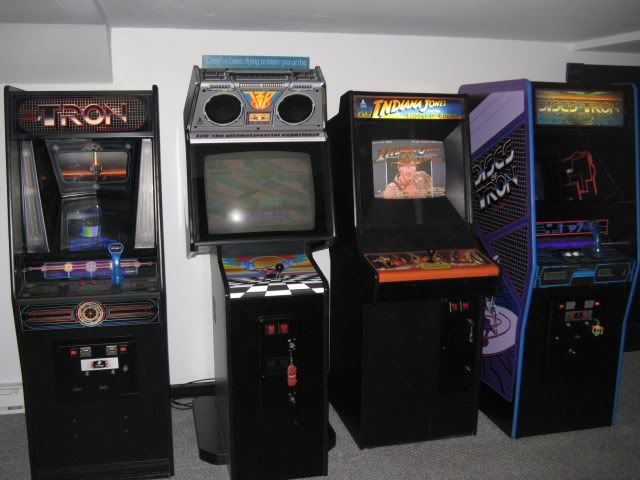

And into the lineup it goes…yeah, I can actually call it a "lineup" now!

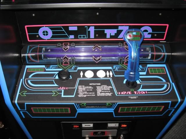

Now, I obviously have issues with the CPO and the front light housing (it's faded and chipped). However, have no fear…eventually Rich will have those completed. I just couldn't wait until then to post this thread, as that might be 6 weeks, 6 months, or 1 year. My joystick is also pretty good, but I'll be replacing that, the insert, and white buttons when I do the CPO. Maybe some of you can express some interest so he bumps it up on his priority list? :) I also wouldn't mind replacing the red button…anyone know where to get one? There's some fluttering of the screen from time to time, but I was on a 2 week deadline for my son's birthday party today, so I chose form over function on my list of priorities.

So I have to ask the dumb question: Why aren't your Trons side-by-side?? :D
Anyway, excellent job. When you pick up your Star Wars our game-rooms will be almost identical.
Rich---awesome news on the CPOs! Seriously though, all of the "hinting" to do them is tongue-in-cheek...you've got other projects, so whenever man...
Jeff--I remember seeing your setup and seeing all of the similarities...I know of a few other members who happen to have 720, Tron, DOT, and SW...don't know what it is about those games, but they all seem to find themselved together. As for the lineup...I'd like to have them together, but by putting the 720 in there, you can see the sideart of Tron a little better. It's all about trying to show off the work I put into them. WAAAYYY down the road in 5 years or so when my kids are older, my entire basement is going to be wall-to-wall displays of my Star Wars, Indiana Jones, and Tron Collections. Ideally, each section will have the associated game in the middle of them with toys, posters, costumes, and collectibles around them.

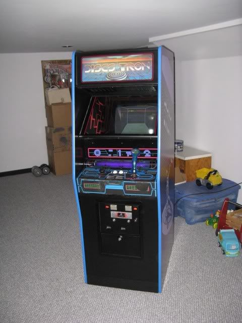

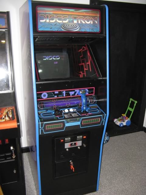

Update:

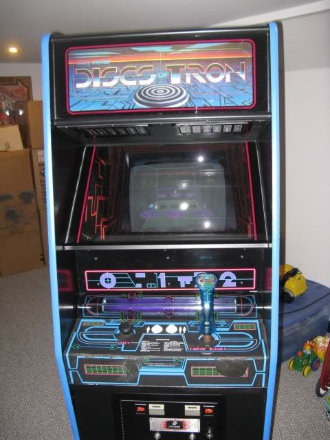

Pics with the new CPO, repainted joystick, new GGG joystick cover, new insert and polished button and new white buttons. Also added a Squawk and Talk for EDOT sounds, repainted the coin door and replaced the Midway Coin Door plate. Now all I need in the light cover (which has been ordered) and this is 100% done!
Before:
After:
